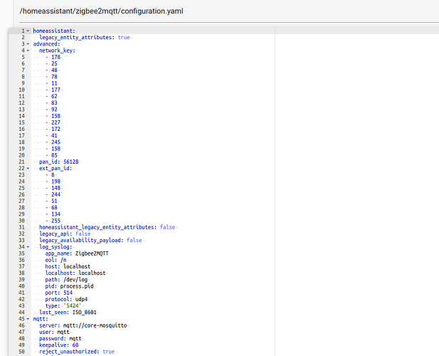

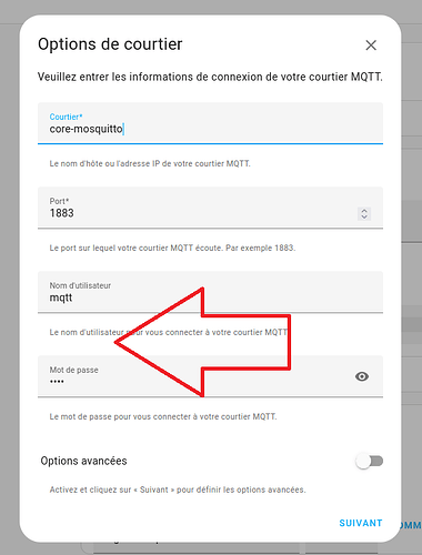

Zigbee2mqtt ne remontepas les devices dans HA

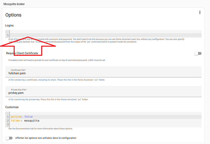

Log mosquitto
cont-init: info: running /etc/cont-init.d/mosquitto.sh
[18:24:49] INFO: Certificates found: SSL is available
cont-init: info: /etc/cont-init.d/mosquitto.sh exited 0
cont-init: info: running /etc/cont-init.d/nginx.sh
cont-init: info: /etc/cont-init.d/nginx.sh exited 0
services-up: info: copying legacy longrun mosquitto (no readiness notification)
services-up: info: copying legacy longrun nginx (no readiness notification)
[18:24:51] INFO: Starting NGINX for authentication handling...
[18:24:51] INFO: Starting mosquitto MQTT broker...
2024-02-07 18:24:51: Warning: Mosquitto should not be run as root/administrator.
2024-02-07 18:24:51: mosquitto version 2.0.18 starting
2024-02-07 18:24:51: Config loaded from /etc/mosquitto/mosquitto.conf.
2024-02-07 18:24:51: Loading plugin: /usr/share/mosquitto/go-auth.so
2024-02-07 18:24:51:  ├── Username/password checking enabled.
2024-02-07 18:24:51:  ├── TLS-PSK checking enabled.
2024-02-07 18:24:51:  └── Extended authentication not enabled.
2024-02-07 18:24:51: Opening ipv4 listen socket on port 1883.
2024-02-07 18:24:51: Opening ipv6 listen socket on port 1883.
2024-02-07 18:24:51: Opening websockets listen socket on port 1884.
2024-02-07 18:24:51: Opening ipv4 listen socket on port 8883.
2024-02-07 18:24:51: Opening ipv6 listen socket on port 8883.
2024-02-07 18:24:51: Opening websockets listen socket on port 8884.
2024-02-07 18:24:51: mosquitto version 2.0.18 running
2024-02-07 18:24:52: New connection from 127.0.0.1:34068 on port 1883.
2024-02-07 18:24:52: Client <unknown> disconnected due to protocol error.
[18:24:55] INFO: Successfully send discovery information to Home Assistant.
[18:24:57] INFO: Successfully send service information to the Supervisor.
2024-02-07 18:25:08: New connection from 192.168.1.17:63600 on port 1883.
2024-02-07 18:25:08: New client connected from 192.168.1.17:63600 as DVES_04F385 (p2, c1, k30, u'MonMqtt').
2024-02-07 18:25:08: New connection from 192.168.1.15:61907 on port 1883.
2024-02-07 18:25:08: New client connected from 192.168.1.15:61907 as PowR2_Chauffage (p2, c1, k30, u'MonMqtt').
2024-02-07 18:25:09: New connection from 192.168.1.22:53746 on port 1883.
2024-02-07 18:25:09: New client connected from 192.168.1.22:53746 as ESP-Easy-1_18_18_33 (p2, c0, k10, u'MonMqtt').
2024-02-07 18:25:10: New connection from 192.168.1.18:54826 on port 1883.
2024-02-07 18:25:10: New client connected from 192.168.1.18:54826 as ESP-Easy-2_13_13_37 (p2, c1, k10, u'MonMqtt').
2024-02-07 18:25:31: New connection from 192.168.1.74:17596 on port 1883.
2024-02-07 18:25:31: New client connected from 192.168.1.74:17596 as shelly1-8CAAB561BC0F (p2, c1, k60, u'MonMqtt').
2024-02-07 18:25:31: Outgoing messages are being dropped for client mymqtt-15039510907073.
2024-02-07 18:25:31: Outgoing messages are being dropped for client mymqtt-8115593892057.
2024-02-07 18:25:31: Outgoing messages are being dropped for client mymqtt-198590257840647.
2024-02-07 18:25:31: Outgoing messages are being dropped for client mymqtt-200075225077216.
2024-02-07 18:25:31: Outgoing messages are being dropped for client mymqtt-73963986910376.
2024-02-07 18:25:31: Outgoing messages are being dropped for client mymqtt-13266227506863.
2024-02-07 18:25:31: Outgoing messages are being dropped for client mymqtt-45942095611794.
2024-02-07 18:25:31: Outgoing messages are being dropped for client mymqtt-5020873443655.
2024-02-07 18:25:53: New connection from 172.30.32.1:44689 on port 1883.
2024-02-07 18:25:53: New client connected from 172.30.32.1:44689 as 03e4629iDEpIMuTm3TXAxn (p2, c1, k60, u'mqtt').
2024-02-07 18:26:41: New connection from 172.30.33.9:42192 on port 1883.
2024-02-07 18:26:41: New client connected from 172.30.33.9:42192 as mqttjs_347a2a4a (p2, c1, k60, u'mqtt').
2024-02-07 18:28:46: New connection from 172.30.32.2:56126 on port 1883.
2024-02-07 18:28:46: Client <unknown> closed its connection.
2024-02-07 18:30:46: New connection from 172.30.32.2:44202 on port 1883.
2024-02-07 18:30:46: Client <unknown> closed its connection.

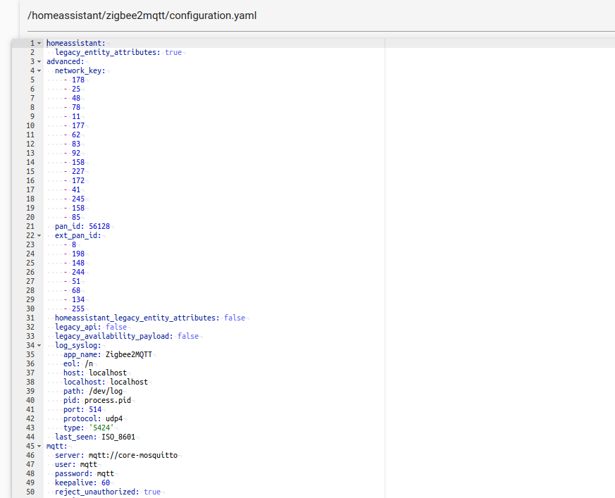

Log zigbee2mqtt
Zigbee2MQTT:info  2024-02-07 18:28:48: MQTT publish: topic 'zigbee2mqtt/plug_orange', payload '{"child_lock":"UNLOCK","current":0,"energy":0,"indicator_mode":"off/on","last_seen":"2024-02-07T17:28:40.780Z","linkquality":150,"power":0,"power_outage_memory":"restore","state":"OFF","update":{"installed_version":192,"latest_version":192,"state":"idle"},"update_available":null,"voltage":231}'
Zigbee2MQTT:info  2024-02-07 18:28:57: MQTT publish: topic 'zigbee2mqtt/plug_orange', payload '{"child_lock":"UNLOCK","current":0,"energy":0,"indicator_mode":"off/on","last_seen":"2024-02-07T17:28:57.196Z","linkquality":144,"power":0,"power_outage_memory":"restore","state":"OFF","update":{"installed_version":192,"latest_version":192,"state":"idle"},"update_available":null,"voltage":231}'
Zigbee2MQTT:info  2024-02-07 18:28:57: MQTT publish: topic 'zigbee2mqtt/plug_orange', payload '{"child_lock":"UNLOCK","current":0,"energy":0,"indicator_mode":"off/on","last_seen":"2024-02-07T17:28:57.593Z","linkquality":150,"power":0,"power_outage_memory":"restore","state":"OFF","update":{"installed_version":192,"latest_version":192,"state":"idle"},"update_available":null,"voltage":231}'
Zigbee2MQTT:info  2024-02-07 18:28:57: MQTT publish: topic 'zigbee2mqtt/plug_orange', payload '{"child_lock":"UNLOCK","current":0,"energy":0,"indicator_mode":"off/on","last_seen":"2024-02-07T17:28:57.789Z","linkquality":150,"power":0,"power_outage_memory":"restore","state":"OFF","update":{"installed_version":192,"latest_version":192,"state":"idle"},"update_available":null,"voltage":231}'
Zigbee2MQTT:info  2024-02-07 18:28:57: MQTT publish: topic 'zigbee2mqtt/plug_orange', payload '{"child_lock":"UNLOCK","current":0,"energy":0,"indicator_mode":"off/on","last_seen":"2024-02-07T17:28:57.985Z","linkquality":153,"power":0,"power_outage_memory":"restore","state":"OFF","update":{"installed_version":192,"latest_version":192,"state":"idle"},"update_available":null,"voltage":231}'
Zigbee2MQTT:info  2024-02-07 18:28:58: MQTT publish: topic 'zigbee2mqtt/plug_orange', payload '{"child_lock":"UNLOCK","current":0,"energy":0,"indicator_mode":"off/on","last_seen":"2024-02-07T17:28:58.185Z","linkquality":150,"power":0,"power_outage_memory":"restore","state":"OFF","update":{"installed_version":192,"latest_version":192,"state":"idle"},"update_available":null,"voltage":231}'
Zigbee2MQTT:info  2024-02-07 18:28:58: MQTT publish: topic 'zigbee2mqtt/plug_orange', payload '{"child_lock":"UNLOCK","current":0,"energy":0,"indicator_mode":"off/on","last_seen":"2024-02-07T17:28:58.387Z","linkquality":150,"power":0,"power_outage_memory":"restore","state":"OFF","update":{"installed_version":192,"latest_version":192,"state":"idle"},"update_available":null,"voltage":231}'
Zigbee2MQTT:info  2024-02-07 18:28:58: MQTT publish: topic 'zigbee2mqtt/plug_orange', payload '{"child_lock":"UNLOCK","current":0,"energy":0,"indicator_mode":"off/on","last_seen":"2024-02-07T17:28:58.587Z","linkquality":150,"power":0,"power_outage_memory":"restore","state":"OFF","update":{"installed_version":192,"latest_version":192,"state":"idle"},"update_available":null,"voltage":231}'
Zigbee2MQTT:info  2024-02-07 18:28:58: MQTT publish: topic 'zigbee2mqtt/plug_orange', payload '{"child_lock":"UNLOCK","current":0,"energy":0,"indicator_mode":"off/on","last_seen":"2024-02-07T17:28:58.788Z","linkquality":153,"power":0,"power_outage_memory":"restore","state":"OFF","update":{"installed_version":192,"latest_version":192,"state":"idle"},"update_available":null,"voltage":231}'
Zigbee2MQTT:info  2024-02-07 18:28:58: MQTT publish: topic 'zigbee2mqtt/plug_orange', payload '{"child_lock":"UNLOCK","current":0,"energy":0,"indicator_mode":"off/on","last_seen":"2024-02-07T17:28:58.989Z","linkquality":150,"power":0,"power_outage_memory":"restore","state":"OFF","update":{"installed_version":192,"latest_version":192,"state":"idle"},"update_available":null,"voltage":231}'
Zigbee2MQTT:info  2024-02-07 18:28:59: MQTT publish: topic 'zigbee2mqtt/plug_orange', payload '{"child_lock":"UNLOCK","current":0,"energy":0,"indicator_mode":"off/on","last_seen":"2024-02-07T17:28:59.189Z","linkquality":153,"power":0,"power_outage_memory":"restore","state":"OFF","update":{"installed_version":192,"latest_version":192,"state":"idle"},"update_available":null,"voltage":231}'
Zigbee2MQTT:info  2024-02-07 18:28:59: MQTT publish: topic 'zigbee2mqtt/plug_orange', payload '{"child_lock":"UNLOCK","current":0,"energy":0,"indicator_mode":"off/on","last_seen":"2024-02-07T17:28:59.389Z","linkquality":150,"power":0,"power_outage_memory":"restore","state":"OFF","update":{"installed_version":192,"latest_version":192,"state":"idle"},"update_available":null,"voltage":231}'
Zigbee2MQTT:info  2024-02-07 18:28:59: MQTT publish: topic 'zigbee2mqtt/plug_orange', payload '{"child_lock":"UNLOCK","current":0,"energy":0,"indicator_mode":"off/on","last_seen":"2024-02-07T17:28:59.591Z","linkquality":153,"power":0,"power_outage_memory":"restore","state":"OFF","update":{"installed_version":192,"latest_version":192,"state":"idle"},"update_available":null,"voltage":231}'
Zigbee2MQTT:info  2024-02-07 18:28:59: MQTT publish: topic 'zigbee2mqtt/plug_orange', payload '{"child_lock":"UNLOCK","current":0,"energy":0,"indicator_mode":"off/on","last_seen":"2024-02-07T17:28:59.796Z","linkquality":150,"power":0,"power_outage_memory":"restore","state":"OFF","update":{"installed_version":192,"latest_version":192,"state":"idle"},"update_available":null,"voltage":231}'
Zigbee2MQTT:info  2024-02-07 18:28:59: MQTT publish: topic 'zigbee2mqtt/plug_orange', payload '{"child_lock":"UNLOCK","current":0,"energy":0,"indicator_mode":"off/on","last_seen":"2024-02-07T17:28:59.990Z","linkquality":153,"power":0,"power_outage_memory":"restore","state":"OFF","update":{"installed_version":192,"latest_version":192,"state":"idle"},"update_available":null,"voltage":231}'
Zigbee2MQTT:info  2024-02-07 18:31:12: MQTT publish: topic 'zigbee2mqtt/plug_orange2', payload '{"child_lock":"UNLOCK","current":0,"energy":0.09,"indicator_mode":null,"last_seen":"2024-02-07T17:31:12.219Z","linkquality":144,"power":0,"power_outage_memory":"restore","state":"OFF","update":{"installed_version":192,"latest_version":192,"state":"idle"},"update_available":null,"voltage":232}'
Zigbee2MQTT:info  2024-02-07 18:31:12: MQTT publish: topic 'zigbee2mqtt/plug_orange2', payload '{"child_lock":"UNLOCK","current":0,"energy":0.09,"indicator_mode":null,"last_seen":"2024-02-07T17:31:12.419Z","linkquality":153,"power":0,"power_outage_memory":"restore","state":"OFF","update":{"installed_version":192,"latest_version":192,"state":"idle"},"update_available":null,"voltage":232}'
Zigbee2MQTT:info  2024-02-07 18:31:12: MQTT publish: topic 'zigbee2mqtt/plug_orange2', payload '{"child_lock":"UNLOCK","current":0,"energy":0.09,"indicator_mode":null,"last_seen":"2024-02-07T17:31:12.619Z","linkquality":150,"power":0,"power_outage_memory":"restore","state":"OFF","update":{"installed_version":192,"latest_version":192,"state":"idle"},"update_available":null,"voltage":232}'
Zigbee2MQTT:info  2024-02-07 18:31:12: MQTT publish: topic 'zigbee2mqtt/plug_orange2', payload '{"child_lock":"UNLOCK","current":0,"energy":0.09,"indicator_mode":null,"last_seen":"2024-02-07T17:31:12.820Z","linkquality":147,"power":0,"power_outage_memory":"restore","state":"OFF","update":{"installed_version":192,"latest_version":192,"state":"idle"},"update_available":null,"voltage":232}'
Zigbee2MQTT:info  2024-02-07 18:31:13: MQTT publish: topic 'zigbee2mqtt/plug_orange2', payload '{"child_lock":"UNLOCK","current":0,"energy":0.09,"indicator_mode":null,"last_seen":"2024-02-07T17:31:13.021Z","linkquality":150,"power":0,"power_outage_memory":"restore","state":"OFF","update":{"installed_version":192,"latest_version":192,"state":"idle"},"update_available":null,"voltage":232}'
Zigbee2MQTT:info  2024-02-07 18:31:13: MQTT publish: topic 'zigbee2mqtt/plug_orange2', payload '{"child_lock":"UNLOCK","current":0,"energy":0.09,"indicator_mode":null,"last_seen":"2024-02-07T17:31:13.226Z","linkquality":147,"power":0,"power_outage_memory":"restore","state":"OFF","update":{"installed_version":192,"latest_version":192,"state":"idle"},"update_available":null,"voltage":232}'
Zigbee2MQTT:info  2024-02-07 18:31:13: MQTT publish: topic 'zigbee2mqtt/plug_orange2', payload '{"child_lock":"UNLOCK","current":0,"energy":0.09,"indicator_mode":null,"last_seen":"2024-02-07T17:31:13.422Z","linkquality":147,"power":0,"power_outage_memory":"restore","state":"OFF","update":{"installed_version":192,"latest_version":192,"state":"idle"},"update_available":null,"voltage":232}'
Zigbee2MQTT:info  2024-02-07 18:31:13: MQTT publish: topic 'zigbee2mqtt/plug_orange2', payload '{"child_lock":"UNLOCK","current":0,"energy":0.09,"indicator_mode":null,"last_seen":"2024-02-07T17:31:13.622Z","linkquality":150,"power":0,"power_outage_memory":"restore","state":"OFF","update":{"installed_version":192,"latest_version":192,"state":"idle"},"update_available":null,"voltage":232}'
Zigbee2MQTT:info  2024-02-07 18:31:13: MQTT publish: topic 'zigbee2mqtt/plug_orange2', payload '{"child_lock":"UNLOCK","current":0,"energy":0.09,"indicator_mode":null,"last_seen":"2024-02-07T17:31:13.823Z","linkquality":144,"power":0,"power_outage_memory":"restore","state":"OFF","update":{"installed_version":192,"latest_version":192,"state":"idle"},"update_available":null,"voltage":232}'
Zigbee2MQTT:info  2024-02-07 18:31:14: MQTT publish: topic 'zigbee2mqtt/plug_orange2', payload '{"child_lock":"UNLOCK","current":0,"energy":0.09,"indicator_mode":null,"last_seen":"2024-02-07T17:31:14.024Z","linkquality":147,"power":0,"power_outage_memory":"restore","state":"OFF","update":{"installed_version":192,"latest_version":192,"state":"idle"},"update_available":null,"voltage":232}'
Zigbee2MQTT:info  2024-02-07 18:31:14: MQTT publish: topic 'zigbee2mqtt/plug_orange2', payload '{"child_lock":"UNLOCK","current":0,"energy":0.09,"indicator_mode":null,"last_seen":"2024-02-07T17:31:14.225Z","linkquality":150,"power":0,"power_outage_memory":"restore","state":"OFF","update":{"installed_version":192,"latest_version":192,"state":"idle"},"update_available":null,"voltage":232}'
Zigbee2MQTT:info  2024-02-07 18:31:14: MQTT publish: topic 'zigbee2mqtt/plug_orange2', payload '{"child_lock":"UNLOCK","current":0,"energy":0.09,"indicator_mode":null,"last_seen":"2024-02-07T17:31:14.424Z","linkquality":150,"power":0,"power_outage_memory":"restore","state":"OFF","update":{"installed_version":192,"latest_version":192,"state":"idle"},"update_available":null,"voltage":232}'
Zigbee2MQTT:info  2024-02-07 18:31:14: MQTT publish: topic 'zigbee2mqtt/plug_orange2', payload '{"child_lock":"UNLOCK","current":0,"energy":0.09,"indicator_mode":null,"last_seen":"2024-02-07T17:31:14.625Z","linkquality":144,"power":0,"power_outage_memory":"restore","state":"OFF","update":{"installed_version":192,"latest_version":192,"state":"idle"},"update_available":null,"voltage":232}'
Zigbee2MQTT:info  2024-02-07 18:31:14: MQTT publish: topic 'zigbee2mqtt/plug_orange2', payload '{"child_lock":"UNLOCK","current":0,"energy":0.09,"indicator_mode":null,"last_seen":"2024-02-07T17:31:14.825Z","linkquality":147,"power":0,"power_outage_memory":"restore","state":"OFF","update":{"installed_version":192,"latest_version":192,"state":"idle"},"update_available":null,"voltage":232}'
Zigbee2MQTT:info  2024-02-07 18:31:15: MQTT publish: topic 'zigbee2mqtt/plug_orange2', payload '{"child_lock":"UNLOCK","current":0,"energy":0.09,"indicator_mode":null,"last_seen":"2024-02-07T17:31:15.036Z","linkquality":153,"power":0,"power_outage_memory":"restore","state":"OFF","update":{"installed_version":192,"latest_version":192,"state":"idle"},"update_available":null,"voltage":232}'
Zigbee2MQTT:info  2024-02-07 18:31:15: MQTT publish: topic 'zigbee2mqtt/plug_orange2', payload '{"child_lock":"UNLOCK","current":0,"energy":0.09,"indicator_mode":null,"last_seen":"2024-02-07T17:31:15.448Z","linkquality":150,"power":0,"power_outage_memory":"restore","state":"OFF","update":{"installed_version":192,"latest_version":192,"state":"idle"},"update_available":null,"voltage":231}'
Zigbee2MQTT:info  2024-02-07 18:31:15: MQTT publish: topic 'zigbee2mqtt/plug_orange2', payload '{"child_lock":"UNLOCK","current":0,"energy":0.09,"indicator_mode":null,"last_seen":"2024-02-07T17:31:15.833Z","linkquality":150,"power":0,"power_outage_memory":"restore","state":"OFF","update":{"installed_version":192,"latest_version":192,"state":"idle"},"update_available":null,"voltage":231}'
Zigbee2MQTT:info  2024-02-07 18:31:16: MQTT publish: topic 'zigbee2mqtt/plug_orange2', payload '{"child_lock":"UNLOCK","current":0,"energy":0.09,"indicator_mode":null,"last_seen":"2024-02-07T17:31:16.038Z","linkquality":150,"power":0,"power_outage_memory":"restore","state":"OFF","update":{"installed_version":192,"latest_version":192,"state":"idle"},"update_available":null,"voltage":231}'
Zigbee2MQTT:info  2024-02-07 18:31:16: MQTT publish: topic 'zigbee2mqtt/plug_orange2', payload '{"child_lock":"UNLOCK","current":0,"energy":0.09,"indicator_mode":null,"last_seen":"2024-02-07T17:31:16.235Z","linkquality":150,"power":0,"power_outage_memory":"restore","state":"OFF","update":{"installed_version":192,"latest_version":192,"state":"idle"},"update_available":null,"voltage":231}'
Zigbee2MQTT:info  2024-02-07 18:31:16: MQTT publish: topic 'zigbee2mqtt/plug_orange2', payload '{"child_lock":"UNLOCK","current":0,"energy":0.09,"indicator_mode":null,"last_seen":"2024-02-07T17:31:16.445Z","linkquality":147,"power":0,"power_outage_memory":"restore","state":"OFF","update":{"installed_version":192,"latest_version":192,"state":"idle"},"update_available":null,"voltage":231}'
Zigbee2MQTT:info  2024-02-07 18:31:16: MQTT publish: topic 'zigbee2mqtt/plug_orange2', payload '{"child_lock":"UNLOCK","current":0,"energy":0.09,"indicator_mode":null,"last_seen":"2024-02-07T17:31:16.637Z","linkquality":150,"power":0,"power_outage_memory":"restore","state":"OFF","update":{"installed_version":192,"latest_version":192,"state":"idle"},"update_available":null,"voltage":231}'
Zigbee2MQTT:info  2024-02-07 18:31:16: MQTT publish: topic 'zigbee2mqtt/plug_orange2', payload '{"child_lock":"UNLOCK","current":0,"energy":0.09,"indicator_mode":null,"last_seen":"2024-02-07T17:31:16.839Z","linkquality":147,"power":0,"power_outage_memory":"restore","state":"OFF","update":{"installed_version":192,"latest_version":192,"state":"idle"},"update_available":null,"voltage":231}'
Zigbee2MQTT:info  2024-02-07 18:31:17: MQTT publish: topic 'zigbee2mqtt/plug_orange2', payload '{"child_lock":"UNLOCK","current":0,"energy":0.09,"indicator_mode":null,"last_seen":"2024-02-07T17:31:17.037Z","linkquality":150,"power":0,"power_outage_memory":"restore","state":"OFF","update":{"installed_version":192,"latest_version":192,"state":"idle"},"update_available":null,"voltage":231}'
Zigbee2MQTT:info  2024-02-07 18:31:17: MQTT publish: topic 'zigbee2mqtt/plug_orange2', payload '{"child_lock":"UNLOCK","current":0,"energy":0.09,"indicator_mode":null,"last_seen":"2024-02-07T17:31:17.243Z","linkquality":150,"power":0,"power_outage_memory":"restore","state":"OFF","update":{"installed_version":192,"latest_version":192,"state":"idle"},"update_available":null,"voltage":231}'
Zigbee2MQTT:info  2024-02-07 18:31:17: MQTT publish: topic 'zigbee2mqtt/plug_orange2', payload '{"child_lock":"UNLOCK","current":0,"energy":0.09,"indicator_mode":null,"last_seen":"2024-02-07T17:31:17.438Z","linkquality":147,"power":0,"power_outage_memory":"restore","state":"OFF","update":{"installed_version":192,"latest_version":192,"state":"idle"},"update_available":null,"voltage":231}'
Zigbee2MQTT:info  2024-02-07 18:31:17: MQTT publish: topic 'zigbee2mqtt/plug_orange2', payload '{"child_lock":"UNLOCK","current":0,"energy":0.09,"indicator_mode":null,"last_seen":"2024-02-07T17:31:17.839Z","linkquality":150,"power":0,"power_outage_memory":"restore","state":"OFF","update":{"installed_version":192,"latest_version":192,"state":"idle"},"update_available":null,"voltage":231}'
Zigbee2MQTT:info  2024-02-07 18:31:26: MQTT publish: topic 'zigbee2mqtt/plug_orange2', payload '{"child_lock":"UNLOCK","current":0,"energy":0.09,"indicator_mode":null,"last_seen":"2024-02-07T17:31:17.839Z","linkquality":150,"power":0,"power_outage_memory":"restore","state":"OFF","update":{"installed_version":192,"latest_version":192,"state":"idle"},"update_available":null,"voltage":231}'
Zigbee2MQTT:info  2024-02-07 18:31:51: MQTT publish: topic 'zigbee2mqtt/plug_orange', payload '{"child_lock":"UNLOCK","current":0,"energy":0,"indicator_mode":"off/on","last_seen":"2024-02-07T17:31:51.142Z","linkquality":153,"power":0,"power_outage_memory":"restore","state":"OFF","update":{"installed_version":192,"latest_version":192,"state":"idle"},"update_available":null,"voltage":231}'
Zigbee2MQTT:info  2024-02-07 18:31:51: MQTT publish: topic 'zigbee2mqtt/plug_orange', payload '{"child_lock":"UNLOCK","current":0,"energy":0,"indicator_mode":"off/on","last_seen":"2024-02-07T17:31:51.343Z","linkquality":150,"power":0,"power_outage_memory":"restore","state":"OFF","update":{"installed_version":192,"latest_version":192,"state":"idle"},"update_available":null,"voltage":231}'
Zigbee2MQTT:info  2024-02-07 18:31:51: MQTT publish: topic 'zigbee2mqtt/plug_orange', payload '{"child_lock":"UNLOCK","current":0,"energy":0,"indicator_mode":"off/on","last_seen":"2024-02-07T17:31:51.543Z","linkquality":153,"power":0,"power_outage_memory":"restore","state":"OFF","update":{"installed_version":192,"latest_version":192,"state":"idle"},"update_available":null,"voltage":231}'
Zigbee2MQTT:info  2024-02-07 18:31:51: MQTT publish: topic 'zigbee2mqtt/plug_orange', payload '{"child_lock":"UNLOCK","current":0,"energy":0,"indicator_mode":"off/on","last_seen":"2024-02-07T17:31:51.744Z","linkquality":153,"power":0,"power_outage_memory":"restore","state":"OFF","update":{"installed_version":192,"latest_version":192,"state":"idle"},"update_available":null,"voltage":231}'
Zigbee2MQTT:info  2024-02-07 18:31:51: MQTT publish: topic 'zigbee2mqtt/plug_orange', payload '{"child_lock":"UNLOCK","current":0,"energy":0,"indicator_mode":"off/on","last_seen":"2024-02-07T17:31:51.944Z","linkquality":150,"power":0,"power_outage_memory":"restore","state":"OFF","update":{"installed_version":192,"latest_version":192,"state":"idle"},"update_available":null,"voltage":231}'
Zigbee2MQTT:info  2024-02-07 18:31:52: MQTT publish: topic 'zigbee2mqtt/plug_orange', payload '{"child_lock":"UNLOCK","current":0,"energy":0,"indicator_mode":"off/on","last_seen":"2024-02-07T17:31:52.145Z","linkquality":150,"power":0,"power_outage_memory":"restore","state":"OFF","update":{"installed_version":192,"latest_version":192,"state":"idle"},"update_available":null,"voltage":231}'
Zigbee2MQTT:info  2024-02-07 18:31:52: MQTT publish: topic 'zigbee2mqtt/plug_orange', payload '{"child_lock":"UNLOCK","current":0,"energy":0,"indicator_mode":"off/on","last_seen":"2024-02-07T17:31:52.346Z","linkquality":150,"power":0,"power_outage_memory":"restore","state":"OFF","update":{"installed_version":192,"latest_version":192,"state":"idle"},"update_available":null,"voltage":231}'
Zigbee2MQTT:info  2024-02-07 18:31:52: MQTT publish: topic 'zigbee2mqtt/plug_orange', payload '{"child_lock":"UNLOCK","current":0,"energy":0,"indicator_mode":"off/on","last_seen":"2024-02-07T17:31:52.547Z","linkquality":150,"power":0,"power_outage_memory":"restore","state":"OFF","update":{"installed_version":192,"latest_version":192,"state":"idle"},"update_available":null,"voltage":231}'
Zigbee2MQTT:info  2024-02-07 18:31:52: MQTT publish: topic 'zigbee2mqtt/plug_orange', payload '{"child_lock":"UNLOCK","current":0,"energy":0,"indicator_mode":"off/on","last_seen":"2024-02-07T17:31:52.752Z","linkquality":150,"power":0,"power_outage_memory":"restore","state":"OFF","update":{"installed_version":192,"latest_version":192,"state":"idle"},"update_available":null,"voltage":231}'
Zigbee2MQTT:info  2024-02-07 18:31:52: MQTT publish: topic 'zigbee2mqtt/plug_orange', payload '{"child_lock":"UNLOCK","current":0,"energy":0,"indicator_mode":"off/on","last_seen":"2024-02-07T17:31:52.948Z","linkquality":153,"power":0,"power_outage_memory":"restore","state":"OFF","update":{"installed_version":192,"latest_version":192,"state":"idle"},"update_available":null,"voltage":231}'
Zigbee2MQTT:info  2024-02-07 18:31:53: MQTT publish: topic 'zigbee2mqtt/plug_orange', payload '{"child_lock":"UNLOCK","current":0,"energy":0,"indicator_mode":"off/on","last_seen":"2024-02-07T17:31:53.153Z","linkquality":153,"power":0,"power_outage_memory":"restore","state":"OFF","update":{"installed_version":192,"latest_version":192,"state":"idle"},"update_available":null,"voltage":231}'
Zigbee2MQTT:info  2024-02-07 18:33:42: MQTT publish: topic 'zigbee2mqtt/plug_orange', payload '{"child_lock":"UNLOCK","current":0,"energy":0,"indicator_mode":"off/on","last_seen":"2024-02-07T17:33:42.171Z","linkquality":150,"power":0,"power_outage_memory":"restore","state":"OFF","update":{"installed_version":192,"latest_version":192,"state":"idle"},"update_available":null,"voltage":231}'
Zigbee2MQTT:info  2024-02-07 18:33:42: MQTT publish: topic 'zigbee2mqtt/plug_orange', payload '{"child_lock":"UNLOCK","current":0,"energy":0,"indicator_mode":"off/on","last_seen":"2024-02-07T17:33:42.364Z","linkquality":150,"power":0,"power_outage_memory":"restore","state":"OFF","update":{"installed_version":192,"latest_version":192,"state":"idle"},"update_available":null,"voltage":231}'
Zigbee2MQTT:info  2024-02-07 18:33:42: MQTT publish: topic 'zigbee2mqtt/plug_orange', payload '{"child_lock":"UNLOCK","current":0,"energy":0,"indicator_mode":"off/on","last_seen":"2024-02-07T17:33:42.569Z","linkquality":150,"power":0,"power_outage_memory":"restore","state":"OFF","update":{"installed_version":192,"latest_version":192,"state":"idle"},"update_available":null,"voltage":231}'
Zigbee2MQTT:info  2024-02-07 18:33:42: MQTT publish: topic 'zigbee2mqtt/plug_orange', payload '{"child_lock":"UNLOCK","current":0,"energy":0,"indicator_mode":"off/on","last_seen":"2024-02-07T17:33:42.765Z","linkquality":150,"power":0,"power_outage_memory":"restore","state":"OFF","update":{"installed_version":192,"latest_version":192,"state":"idle"},"update_available":null,"voltage":231}'
Zigbee2MQTT:info  2024-02-07 18:33:42: MQTT publish: topic 'zigbee2mqtt/plug_orange', payload '{"child_lock":"UNLOCK","current":0,"energy":0,"indicator_mode":"off/on","last_seen":"2024-02-07T17:33:42.967Z","linkquality":150,"power":0,"power_outage_memory":"restore","state":"OFF","update":{"installed_version":192,"latest_version":192,"state":"idle"},"update_available":null,"voltage":231}'
Zigbee2MQTT:info  2024-02-07 18:33:43: MQTT publish: topic 'zigbee2mqtt/plug_orange', payload '{"child_lock":"UNLOCK","current":0,"energy":0,"indicator_mode":"off/on","last_seen":"2024-02-07T17:33:43.164Z","linkquality":150,"power":0,"power_outage_memory":"restore","state":"OFF","update":{"installed_version":192,"latest_version":192,"state":"idle"},"update_available":null,"voltage":231}'
Zigbee2MQTT:info  2024-02-07 18:33:43: MQTT publish: topic 'zigbee2mqtt/plug_orange', payload '{"child_lock":"UNLOCK","current":0,"energy":0,"indicator_mode":"off/on","last_seen":"2024-02-07T17:33:43.365Z","linkquality":153,"power":0,"power_outage_memory":"restore","state":"OFF","update":{"installed_version":192,"latest_version":192,"state":"idle"},"update_available":null,"voltage":231}'
Zigbee2MQTT:info  2024-02-07 18:33:43: MQTT publish: topic 'zigbee2mqtt/plug_orange', payload '{"child_lock":"UNLOCK","current":0,"energy":0,"indicator_mode":"off/on","last_seen":"2024-02-07T17:33:43.566Z","linkquality":150,"power":0,"power_outage_memory":"restore","state":"OFF","update":{"installed_version":192,"latest_version":192,"state":"idle"},"update_available":null,"voltage":231}'
Zigbee2MQTT:info  2024-02-07 18:33:43: MQTT publish: topic 'zigbee2mqtt/plug_orange', payload '{"child_lock":"UNLOCK","current":0,"energy":0,"indicator_mode":"off/on","last_seen":"2024-02-07T17:33:43.765Z","linkquality":153,"power":0,"power_outage_memory":"restore","state":"OFF","update":{"installed_version":192,"latest_version":192,"state":"idle"},"update_available":null,"voltage":231}'
Zigbee2MQTT:info  2024-02-07 18:33:43: MQTT publish: topic 'zigbee2mqtt/plug_orange', payload '{"child_lock":"UNLOCK","current":0,"energy":0,"indicator_mode":"off/on","last_seen":"2024-02-07T17:33:43.967Z","linkquality":150,"power":0,"power_outage_memory":"restore","state":"OFF","update":{"installed_version":192,"latest_version":192,"state":"idle"},"update_available":null,"voltage":231}'
Zigbee2MQTT:info  2024-02-07 18:33:44: MQTT publish: topic 'zigbee2mqtt/plug_orange', payload '{"child_lock":"UNLOCK","current":0,"energy":0,"indicator_mode":"off/on","last_seen":"2024-02-07T17:33:44.167Z","linkquality":150,"power":0,"power_outage_memory":"restore","state":"OFF","update":{"installed_version":192,"latest_version":192,"state":"idle"},"update_available":null,"voltage":231}'
Zigbee2MQTT:info  2024-02-07 18:33:44: MQTT publish: topic 'zigbee2mqtt/plug_orange', payload '{"child_lock":"UNLOCK","current":0,"energy":0,"indicator_mode":"off/on","last_seen":"2024-02-07T17:33:44.374Z","linkquality":153,"power":0,"power_outage_memory":"restore","state":"OFF","update":{"installed_version":192,"latest_version":192,"state":"idle"},"update_available":null,"voltage":231}'
Zigbee2MQTT:info  2024-02-07 18:33:44: MQTT publish: topic 'zigbee2mqtt/plug_orange', payload '{"child_lock":"UNLOCK","current":0,"energy":0,"indicator_mode":"off/on","last_seen":"2024-02-07T17:33:44.570Z","linkquality":150,"power":0,"power_outage_memory":"restore","state":"OFF","update":{"installed_version":192,"latest_version":192,"state":"idle"},"update_available":null,"voltage":231}'
Zigbee2MQTT:info  2024-02-07 18:33:44: MQTT publish: topic 'zigbee2mqtt/plug_orange', payload '{"child_lock":"UNLOCK","current":0,"energy":0,"indicator_mode":"off/on","last_seen":"2024-02-07T17:33:44.769Z","linkquality":150,"power":0,"power_outage_memory":"restore","state":"OFF","update":{"installed_version":192,"latest_version":192,"state":"idle"},"update_available":null,"voltage":231}'
Zigbee2MQTT:info  2024-02-07 18:33:44: MQTT publish: topic 'zigbee2mqtt/plug_orange', payload '{"child_lock":"UNLOCK","current":0,"energy":0,"indicator_mode":"off/on","last_seen":"2024-02-07T17:33:44.970Z","linkquality":150,"power":0,"power_outage_memory":"restore","state":"OFF","update":{"installed_version":192,"latest_version":192,"state":"idle"},"update_available":null,"voltage":231}'
Zigbee2MQTT:info  2024-02-07 18:33:45: MQTT publish: topic 'zigbee2mqtt/plug_orange', payload '{"child_lock":"UNLOCK","current":0,"energy":0,"indicator_mode":"off/on","last_seen":"2024-02-07T17:33:45.372Z","linkquality":153,"power":0,"power_outage_memory":"restore","state":"OFF","update":{"installed_version":192,"latest_version":192,"state":"idle"},"update_available":null,"voltage":231}'
Zigbee2MQTT:info  2024-02-07 18:33:51: MQTT publish: topic 'zigbee2mqtt/plug_orange2', payload '{"child_lock":"UNLOCK","current":0,"energy":0.09,"indicator_mode":null,"last_seen":"2024-02-07T17:33:51.346Z","linkquality":150,"power":0,"power_outage_memory":"restore","state":"OFF","update":{"installed_version":192,"latest_version":192,"state":"idle"},"update_available":null,"voltage":231}'
Zigbee2MQTT:info  2024-02-07 18:33:51: MQTT publish: topic 'zigbee2mqtt/plug_orange2', payload '{"child_lock":"UNLOCK","current":0,"energy":0.09,"indicator_mode":null,"last_seen":"2024-02-07T17:33:51.537Z","linkquality":147,"power":0,"power_outage_memory":"restore","state":"OFF","update":{"installed_version":192,"latest_version":192,"state":"idle"},"update_available":null,"voltage":231}'
Zigbee2MQTT:info  2024-02-07 18:33:51: MQTT publish: topic 'zigbee2mqtt/plug_orange2', payload '{"child_lock":"UNLOCK","current":0,"energy":0.09,"indicator_mode":null,"last_seen":"2024-02-07T17:33:51.741Z","linkquality":147,"power":0,"power_outage_memory":"restore","state":"OFF","update":{"installed_version":192,"latest_version":192,"state":"idle"},"update_available":null,"voltage":231}'

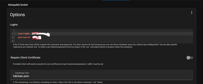

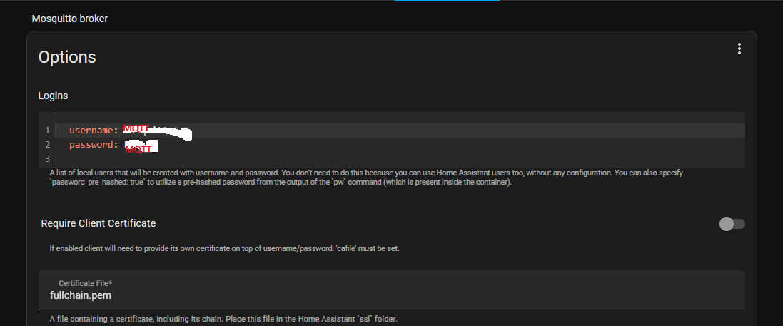

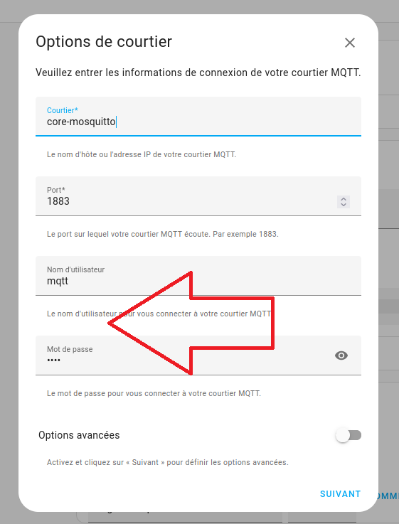

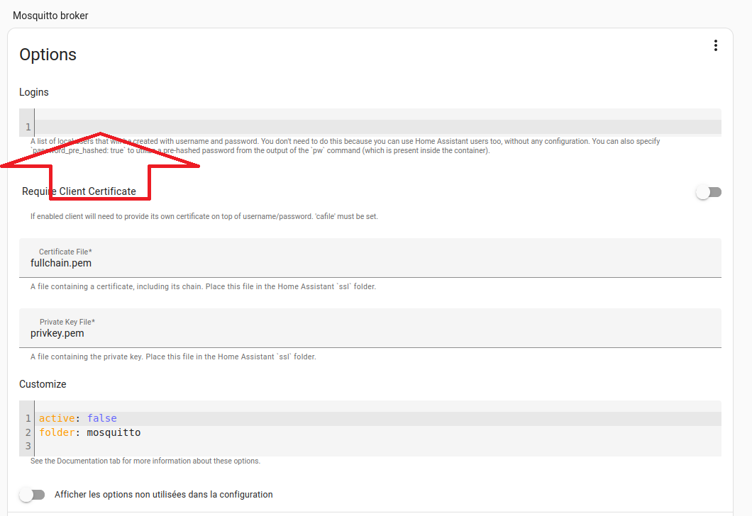

Non pas besoin de login et mdp dans le broker. A mon sens, arrête z2m et le broker mosquitto, puis supprime l’intégration MQTT. Débranche ta clé zigbee.
Ensuite tu rebranches ta clé zigbee et tu vas sur Paramètres → Appareils et services. HA devrait te remettre l’intégration MQTT. Tu ne change rien aux paramètres de MQTT. Tu retournes sur Mosquitto broker que tu redémarres puis ensuite sur zigbee2mqtt mais tu ne le redémarres pas de suite. Tu récupères d’abord le nom d’utilisateur et surtout le mot de passe de MQTT (CONFIGURER puis RE-CONFIGURER MQTT) et tu colles ce nom d’utilisateur et ce mot de passe dans la configuration de zigbee2mqtt et une fois cela fait, tu redémarres zigbee2mqtt
Ton fichier configuration.yaml est tout pourri :laughing:

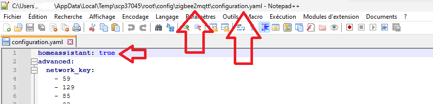

Tu as un « legacy_entity_attributes: true » qui n’a rien à faire là… Tu devrais avoir « homeassistant: true »
il fais peur !
a titre de comparaison celui de yalec et le mien il sont semblabe

La aussi tu as un souci d’apres moi
DONC essai ceci

Il n’y a plus besoin de mettre le username et le password dans la configuration de Mosquitto broker.
Il est tout pourri aussi ton fichier « configuration.yaml » de zigbee2mqtt :rofl:
