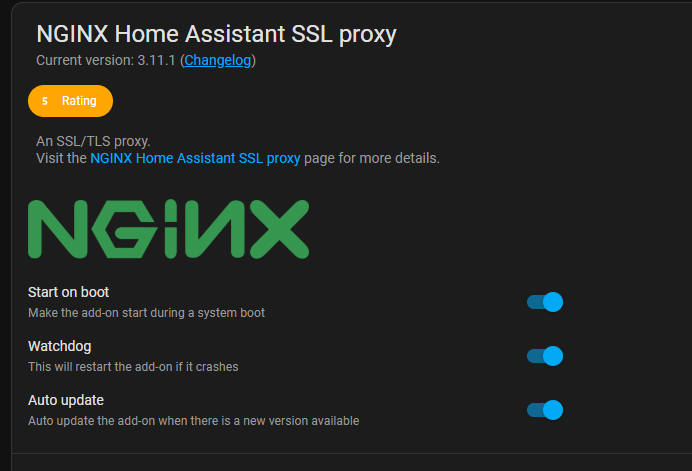

Tu as bien installer NGINX Home Assistant SSL Proxy ?
