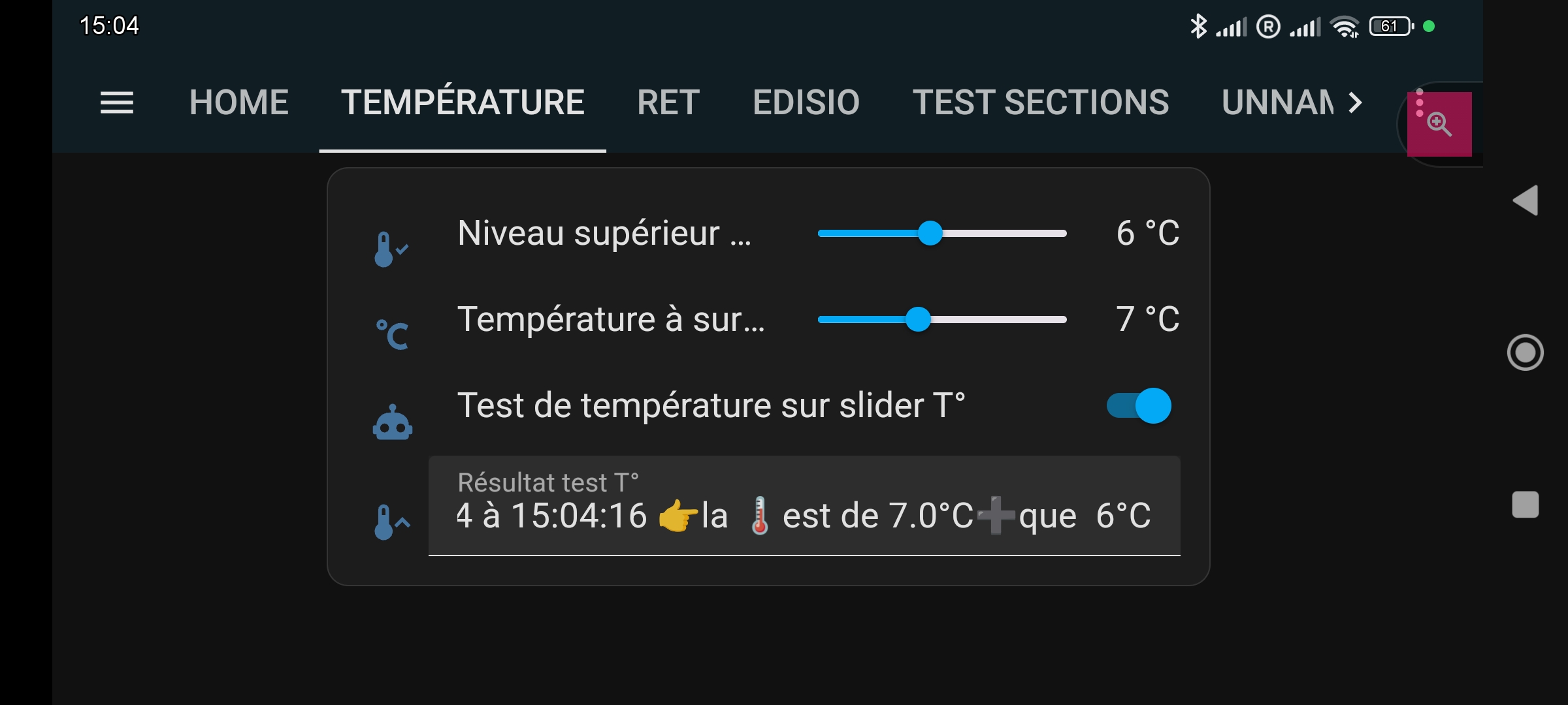

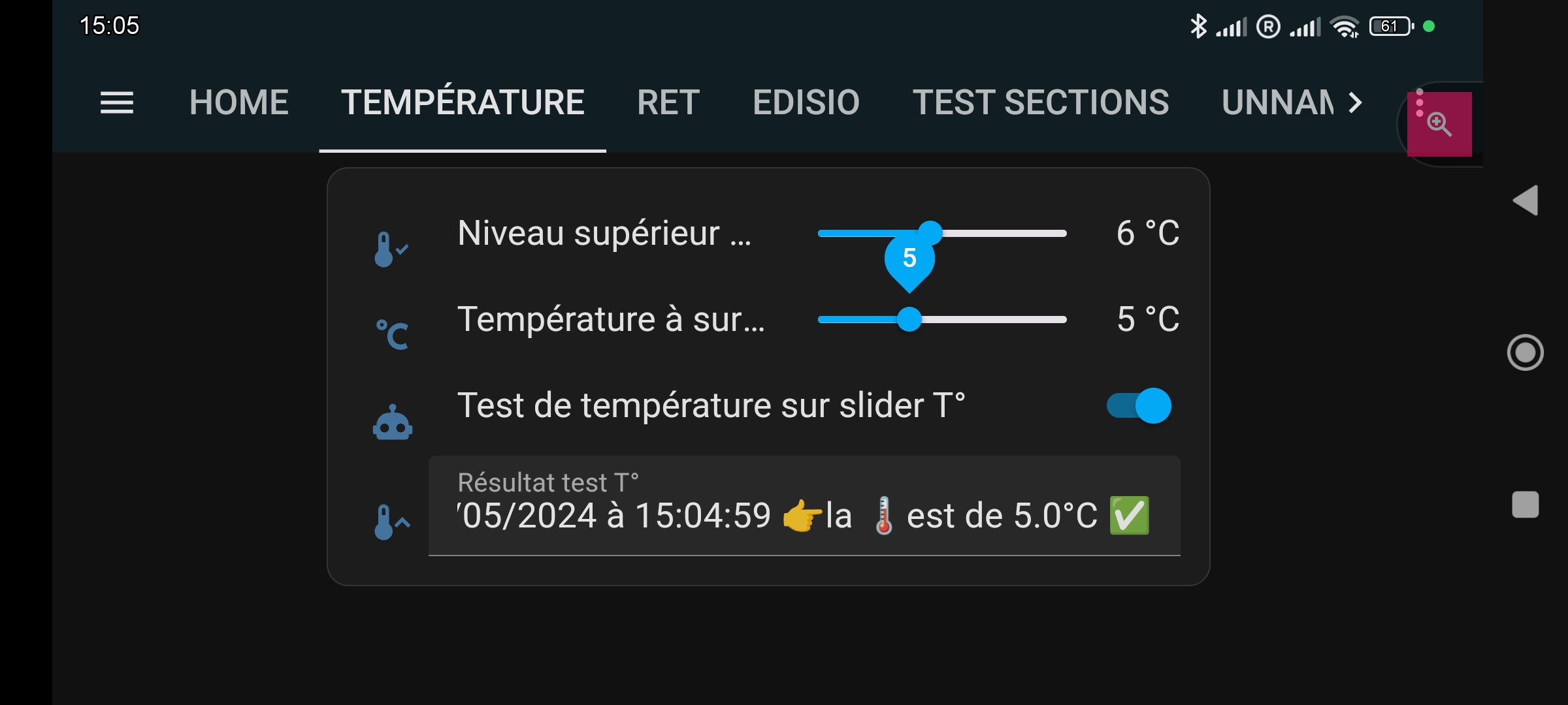

un exemple vérif sur dashboard
alias: Test de température sur slider T°
description: ""
  • platform: state
    entity_id:
    • input_number.temp_de_test
  • platform: state
    entity_id:
    • input_number.niveau_de_test_tdeg
      condition:
  • choose:
    • conditions:
      • condition: numeric_state
        entity_id: input_number.temp_de_test
        above: input_number.niveau_de_test_tdeg
        sequence:
      • service: input_text.set_value
        entity_id: input_text.resultat_test_tdeg
        value: >-
        :eyes:{{ ( as_timestamp(now()) | timestamp_custom('le %d/%m/%Y à %X
        ', local=True, ))}}:backhand_index_pointing_right:la :thermometer:est de
        {{states('input_number.temp_de_test')}}°C​:plus:que
        {{states('input_number.niveau_de_test_tdeg')|round(0)}}°C
    • conditions:
        below: input_number.niveau_de_test_tdeg
        value_template: >-
        {{states('input_number.temp_de_test')<=states('input_number.niveau_de_test_tdeg')}}
        sequence:
        value: >-
        :eyes:{{ ( as_timestamp(now()) | timestamp_custom('le %d/%m/%Y à %T
        {{states('input_number.temp_de_test')}}°C :white_check_mark:
J'ai deux slider number et un input texte
Pas facile sur tel :grinning_face:
