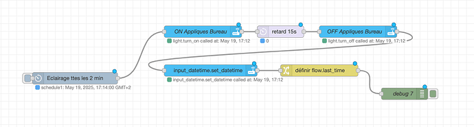

Je fais un test sur la base suivante :
  • dans cron plus, allumage toutes les 2 minutes, pendant 15 sec avec delay
  • stockage de l’heure dans un datetime Test Heure Last Eclairage (seulement les heures)
  • pas d’éclairage si le dernier éclairage a eu lieu dans les 10 dernières minutes
Pour le moment, je récupère l’heure (en mode 12h, pas en mode 24h) que je mets ensuite dans un flow. Mais ensuite je sèche ! :cold_sweat:
[{"id":"96d348d3b7b51f80","type":"cronplus","z":"351fb19cf34a4916","name":"Eclairage ttes les 2 min","outputField":"payload","timeZone":"","persistDynamic":false,"commandResponseMsgOutput":"output1","outputs":1,"options":[{"name":"schedule1","topic":"topic1","payloadType":"default","payload":"","expressionType":"cron","expression":"0 */2 * * * * *","location":"","offset":"0","solarType":"all","solarEvents":"sunrise,sunset"}],"x":150,"y":1520,"wires":[["cda5111a99401062"]]},{"id":"cda5111a99401062","type":"api-call-service","z":"351fb19cf34a4916","name":"ON Appliques Bureau","server":"f1388c55.bbcd1","version":7,"debugenabled":false,"action":"light.turn_on","floorId":[],"areaId":[],"deviceId":[],"entityId":["light.appliques_bureau"],"labelId":[],"data":"","dataType":"jsonata","mergeContext":"","mustacheAltTags":false,"outputProperties":[],"queue":"none","blockInputOverrides":false,"domain":"light","service":"turn_on","x":480,"y":1400,"wires":[["4baf9dc46d79fa3a"]]},{"id":"4baf9dc46d79fa3a","type":"delay","z":"351fb19cf34a4916","name":"","pauseType":"delay","timeout":"15","timeoutUnits":"seconds","rate":"1","nbRateUnits":"1","rateUnits":"second","randomFirst":"1","randomLast":"5","randomUnits":"seconds","drop":false,"allowrate":false,"outputs":1,"x":680,"y":1400,"wires":[["f2219af863b7da78"]]},{"id":"f2219af863b7da78","type":"api-call-service","z":"351fb19cf34a4916","name":"OFF Appliques Bureau","server":"f1388c55.bbcd1","version":7,"debugenabled":false,"action":"light.turn_off","floorId":[],"areaId":[],"deviceId":[],"entityId":["light.appliques_bureau"],"labelId":[],"data":"","dataType":"jsonata","mergeContext":"","mustacheAltTags":false,"outputProperties":[],"queue":"none","blockInputOverrides":false,"domain":"light","service":"turn_off","x":880,"y":1400,"wires":[["db85cdfa5eb69a4d"]]},{"id":"db85cdfa5eb69a4d","type":"api-call-service","z":"351fb19cf34a4916","name":"","server":"f1388c55.bbcd1","version":7,"debugenabled":false,"action":"input_datetime.set_datetime","floorId":[],"areaId":[],"deviceId":[],"entityId":["input_datetime.test_heure_last_eclairage"],"labelId":[],"data":"{\"time\":\"05:04:20\"}","dataType":"jsonata","mergeContext":"","mustacheAltTags":false,"outputProperties":[],"queue":"none","blockInputOverrides":true,"domain":"input_datetime","service":"set_datetime","x":500,"y":1500,"wires":[["403deb7b3b6fec35"]]},{"id":"403deb7b3b6fec35","type":"change","z":"351fb19cf34a4916","name":"","rules":[{"t":"set","p":"last_time","pt":"flow","to":"payload","tot":"msg"}],"action":"","property":"","from":"","to":"","reg":false,"x":780,"y":1500,"wires":[["1d264391af0f605e"]]},{"id":"1d264391af0f605e","type":"debug","z":"351fb19cf34a4916","name":"debug 7","active":true,"tosidebar":true,"console":false,"tostatus":false,"complete":"true","targetType":"full","statusVal":"","statusType":"auto","x":1000,"y":1560,"wires":[]},{"id":"f1388c55.bbcd1","type":"server","name":"Home Assistant RBT","addon":true,"rejectUnauthorizedCerts":true,"ha_boolean":"","connectionDelay":false,"cacheJson":false,"heartbeat":false,"heartbeatInterval":"","statusSeparator":"","enableGlobalContextStore":false}]

L’allumage de la lampe et l’attente ne servent à rien.
Ensuite, tu récupères l’heure. OK.
Le change node derrière il est supposé faire quoi ? Tu stockes dans une variable, la valeur récupérée depuis HA. Et ça s’arrête là.
Voilà une idée, en sortie de cron-plus, tu récupères en payload l’heure d’exécution. C’est ça qu’il faut garder.
Et après la lecture de l’heure du helper, faire un test (noeud switch) pour comparer la valeur de l’heure d’exécution et l’heure du helper.

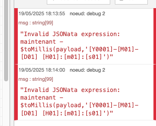

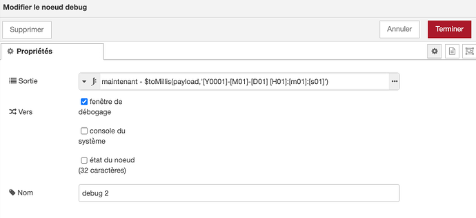

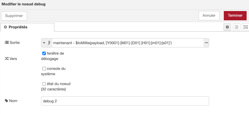

[{"id":"71a711c557d6f089","type":"api-current-state","z":"792297de7ddff2e5","name":"","server":"d28c9492.f419c8","version":3,"outputs":1,"halt_if":"","halt_if_type":"str","halt_if_compare":"is","entity_id":"input_datetime.mydate","state_type":"str","blockInputOverrides":false,"outputProperties":[{"property":"payload","propertyType":"msg","value":"","valueType":"entityState"},{"property":"data","propertyType":"msg","value":"","valueType":"entity"}],"for":"0","forType":"num","forUnits":"minutes","override_topic":false,"state_location":"payload","override_payload":"msg","entity_location":"data","override_data":"msg","x":590,"y":4540,"wires":[["864df9f52bcd1a1a"]]},{"id":"d3ddfcedd33f61f0","type":"inject","z":"792297de7ddff2e5","name":"","props":[{"p":"payload"},{"p":"topic","vt":"str"}],"repeat":"","crontab":"","once":false,"onceDelay":0.1,"topic":"","payload":"","payloadType":"date","x":120,"y":4540,"wires":[["d47aa010a0119861"]]},{"id":"864df9f52bcd1a1a","type":"debug","z":"792297de7ddff2e5","name":"debug 2","active":true,"tosidebar":true,"console":false,"tostatus":false,"complete":"maintenant - $toMillis(payload,'[Y0001]-[M01]-[D01] [H01]:[m01]:[s01]')","targetType":"jsonata","statusVal":"","statusType":"auto","x":920,"y":4540,"wires":[]},{"id":"d47aa010a0119861","type":"change","z":"792297de7ddff2e5","name":"","rules":[{"t":"set","p":"maintenant","pt":"msg","to":"payload","tot":"msg"}],"action":"","property":"","from":"","to":"","reg":false,"x":310,"y":4540,"wires":[["71a711c557d6f089"]]},{"id":"d28c9492.f419c8","type":"server","name":"hassio","version":5,"addon":false,"rejectUnauthorizedCerts":false,"ha_boolean":"y|yes|true|on|home|open","connectionDelay":true,"cacheJson":true,"heartbeat":false,"heartbeatInterval":"30","areaSelector":"friendlyName","deviceSelector":"friendlyName","entitySelector":"friendlyName","statusSeparator":"at: ","statusYear":"hidden","statusMonth":"short","statusDay":"numeric","statusHourCycle":"h23","statusTimeFormat":"h:m","enableGlobalContextStore":true}]

Cela explique, par exemple, que toMillis peut avoir un picture string. Le bazar qui commence par Y0001…
C’est ce qui permet de transformer en millisecondes une date et de préciser quel est le format de la date en entrée.
Le format complet est expliqué ici: XPath and XQuery Functions and Operators 3.1
L’erreur signifie simplement que le « machin » qui est en payload n’a pas la même syntaxe que dans mon cas, ou que maintenant n’existe pas…
