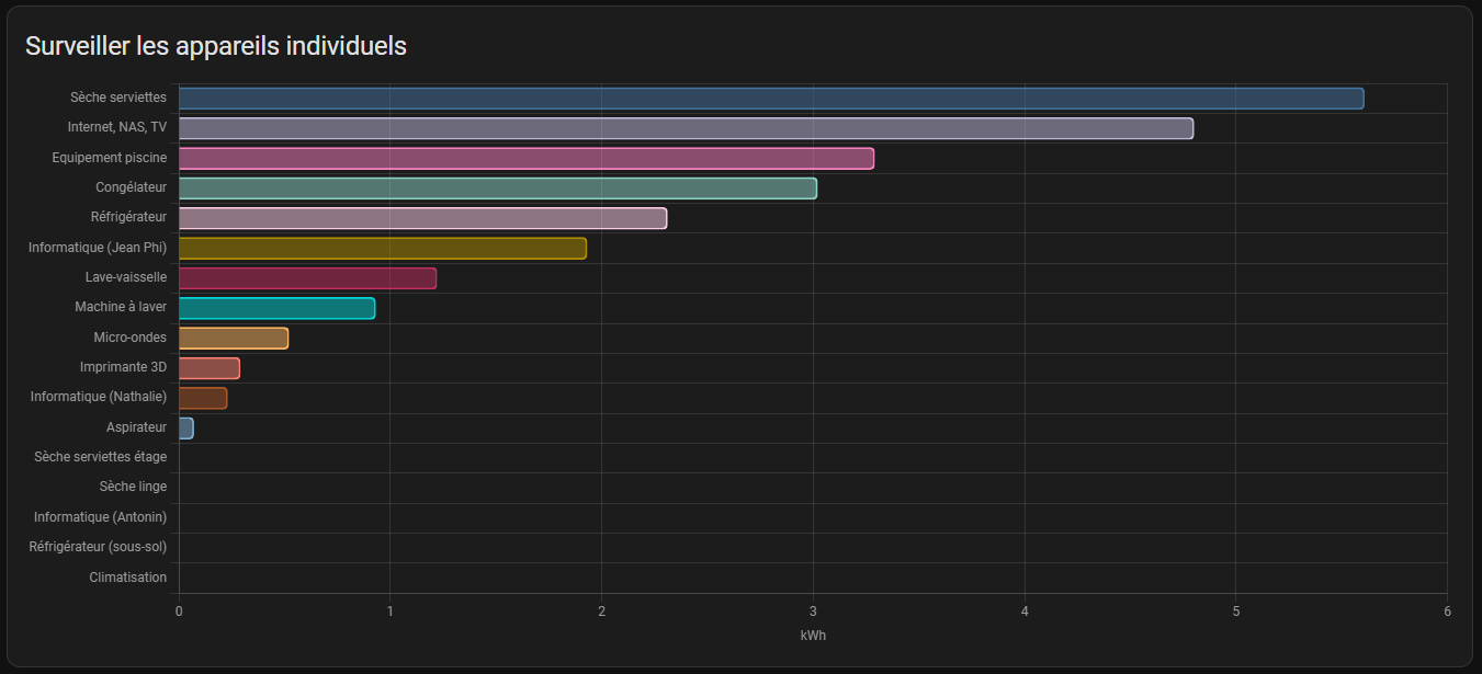

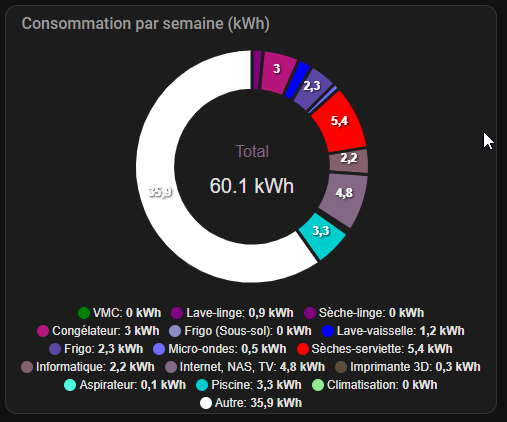

J’ai une carte de type custom:apexcharts-card:
Code de la carte:
type: custom:apexcharts-card
chart_type: donut
header:
  title: Consommation par semaine (kWh)
  show: true
  show_states: false
  colorize_states: true
apex_config:
  plotOptions:
    pie:
      donut:
        labels:
          show: true
          total:
            show: true
            label: Total
            formatter: >
              EVAL:function(w) { return w.globals.seriesTotals.reduce((a, b) =>
              {return (a + b)} , 0).toFixed(1) + " kWh" }
series:
  - entity: sensor.vmc_energy_weekly
    type: column
    unit: ' kWh'
    color: Green
  - entity: sensor.washing_machine_energy_weekly
    type: column
    unit: ' kWh'
    color: Purple
  - entity: sensor.dryer_energy_weekly
    type: column
    unit: ' kWh'
    color: Purple
  - entity: sensor.freezer_energy_weekly
    type: column
    unit: ' kWh'
    color: rgb(181,20,123)
  - entity: sensor.fridge2_energy_weekly
    name: Frigo (Sous-sol)
    type: column
    unit: ' kWh'
    color: rgb(141,139,197)
  - entity: sensor.dishwasher_energy_weekly
    type: column
    unit: ' kWh'
    color: Blue
  - entity: sensor.fridge_energy_weekly
    type: column
    unit: kWh
    color: rgb(90,71,164)
  - entity: sensor.microwave_energy_weekly
    type: column
    unit: ' kWh'
    color: rgb(112,107,249)
  - entity: sensor.towel_dryer_bathroom_energy_weekly
    type: column
    transform: >-
      return parseFloat(x) +
      parseFloat(hass.states['sensor.towel_dryer_shower_room_energy_weekly'].state)
    unit: ' kWh'
    color: Red
  - entity: sensor.computer_first_floor_energy_weekly
    type: column
    transform: >-
      parseFloat(hass.states['sensor.computer_antonin_energy_weekly'].state) +
      parseFloat(hass.states['sensor.computer_office_energy_weekly'].state)
    unit: ' kWh'
    color: rgb(132,97,108)
  - entity: sensor.internet_nas_tv_energy_weekly
    name: Internet, NAS, TV
    type: column
    unit: ' kWh'
    color: rgb(132,104,134)
  - entity: sensor.printer_3d_energy_weekly
    type: column
    unit: ' kWh'
    color: rgb(92,77,56)
  - entity: sensor.vacuum_energy_weekly
    type: column
    unit: kWh
    color: rgb(80,252,226)
  - entity: sensor.pool_energy_weekly
    type: column
    unit: ' kWh'
    color: Darkturquoise
  - entity: sensor.climatisation_energy_weekly
    type: column
    unit: ' kWh'
    color: Lightgreen
  - entity: sensor.teleinformation_energy_weekly
    color: white
    transform: >-
      return parseFloat(x) -
      parseFloat(hass.states['sensor.vmc_energy_weekly'].state)-
      parseFloat(hass.states['sensor.washing_machine_energy_weekly'].state)-
      parseFloat(hass.states['sensor.dryer_energy_weekly'].state)-
      parseFloat(hass.states['sensor.freezer_energy_weekly'].state)-
      parseFloat(hass.states['sensor.fridge2_energy_weekly'].state)-
      parseFloat(hass.states['sensor.towel_dryer_bathroom_energy_weekly'].state)-
      parseFloat(hass.states['sensor.towel_dryer_shower_room_energy_weekly'].state)-
      parseFloat(hass.states['sensor.computer_first_floor_energy_weekly'].state)-
      parseFloat(hass.states['sensor.computer_antonin_energy_weekly'].state)-
      parseFloat(hass.states['sensor.computer_office_energy_weekly'].state)-
      parseFloat(hass.states['sensor.internet_nas_tv_energy_weekly'].state)-
      parseFloat(hass.states['sensor.printer_3d_energy_weekly'].state)-
      parseFloat(hass.states['sensor.dishwasher_energy_weekly'].state)-
      parseFloat(hass.states['sensor.microwave_energy_weekly'].state)-
      parseFloat(hass.states['sensor.vacuum_energy_weekly'].state)-
      parseFloat(hass.states['sensor.pool_energy_weekly'].state)-
      parseFloat(hass.states['sensor.climatisation_energy_weekly'].state)-
      parseFloat(hass.states['sensor.fridge_energy_weekly'].state)

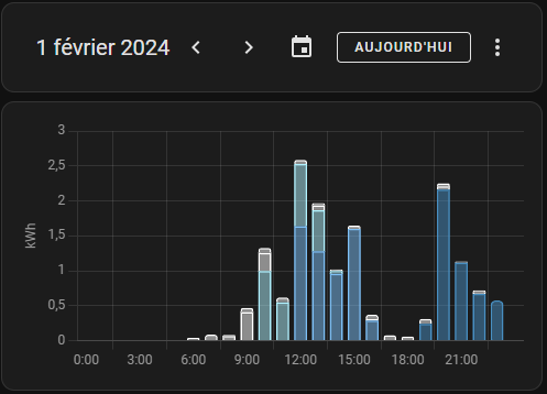

Et j’ai cette vue dans mon tableau de bord Energie:

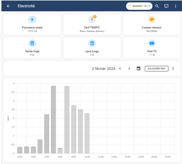

Ceci rejoint le point que je faisais plus haut que celà nécessite la création des utility_meter hourly, daily, weekly, etc. pour chaque poste de consommation. Bien sûr, c’est faisable, mais dommage d’avoir à en passer par là alors que le dashboard energy de base le fait tout seul sans avoir à créer l’ensemble des meters.

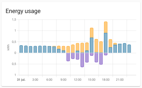

Ci-dessous la carte rapidement. Dommage qu’on ne puisse pas la « customiser » plus. Ici je n’ai mis que 2 cartes Energy:
      - type: energy-date-selection
      - type: energy-usage-graph

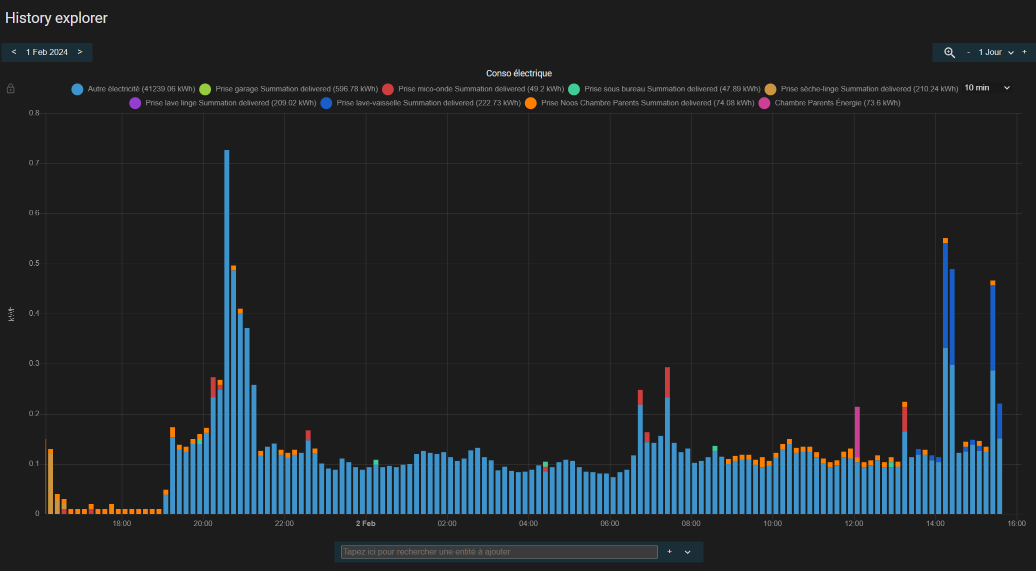

Oui, j’utilise cette carte aussi dans certains de mes tableaux de bord. Il est en effet possible de naviguer dans le passer et de modifier le niveau de détail, en allant jusqu’à des pas de 10 min, ce que ne permet pas le dashboard energy.
Cette carte est assez puissante, même si sa configuration n’est pas toujours simple (il y a de nombreuses options, il faut aller lire the Github.
Voici un exemple de ce que j’ai réussi à faire par exemple:
Merci pour la découverte. Exactement ce que je cherchais pour m’approcher du rendu de l’appli shelly pour mon shelly em.
Ci-dessous le code de ma carte si ça peut servir:

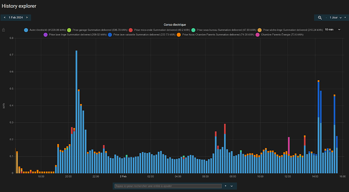

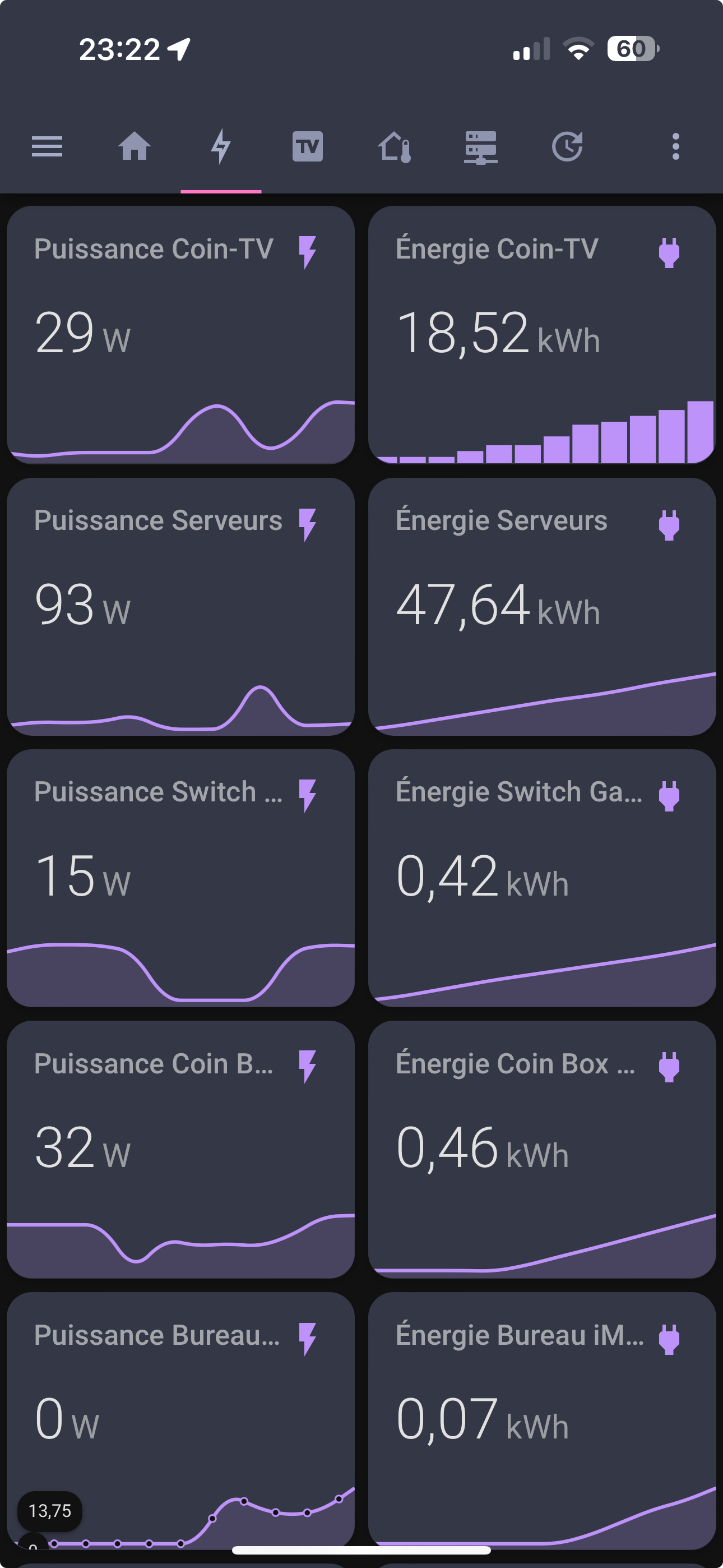

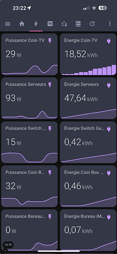

Ça m’intéresse beaucoup pour suivre mes différentes prises connectées car actuellement les graphiques que j’ai présentent le cumul des consommations d’énergie depuis leur intégration dans HA… donc pas top.
Ce que tu as fais @WarC0zes me semble répondre à mon besoin ici présent (évoqué dans mon autre sujet sur les capteurs de température).
Voudrais-Tu bien détailler le code à employer, s’il te plaît ?

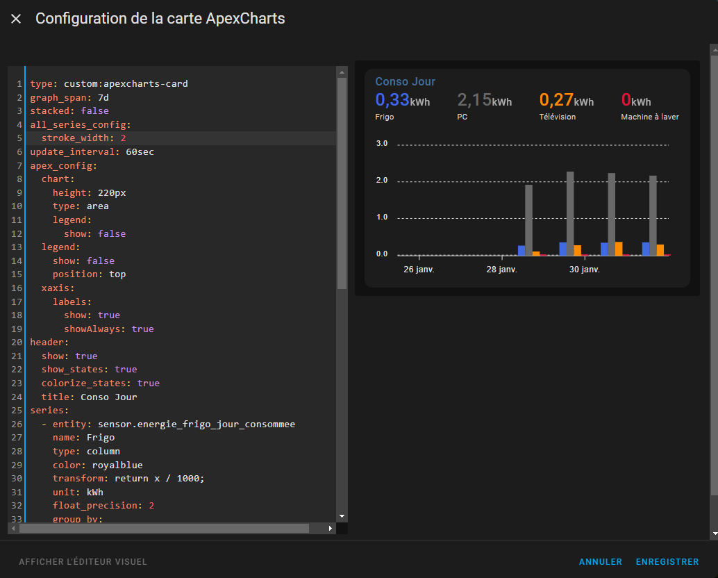

voici un exemple:
    color: royalblue
    type: column
    transform: return x / 1000;
    unit: kWh
    float_precision: 2
    group_by:
      func: max
      duration: 1d
  - entity: sensor.energie_pc_jour_consommee
    color: DimGray
    type: column
    unit: kWh
    float_precision: 2
    group_by:
      func: max
      duration: 1d
  - entity: sensor.energie_tv_jour_consommee
    color: DarkOrange
    type: column
    unit: kWh
    float_precision: 2
    group_by:
      func: max
      duration: 1d
