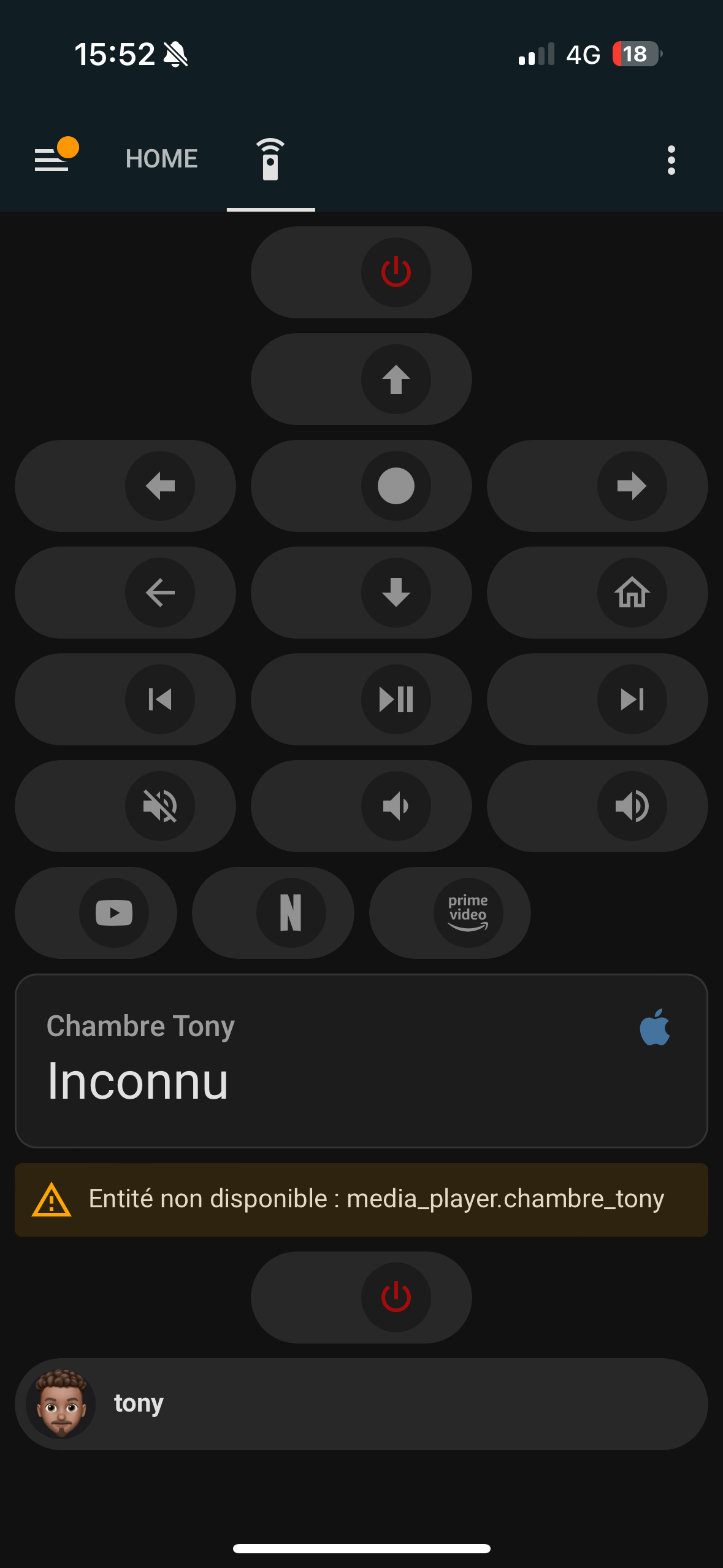

J’ai trouvé la réponse à ma question

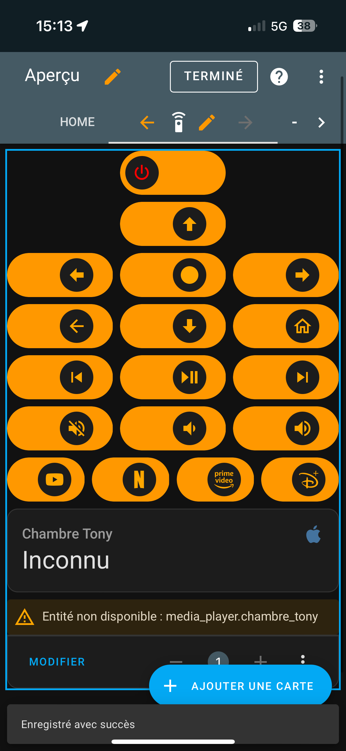

Maintenant savais vous comment centrer l’icône en css?
tu utilises quelle carte pour faire ta télécommande ?
partage ton code pour qu’on puisse t’aider.

  - square: false
      - type: custom:bubble-card
        card_type: button
        button_type: name
        styles: |
          .bubble-button-card-container {
                  background-color: rgba(0,0,0,0)
        card_type: button
        entity: remote.appletv
        icon: mdi:power
          service: remote.send_command
            command: up
            entity_id: remote.appletv
        styles: |
          .bubble-icon-container {
                  display: block;
                  display: flex;
                  flex-wrap: wrap;
                  align-content: center;
                  justify-content: center;
                  min-width: 38px;
                  min-height: 38px;
                  margin: 45px;
                  border-radius: 100%;
          .bubble-icon {
              color: red !important;
        card_type: button
        button_type: name
        styles: |
        card_type: button
        styles: |
        card_layout: normal
        button_type: name
        card_type: button
        icon: mdi:arrow-up-bold
            command: DPAD_UP
        styles: |
                  display: flex;
                  display: flex;
                  flex-wrap: ;
                  min-width: px;
                  min-height: 38px;
                  margin: 60px;
                  border-radius: 50%;
        card_type: button
        styles: |
        card_layout: normal
        button_type: name
        card_type: button
        icon: mdi:arrow-left-bold
            command: DPAD_LEFT
        styles: |
                  display: flex;
                  display: flex;
                  flex-wrap: ;
                  min-width: px;
                  min-height: 38px;
                  margin: 60px;
                  border-radius: 50%;
        card_type: button
        icon: mdi:circle
            command: DPAD_CENTER
            hold_secs: 0.5
        styles: |
                  display: flex;
                  display: flex;
                  flex-wrap: ;
                  min-width: px;
                  min-height: 38px;
                  margin: 60px;
                  border-radius: 50%;
        card_type: button
        icon: mdi:arrow-right-bold
            command: DPAD_RIGHT
        styles: |
                  display: flex;
                  display: flex;
                  flex-wrap: ;
                  min-width: 38px;
                  min-height: 38px;
                  margin: 60px;
                  border-radius: 50%;
        card_type: button
            command: BACK
            command: BACK
            hold_secs: 0.5
        styles: |
                  display: flex;
                  display: flex;
                  flex-wrap: ;
                  min-width: px;
                  min-height: 38px;
                  margin: 60px;
                  border-radius: 50%;
        card_type: button
        icon: mdi:arrow-down-bold
            command: DPAD_DOWN
        styles: |
                  display: flex;
                  display: flex;
                  flex-wrap: ;
                  min-width: px;
                  min-height: 38px;
                  margin: 60px;
                  border-radius: 50%;
        card_type: button
        icon: mdi:home-outline
            command: HOME
            command: HOME
            hold_secs: 0.5
        styles: |
                  display: flex;
                  display: flex;
                  flex-wrap: ;
                  min-width: px;
                  min-height: 38px;
                  margin: 60px;
                  border-radius: 50%;
  - square: false
    columns: 3
        card_type: button
        icon: mdi:skip-previous
            command: MEDIA_PREVIOUS
            command: MEDIA_REWIND
        styles: |
                  display: flex;
                  display: flex;
                  flex-wrap: ;
                  min-width: px;
                  min-height: 38px;
                  margin: 60px;
                  border-radius: 50%;
        card_type: button
        icon: mdi:play-pause
            command: MEDIA_PLAY_PAUSE
            command: MEDIA_STOP
        styles: |
                  display: flex;
                  display: flex;
                  flex-wrap: ;
                  min-width: px;
                  min-height: 38px;
                  margin: 60px;
                  border-radius: 50%;
        card_type: button
        icon: mdi:skip-next
            command: MEDIA_NEXT
            command: MEDIA_FAST_FORWARD
        styles: |
                  display: flex;
                  display: flex;
                  flex-wrap: ;
                  min-width: px;
                  min-height: 38px;
                  margin: 60px;
                  border-radius: 50%;
        card_type: button
        icon: mdi:volume-off
            command: MUTE
        styles: |
                  display: flex;
                  display: flex;
                  flex-wrap: ;
                  min-width: px;
                  min-height: 38px;
                  margin: 60px;
                  border-radius: 50%;
        card_type: button
        icon: mdi:volume-medium
            command: VOLUME_DOWN
        styles: |
                  display: flex;
                  display: flex;
                  flex-wrap: ;
                  min-width: px;
                  min-height: 38px;
                  margin: 60px;
                  border-radius: 50%;
        card_type: button
        icon: mdi:volume-high
            command: VOLUME_UP
        styles: |
                  display: flex;
                  display: flex;
                  flex-wrap: ;
                  min-width: px;
                  min-height: 38px;
                  margin: 60px;
                  border-radius: 50%;
  - square: false
    columns: 4
        card_type: button
        icon: mdi:youtube
          service: remote.turn_on
            activity: https://www.youtube.com
        styles: |
                  display: flex;
                  display: flex;
                  flex-wrap: ;
                  min-width: 38px;
                  min-height: 38px;
                  margin: 35px;
                  border-radius: 50%;
        card_type: button
        icon: mdi:netflix
            activity: https://www.netflix.com/title
        styles: |
                  display: flex;
                  display: flex;
                  flex-wrap: ;
                  min-width: 38px;
                  min-height: 38px;
                  margin: 35px;
                  border-radius: 50%;
        card_type: button
        icon: phu:prime-video
            activity: https://app.primevideo.com
        styles: |
                  display: flex;
                  display: flex;
                  flex-wrap: ;
                  min-width: 38px;
                  min-height: 38px;
                  margin: 35px;
                  border-radius: 50%;
  - type: entity
    attribute: current_activity
  - type: media-control
    entity: media_player.chambre_tony

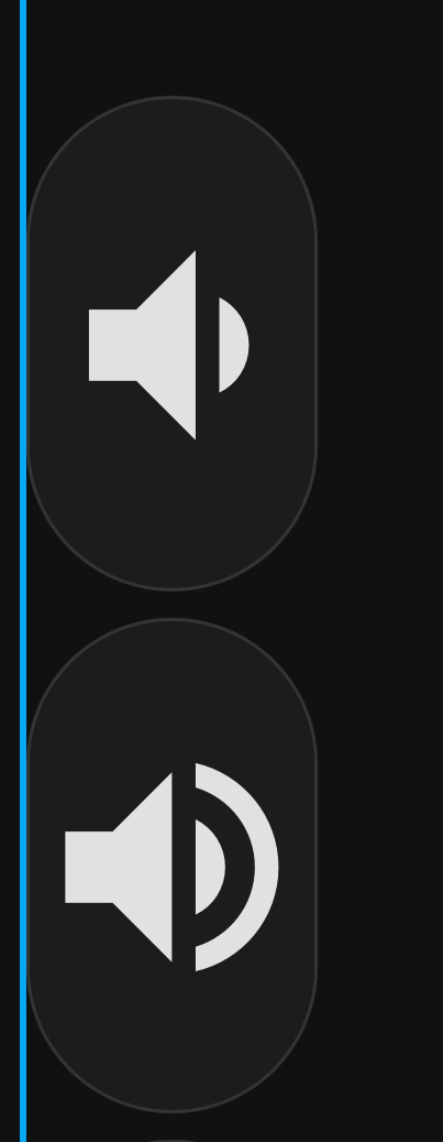

si tu enlèves la marge, tu n’as pas l’icône centrer ?
J’ai enlever la marge sur le bouton power voilà ce que ça donne
Salut, essayes ça
margin-left: auto;
margin-right: auto;
ça mets une marge automatique de chaque côté et donc un centrage.
A+ fred
Cela ne fonctionne pas

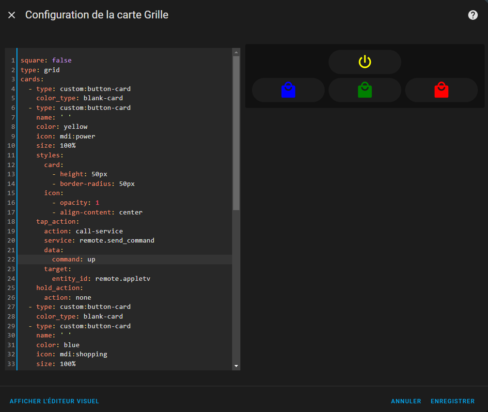

tu devrais essayer button-card, qui sera plus facile à paramétrer pour centrer une icône.
code:
square: false
    color_type: blank-card
    color: yellow
    icon: mdi:power
        - height: 50px
        - border-radius: 50px
        - opacity: 1
        - align-content: center
        command: up
    color: blue
    icon: mdi:shopping
        - height: 50px
        - opacity: 1
    color: green
    icon: mdi:shopping
        - height: 50px
        - opacity: 1
    color: red
    icon: mdi:shopping
        - height: 50px
        - opacity: 1
columns: 3

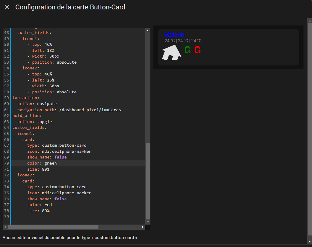

Peut t-on mettre ces 2 bouton dans 1 seul ovale ?
ça pourrait se faire, en utilisant des custom_fileds.
Tu fais un button-card avec un fond et conteur, de la largeur que tu veux sans entité et ajoute-les icônes dedans par des custom_field.
J’ai fait un exemple vite fais, sinon t’as la doc qui explique le custom_filed et des exemples fourni.
Je suis perdu :joy::man_facepalming:t4:
