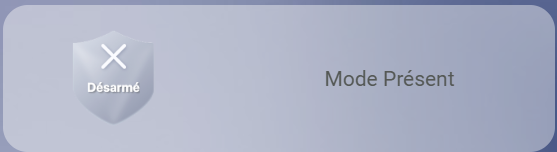

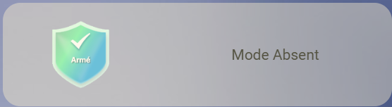

voici mon bouton
type: custom:button-card
entity: input_boolean.absent_present
    if (entity.state == "on") return "Mode Absent";
    else return "Mode Présent";
show_entity_picture: true
styles:
  card:
    - height: 80%
layout: icon_name
aspect_ratio: 3/1
entity_picture: |
    if (entity.state == "on") return "/local/images/Armer.png";
    else return "/local/images/Desarmer.png";
