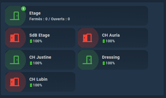

Alors chez moi j’utilise l’affaire comme ceci :
Résumé
    primary: Etage
    tap_action:
      action: navigate
      navigation_path: bathroom
    hold_action:
      action: toggle
    double_tap_action:
      action: more-info
    fill_container: true
    layout: horizontal
    multiline_secondary: false
    secondary: |
      {% set all = expand('group.grp_pte_etage')| list -%}
      {% set closed = all | selectattr('state','eq','off')|list|count%}
      {% set open = all | selectattr('state','eq','on')|list|count%}
      Fermés : {{closed}} / Ouverts : {{open}}
    icon: |
      {% if is_state('group.grp_pte_etage', 'on') %}
        mdi:door-open
        mdi:door-closed
    icon_color: |
      {% if is_state('group.grp_pte_etage','on') %}
        red
        green
    badge_icon: >-
      {% set all = expand('group.grp_pte_etage')| list -%}  {% set open1 = all |
      selectattr('state','eq','on')|list|count%} {% set closed1 = all |
      selectattr('state','eq','off')|list|count%}       {% if open1 == 1 %}
        mdi:numeric-1
      {% elif open1 == 2 %}
        mdi:numeric-2
      {% elif open1 == 3 %}
        mdi:numeric-3
      {% elif open1 == 4 %}
        mdi:numeric-4
      {% elif open1 == 5 %}
        mdi:numeric-5
      {% elif open1 == 6 %}
        mdi:numeric-6
      {% elif open1 == 7 %}
        mdi:numeric-7
      {% elif open1 == 8 %}
        mdi:numeric-8
      {% elif open1 == 9 %}
        mdi:numeric-9
      {% elif open1 == 10 %}
        mdi:numeric-10
        mdi:numeric-5
    badge_color: |
      {% if open == 0 %}
        green
        red
    card_mod:
      style: |
        :host {
          --mush-badge-icon-size: 0.95em;
          --mush-icon-size: 76px;
          height: 66px;
          margin-left: -18px !important;
        mushroom-badge-icon {
          left: 60px;
          top: 6px;

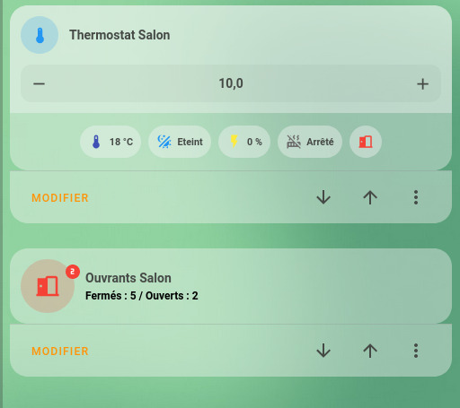

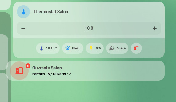

J’ai un comportement étrange de la carte (j’ai repris le code de @jerome6994)
En mode édition, pas de problème :
Si je sors du mode édition, la pagination est dégueu:
le code :
primary: Ouvrants Salon
hold_action:
  action: toggle
double_tap_action:
  action: more-info
layout: horizontal
secondary: |
  {% set all = expand('binary_sensor.ouvrants_salon')| list -%}
icon: |
  {% if is_state('binary_sensor.ouvrants_salon', 'on') %}
    mdi:door-open
    mdi:door-closed
icon_color: |
  {% if is_state('binary_sensor.ouvrants_salon','on') %}
    red
    green
badge_icon: >-
  {% set all = expand('binary_sensor.ouvrants_salon')| list -%}  {% set open1 =
  all | selectattr('state','eq','on')|list|count%} {% set closed1 = all |
    mdi:numeric-1
    mdi:numeric-2
    mdi:numeric-3
    mdi:numeric-4
    mdi:numeric-5
    mdi:numeric-6
    mdi:numeric-7
    mdi:numeric-8
    mdi:numeric-9
    mdi:numeric-10
    mdi:numeric-5
badge_color: |
  {% if open == 0 %}
    green
    red
card_mod:
  style: |
    :host {
      --mush-icon-size: 60px;
      height: 66px;
      left: 50px;
      top: 6px;
Je me réponds à moi-même : margin-left…
my bad, sorry

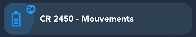

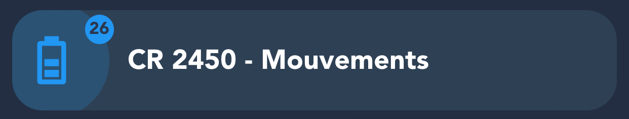

Mon code en production :
type: custom:stack-in-card
    primary: CR 2450 - Mouvements
    tap_action:
      action: navigate
    hold_action:
      action: toggle
    double_tap_action:
      action: more-info
    layout: horizontal
    icon: mdi:battery-medium
    icon_color: blue
    badge_icon: none
    badge_color: transparent
    card_mod:
      style: |
        :host {
          height: 66px;
          margin-left: -24px !important;
          left: 60px;
          top: 6px;
        ha-card {
          --card-primary-font-size: 18px;
          --card-secondary-font-size: 14px;
        mushroom-badge-icon:after {
          content: "{{ expand(states.sensor.grp_batterie_cr2450) | list | count }}";
          position: absolute;
          display: flex;
          justify-content: center;
          align-items: center;
          background: rgb(var(--rgb-blue));
          color: var(--card-background-color);
          font-weight: bolder;
          border-radius: 50%;
          width: 100%;
          height: 120%;
          font-size: 0.8em;
          top: 2px;
