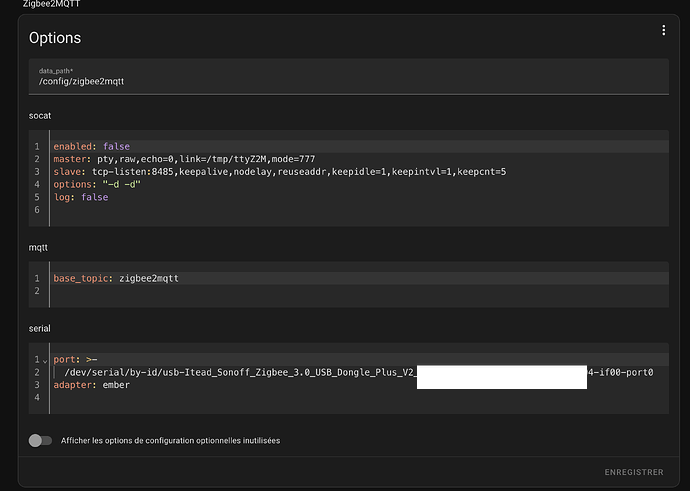

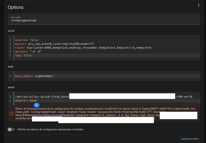

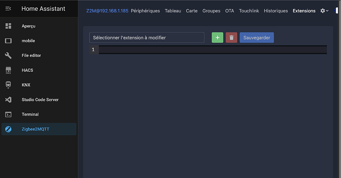

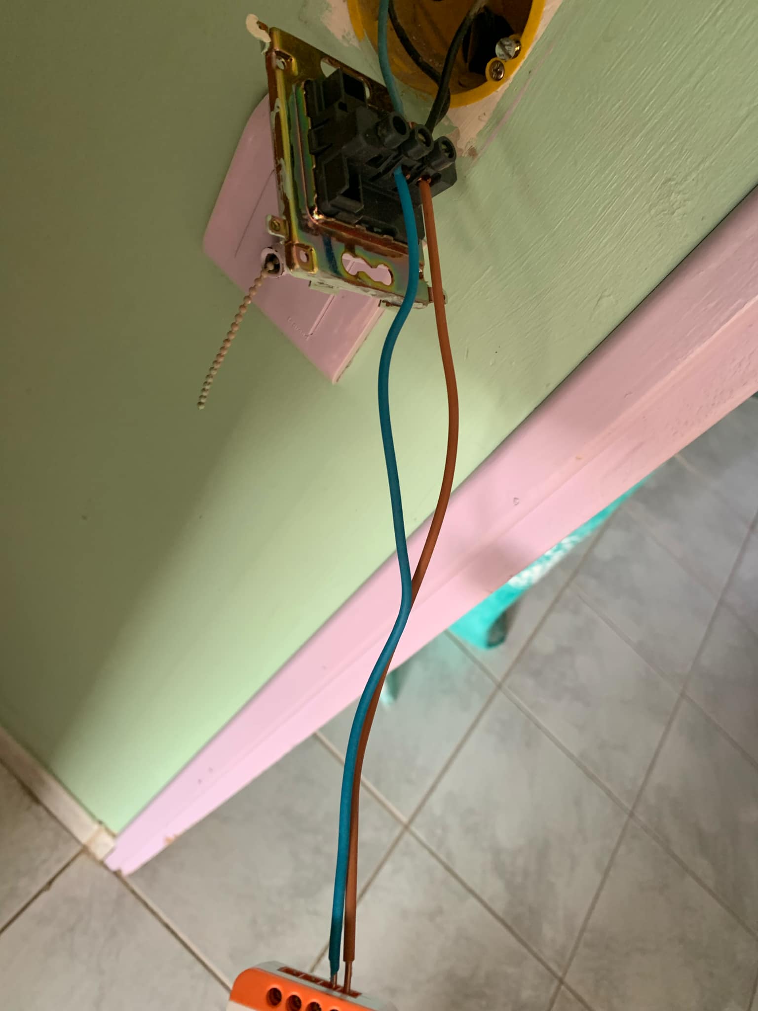

J’ai donc voulu essayer d’installer mon boîtier ZBMINIL2 afin de le paramétrer avec ma clé Zigbee
Voici mon montage

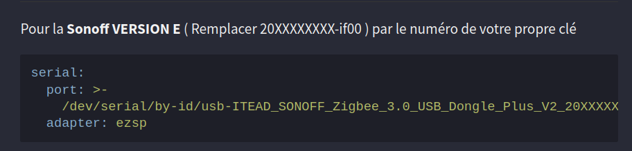

Ensuite, je me suis basé
sur ce tutoriel Je suis arrivé à cette partie.

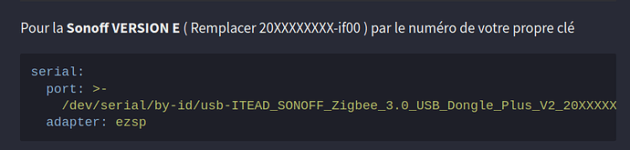

Enfin, rajoutez le type d’adaptateur correspondant à votre clé USB Zigbee, dans notre exemple:
adapter: ezsp

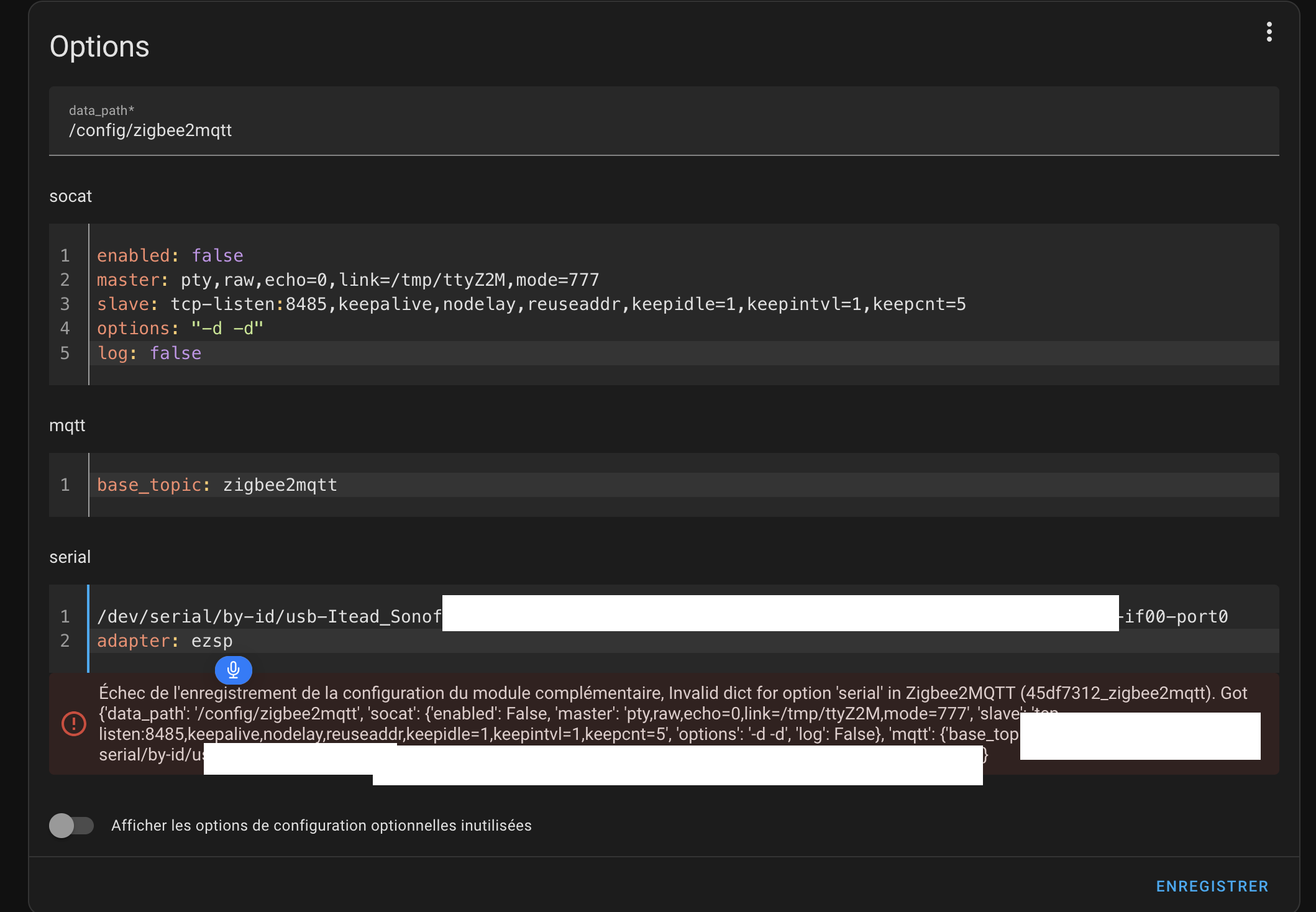

Le problème est que lorsque je veux enregistrer, j’ai ce message.

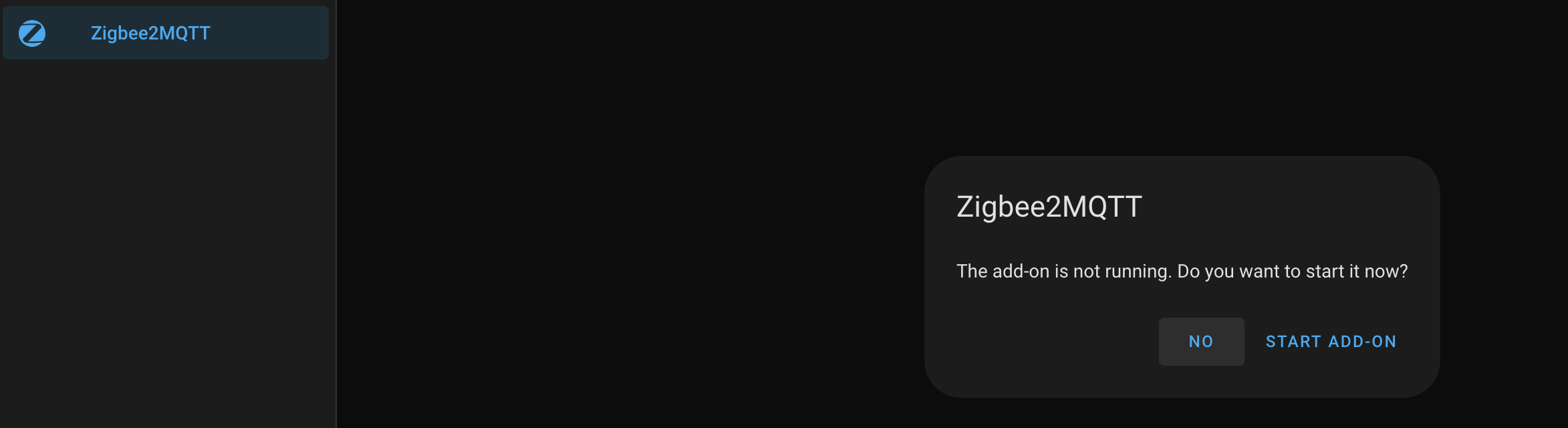

[10:48:31] INFO: Preparing to start...
[10:48:31] INFO: Socat not enabled
[10:48:31] INFO: Starting Zigbee2MQTT...
[2025-01-17 10:48:33] info: z2m: Logging to console, file (filename: log.log)
[2025-01-17 10:48:33] info: z2m: Starting Zigbee2MQTT version 2.0.0 (commit #unknown)
[2025-01-17 10:48:33] info: z2m: Starting zigbee-herdsman (3.2.1)
[2025-01-17 10:48:33] info: zh:adapter:discovery: Matched adapter: {"path":"/dev/ttyUSB0","manufacturer":"Itead","serialNumber":"0exxxxxx5516304","pnpId":"usb-Itead_Sonoff_Zigbee_3.0_USB_Dongle_Plus_V2_0ef574xxxxxxxxx16304-if00-port0","vendorId":"10c4","productId":"ea60"} => zstack: path=/dev/ttyUSB0, score=4
[2025-01-17 10:48:33] info: zh:zstack:znp: Opening SerialPort with {"path":"/dev/ttyUSB0","baudRate":115200,"rtscts":false,"autoOpen":false}
[2025-01-17 10:48:33] info: zh:zstack:znp: Serialport opened
[2025-01-17 10:48:33] info: zh:zstack:znp: Writing CC2530/CC2531 skip bootloader payload
[2025-01-17 10:48:35] info: zh:zstack:znp: Skip bootloader for CC2652/CC1352
[2025-01-17 10:48:53] error: z2m: Error while starting zigbee-herdsman
[2025-01-17 10:48:53] error: z2m: Failed to start zigbee-herdsman
[2025-01-17 10:48:53] error: z2m: Check https://www.zigbee2mqtt.io/guide/installation/20_zigbee2mqtt-fails-to-start_crashes-runtime.html for possible solutions
[2025-01-17 10:48:53] error: z2m: Exiting...
[2025-01-17 10:48:53] error: z2m: Error: Failed to connect to the adapter (Error: SRSP - SYS - ping after 6000ms)
at ZStackAdapter.start (/app/node_modules/.pnpm/zigbee-herdsman@3.2.1/node_modules/zigbee-herdsman/src/adapter/z-stack/adapter/zStackAdapter.ts:113:27)
at Controller.start (/app/node_modules/.pnpm/zigbee-herdsman@3.2.1/node_modules/zigbee-herdsman/src/controller/controller.ts:136:29)
at Zigbee.start (/app/lib/zigbee.ts:69:27)
at Controller.start (/app/lib/controller.ts:142:13)
at start (/app/index.js:161:5)
Et lorsque je veux enregistrer les paramètres enregistrer, j’ai ce message

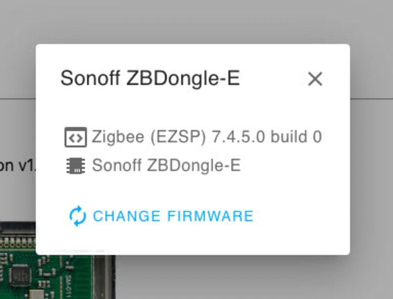

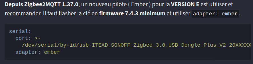

oulaaa tu es sur que tu n’as pas oublié certaines choses ?
voila ce qu’il est écrit dans le tuto
mais surtout

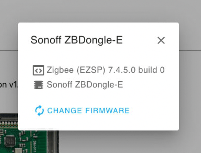

il faut déjà commencer par flasher ta clé avec le firmware 7.4.5 (dernier en date ce jour)
https://github.com/darkxst/silabs-firmware-builder/raw/refs/heads/main/firmware_builds/zbdonglee/ncp-uart-hw-v7.4.5.0-zbdonglee-115200.gbl

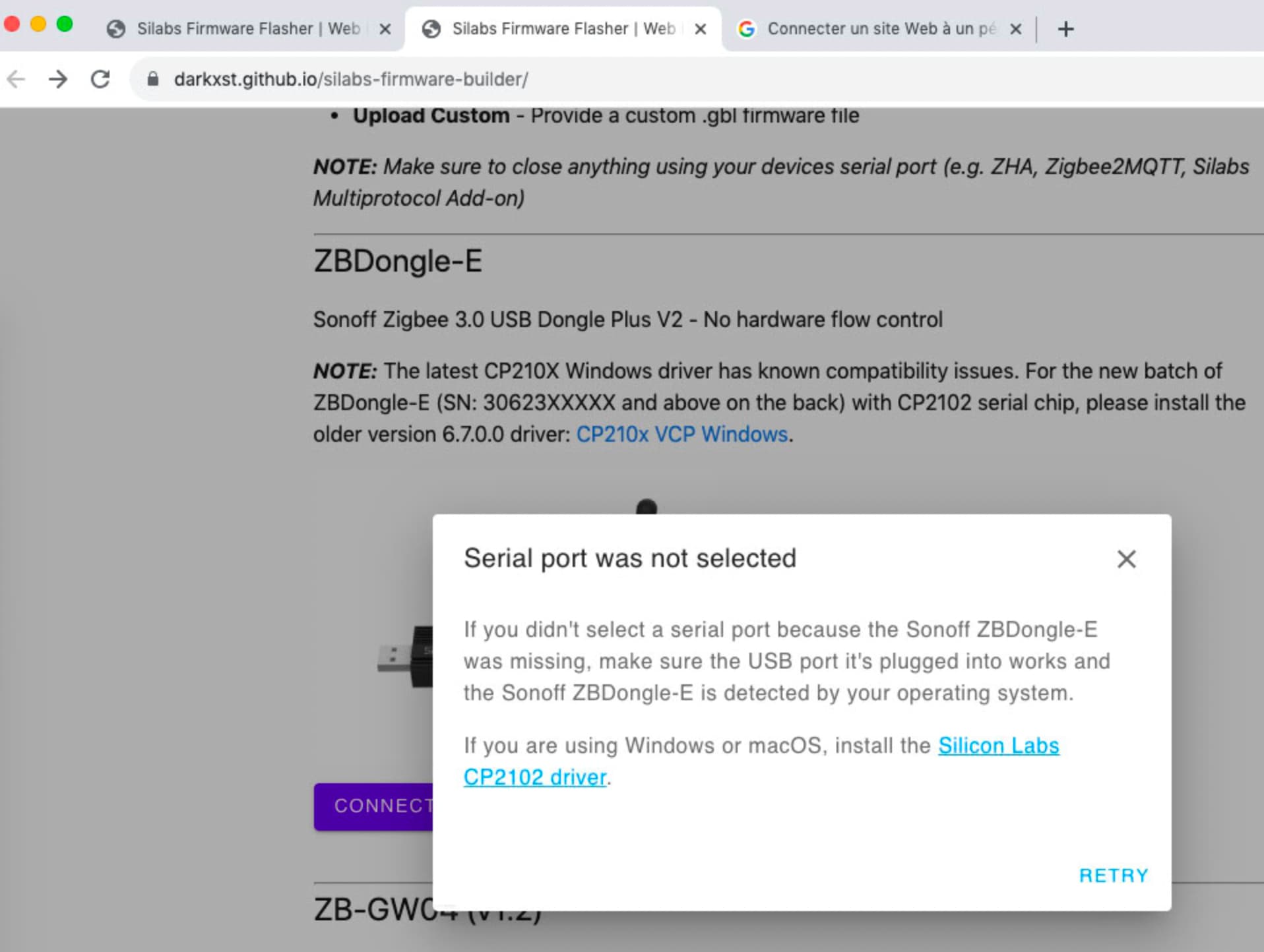

tu peux le flasher en utilisant ce site
bien faire atttention a ce detail
NOTE: The latest CP210X Windows driver has known compatibility issues. For the new batch of ZBDongle-E (SN: 30623XXXXX and above on the back) with CP2102 serial chip, please install the older version 6.7.0.0 driver: CP210x VCP Windows

OK, une chose de faite
Par contre, quand tu dis flasher, qu’est-ce que ça veut dire exactement ? Car pour information mon Home assistant est installé sur un ordinateur macOS et le logiciel virtuel box
ddfdom
Janvier 17, 2025, 11:50
4

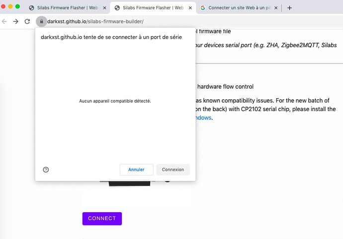

ça veut dire qu’il faut mettre a jour le logiciel de la clé zigbee (son firmware)
pour faire cela coupe ton virtualbox pour recupérer l’acces a la clé sur ton mac et tu vas sur le site indiqué et tu flash ta clé en ligne

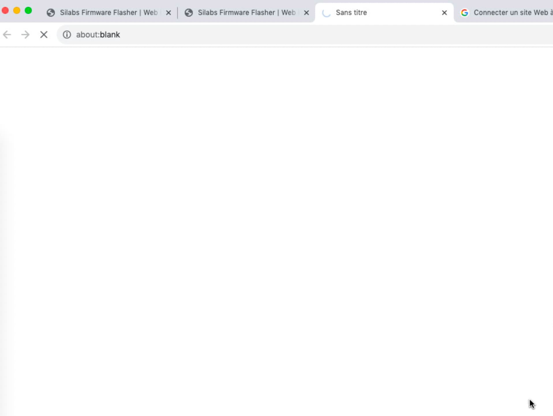

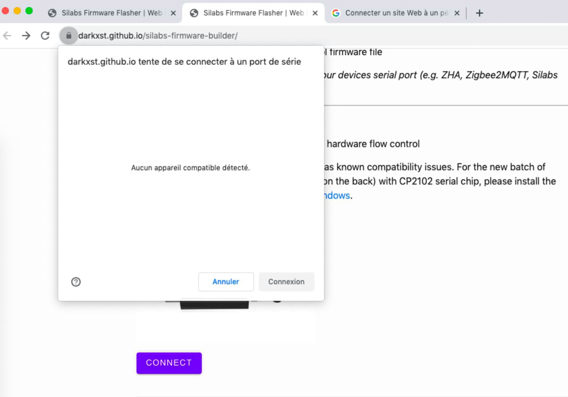

OK, j’ai donc arrêté la machine virtuelle, ensuite j’ai cliqué sur le lien fourni. Cependant je n’arrive pas à accéder à la page de téléchargement.
Pourtant, ma clé est bien détectée par macOS

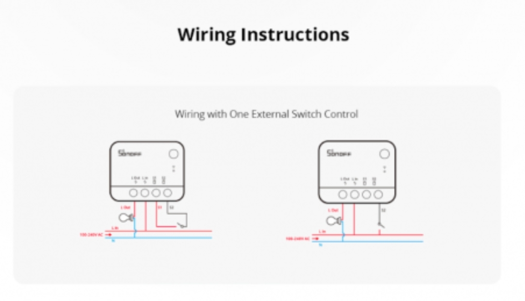

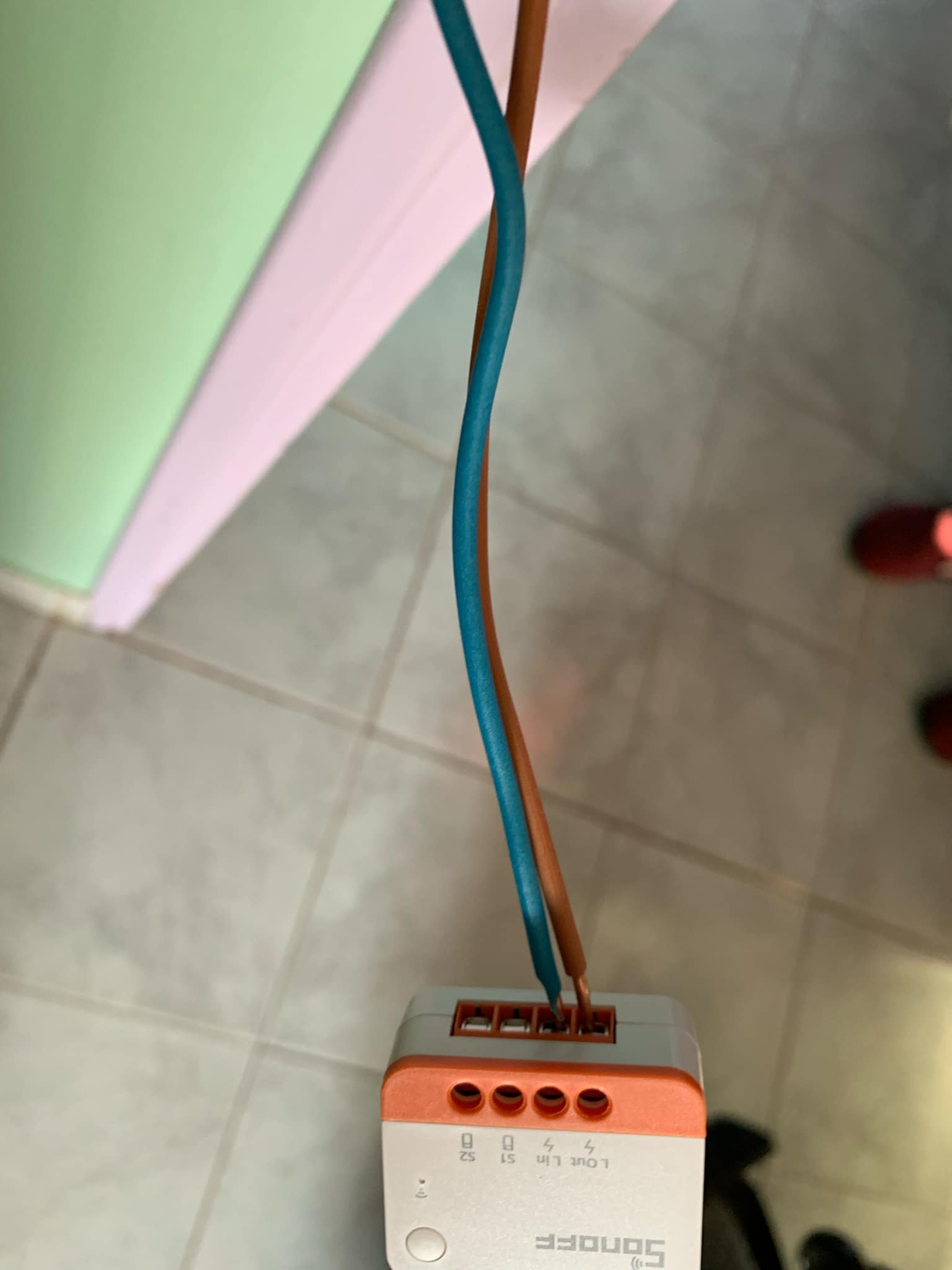

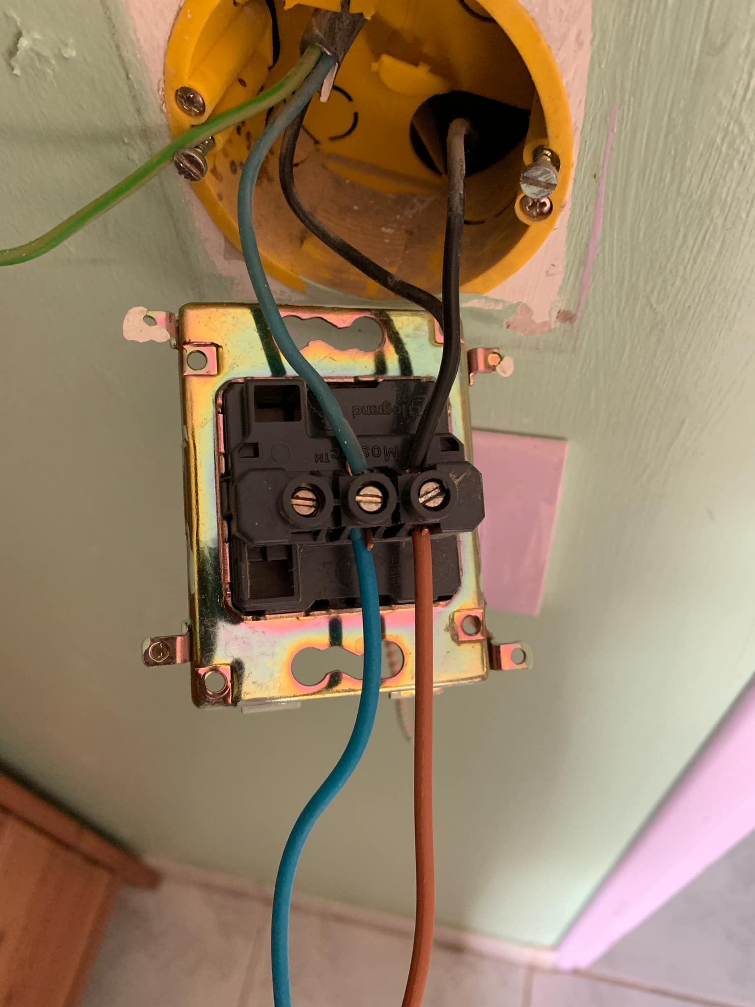

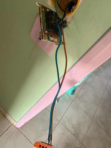

Je ne dirais rien sur la partie zigbee, @ddfdom étant bien plus calé que moi sur ce sujet mais par contre c’est quoi ce branchement sur le module ???
Recherche sur le forum zbminil2 et tu trouveras tout les schémas pour le brancher correctement.

Installe le pilote CP210x VCP Mac OSX Driver pour mac.

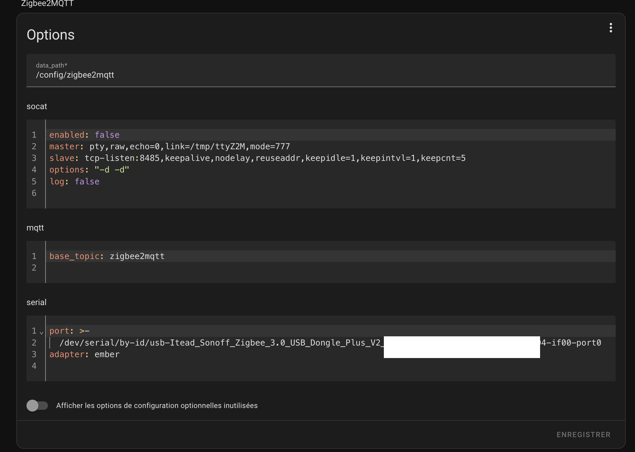

J’ai flashé la clé et ca doit etre ok
Seulement dans le journal de Zigbee2MQTT j’ai toujours ca

ddfdom
Janvier 17, 2025, 2:19
11
Tu as bien désactivé zha dans les intégrations ? Et complètement rebooté HA
sg72
Janvier 17, 2025, 2:26
12

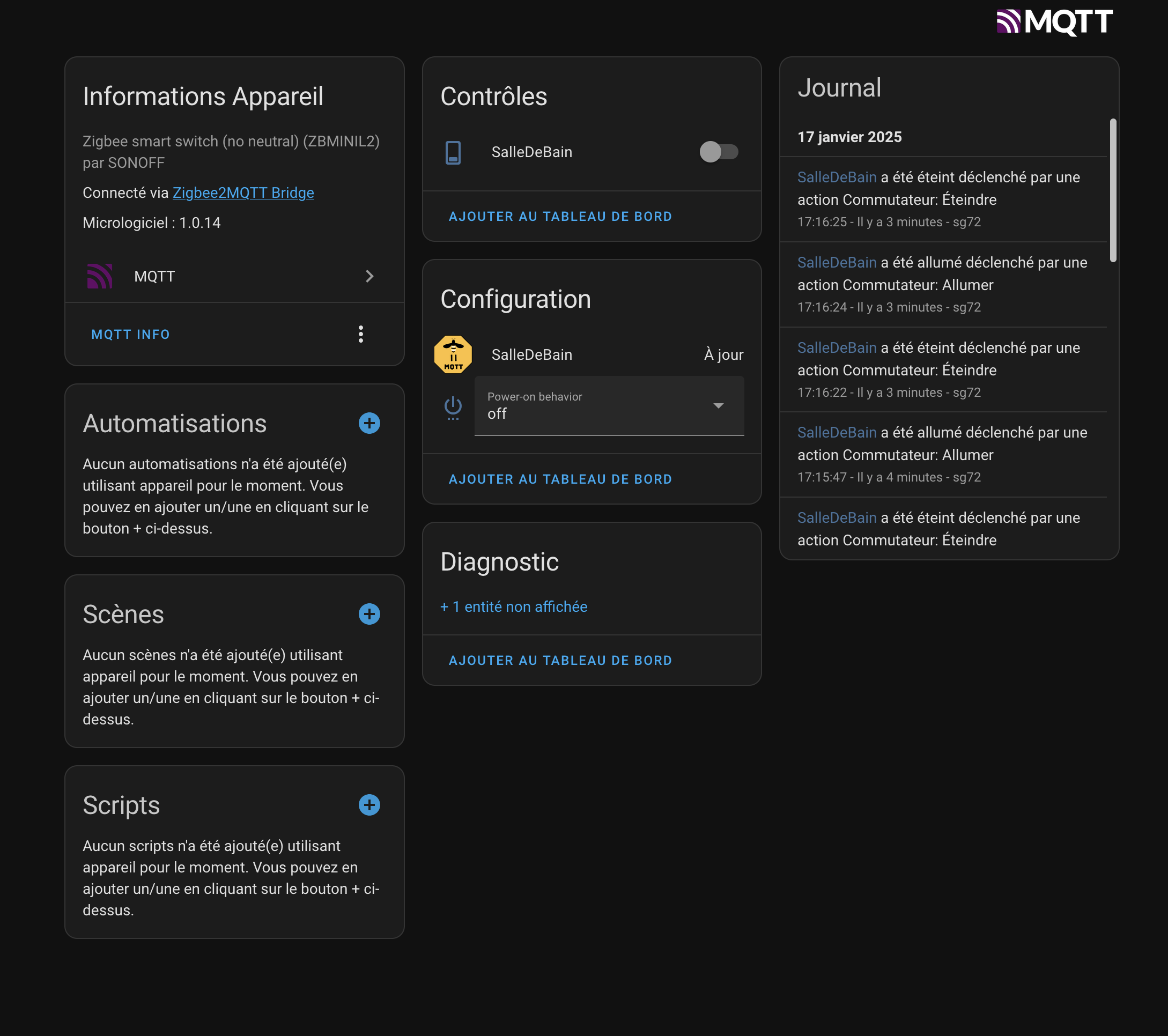

J’avais oublié de le désactiver, j’ai relancé Home Assistant et ça fonctionne
Comment je peux maintenant détecter et appareiller mon boitier zbminil2 ?

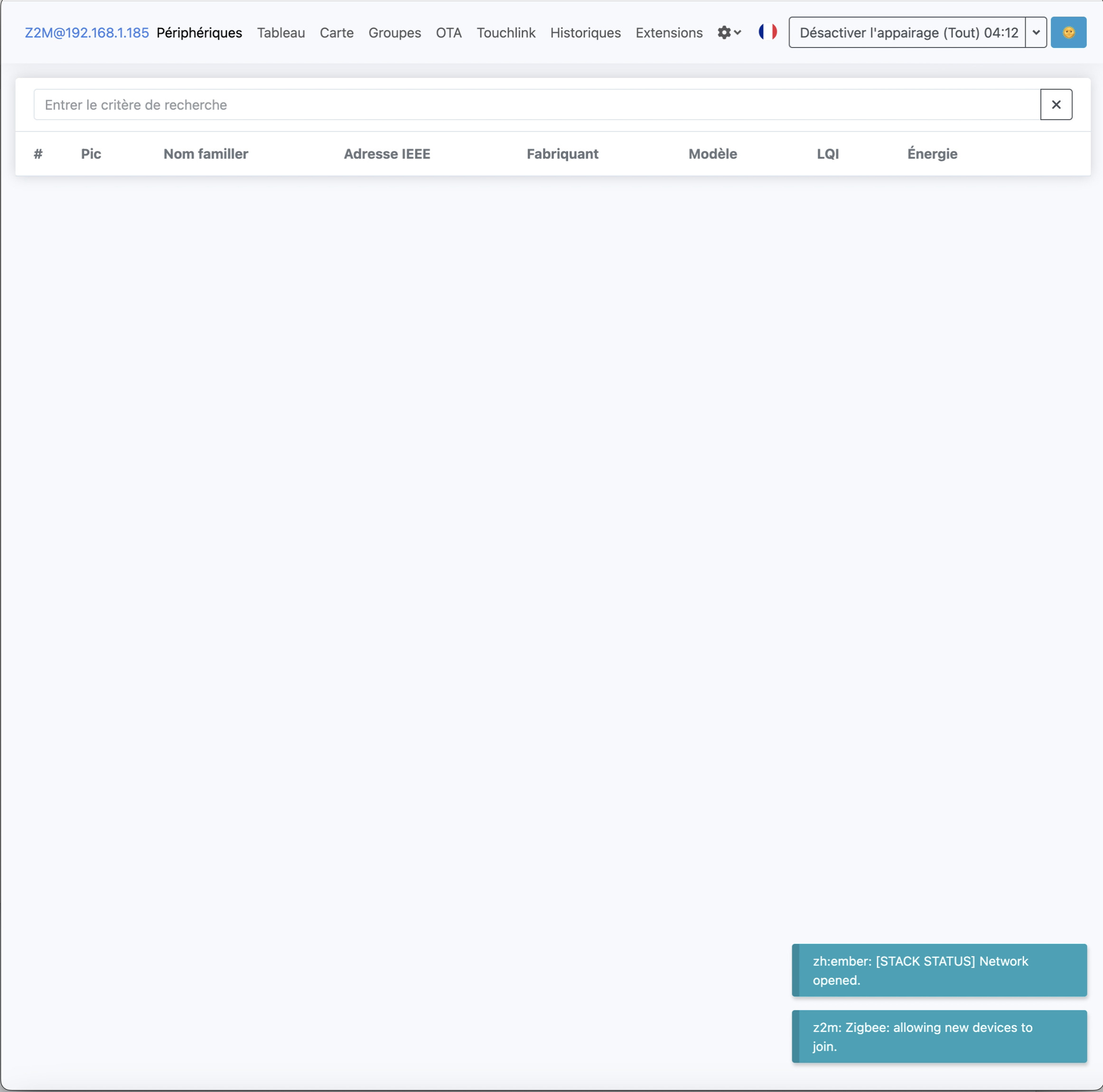

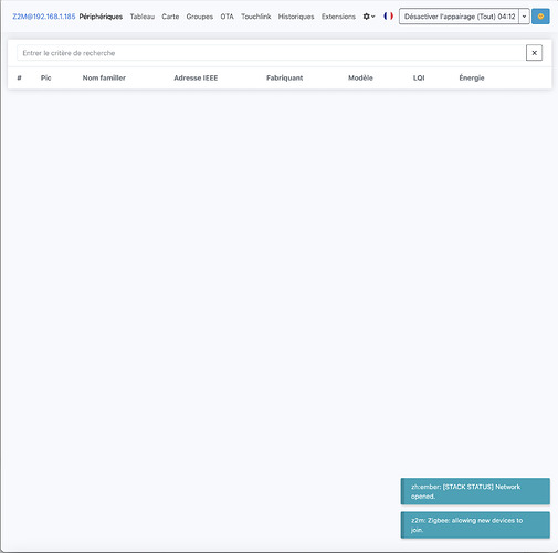

ddfdom
Janvier 17, 2025, 2:56
13
il faut passer Z2M en mode appairage
voici l’extrait de la doc (il fut au moins prendre le temps de lire la doc !!!)
Après la mise sous tension, l’appareil entrera dans le mode d’appairage par défaut lors de la première utilisation et le voyant LED vert « clignotera lentement ».
L’appareil quittera le mode d’appairage si vous ne l’utilisez pas dans les 3 minutes. Si vous souhaitez entrer à nouveau dans le mode d’appairage, appuyez et maintenez enfoncé le bouton de l’appareil pendant 5 secondes jusqu’à ce que le voyant LED vert « clignote lentement » et se relâche.
L’appareil reste éteint et ne peut pas être contrôlé par le bouton ou l’interrupteur externe de l’appareil lorsqu’il est en mode d’appairage.

sg72
Janvier 17, 2025, 4:22
15

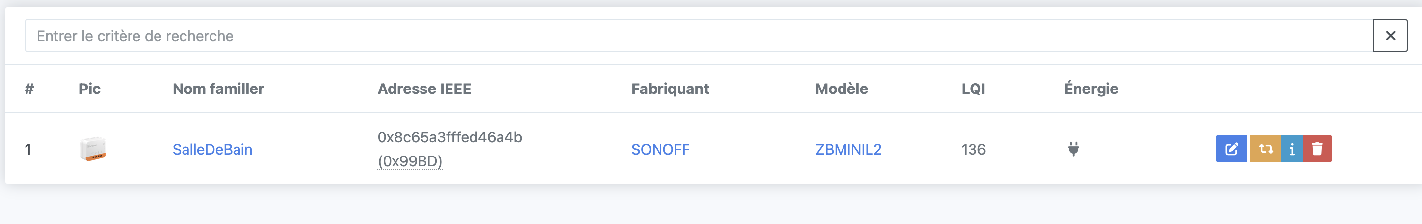

Yes ça fonctionne
Par contre je pense que j’ai mal configuré le bouton original. Effectivement si j’allume avec le bouton original, je ne peux pas éteindre avec le petit boîtier Zigbee et HA

Non tu ne peux pas parce que ton module est branché n’importe comment.
sg72
Janvier 17, 2025, 5:57
17
Je suis ma logique, le bleu et le noir qui sortent du mur à gauche, je le branche sur in et le out du ZBMINIL2.
Ensuite, je reprends un fil bleu et vert que je branche sur le S1 et S2
Et ce même fil bleu je le branche sur mon interrupteur manuel. C’est bien ça ?
Le problème est pas de suivre ta logique, mais celle du schéma.
La ton module est branché en parallèle du bouton, c’est pas le cas du schéma.

sg72:
Je suis ma logique
C’est pas ta logique qu’il faut suivre c’est le schéma de câblage.
Dejà sur ton interrupteur quelle est le fil de phase et quel est le retour lampe ?
Combien y’a t’il de lampe alimentée par cette interrupteur ? une seule ou 2 ?
