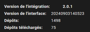

GitHub API Calls Remaining 4990
Installed Version 2.0.1
Available Repositories 1499
Downloaded Repositories 75
