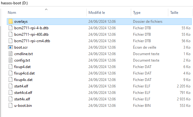

Ta essayer ?
Raspberry Pi
:information_source: Some Raspberry Pi users have reported system lockups and reboots with some Z-Wave and Zigbee USB adapters. This is an unresolved bug of the dwc_otg driver in the Raspberry Pi kernel. If your systems reboots or locks up during Z-Wave or Zigbee initialization, you can use the DWC2 driver by adding dtoverlay=dwc2 to config.txt. See #3362 for details. Only do these adjustments if your device locks up and reboots with HAOS 12.3 or newer with USB devices connected.

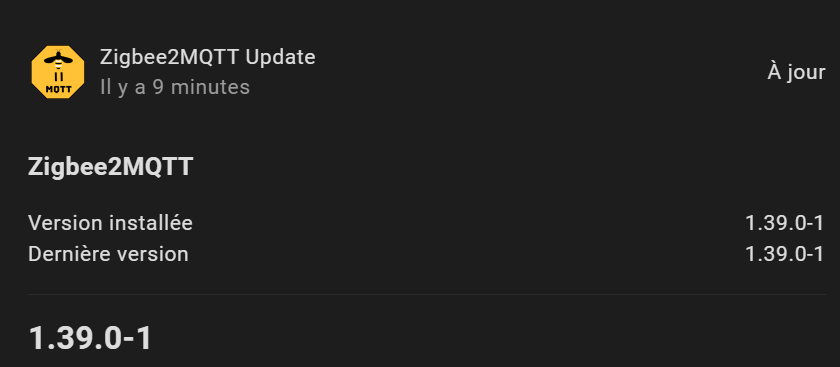

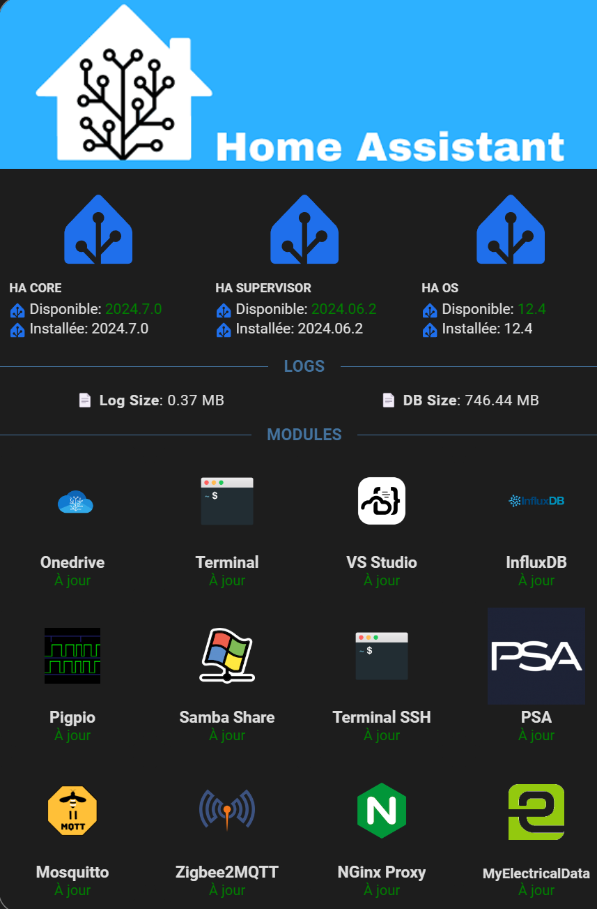

@WarC0zes Je viens de maj toute la configuration:
ET Z2M aussi (avant d’avoir vu l’alerte de ne pas le faire… mais tout semble ok pour le moment):
