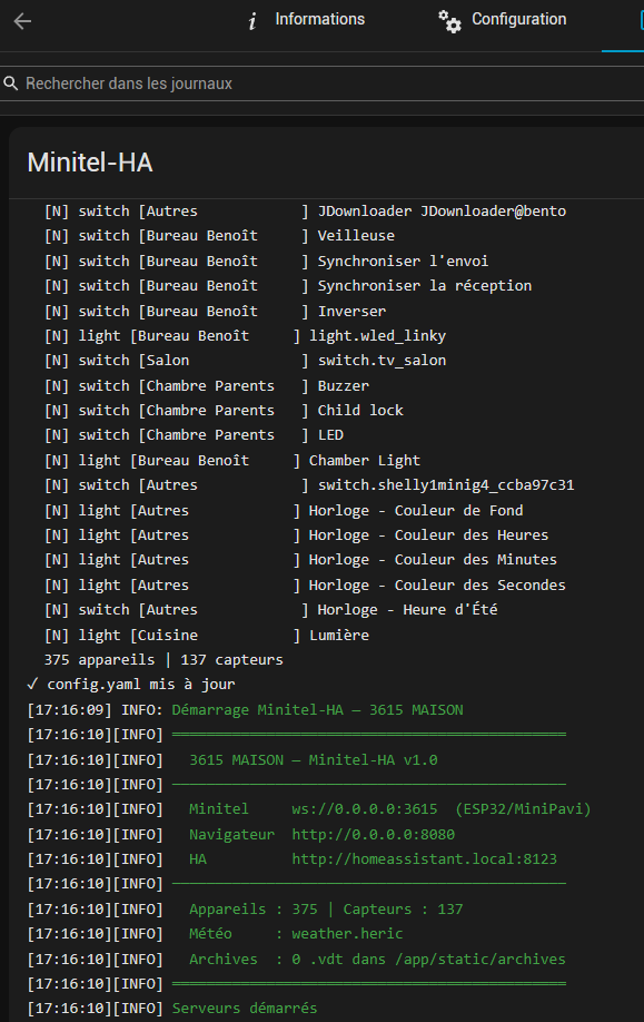

j’ai essayé sur un synology, tout se passe bien jusqu’au lancement
bash-4.4# cd /volume1/docker/
bash-4.4# git clone https://github.com/Mrt0t0/Minitel-HA
Cloning into 'Minitel-HA'...
remote: Enumerating objects: 43, done.
remote: Counting objects: 100% (43/43), done.
remote: Compressing objects: 100% (41/41), done.
remote: Total 43 (delta 11), reused 0 (delta 0), pack-reused 0 (from 0)
Receiving objects: 100% (43/43), 6.35 MiB | 21.04 MiB/s, done.
Resolving deltas: 100% (11/11), done.
bash-4.4# ls
'Disques Virtuels'   librenms   mealie       portainer        '#snapshot'            speedtest-tracker-2   stirling
 @eaDir              mariadb    Minitel-HA   portainer_agent   speedtest-tracker-1   step_ca               temp
bash-4.4# exit
bentou@DS923:/volume1/docker$ ls -lisa
total 0
    256 0 drwxrwxrwx+ 1 root     root      286 Apr 13 10:57  .
    256 0 drwxr-xr-x  1 root     root      782 Mar 20 19:47  ..
    747 0 drwxrwxrwx+ 1 root     root        0 Jun  3  2022 'Disques Virtuels'
    257 0 drwxrwxrwx+ 1 root     root       80 Mar 20 19:47  @eaDir
   2621 0 drwxrwxrwx+ 1 bentou users      48 Jul 17  2024  librenms
   2637 0 drwxrwxrwx+ 1      999 synopkgs  454 Mar 20 19:50  mariadb
    763 0 drwxrwxrwx+ 1 bentou users     128 Mar 23  2024  mealie
1103125 0 drwxrwxrwx+ 1 bentou users     340 Apr 13 11:11  Minitel-HA
   5080 0 drwxrwxrwx+ 1 bentou users     204 Oct  3  2024  portainer
  41929 0 drwxrwxrwx+ 1 bentou users      24 Oct 18  2024  portainer_agent
    256 0 drwxr-xr-x  1 root     root     3818 Apr 13 09:00 '#snapshot'
   5875 0 drwxrwxrwx+ 1 bentou users      32 Oct  2  2024  speedtest-tracker-1
   6329 0 drwxrwxrwx+ 1 bentou users      32 Oct  2  2024  speedtest-tracker-2
   4737 0 drwxrwxrwx+ 1 bentou users      82 Aug  1  2024  step_ca
   5077 0 drwxrwxrwx+ 1 bentou users      20 Aug 21  2024  stirling
   4557 0 drwxrwxrwx+ 1 root     root        0 Jul 18  2024  temp
bentou@DS923:/volume1/docker$ cd Minitel-HA/
bentou@DS923:/volume1/docker/Minitel-HA$ ls
config.yaml  docker-compose.yml  ha_client.py  pagehtml.py   README.md  server.py  utils.py       ws_minitel.py
discover.py  Dockerfile          LICENSE       pagevideo.py  screen     static     ws_browser.py
bentou@DS923:/volume1/docker/Minitel-HA$ vi config.yaml
bentou@DS923:/volume1/docker/Minitel-HA$ sudo docker compose build
Password:
[+] Building 258.4s (8/8) FINISHED
 => [minitel-ha internal] load build definition from Dockerfile                                                   12.5s
 => => transferring dockerfile: 318B                                                                               0.0s
 => [minitel-ha internal] load .dockerignore                                                                      11.2s
 => => transferring context: 2B                                                                                    0.0s
 => [minitel-ha internal] load metadata for docker.io/library/python:3.12-slim                                    14.4s
 => [minitel-ha 1/4] FROM docker.io/library/python:3.12-slim@sha256:804ddf3251a60bbf9c92e73b7566c40428d54d0e79d3  35.7s
 => => resolve docker.io/library/python:3.12-slim@sha256:804ddf3251a60bbf9c92e73b7566c40428d54d0e79d3428194edf40d  5.3s
 => => sha256:804ddf3251a60bbf9c92e73b7566c40428d54d0e79d3428194edf40da6521286 10.37kB / 10.37kB                   0.0s
 => => sha256:e31013b9573989b2dc2f0cb688044c9e650c2721dd52c54d0fd3c669d3548bb6 1.75kB / 1.75kB                     0.0s
 => => sha256:b4acd70b6f4ca3e8fa68f11d4bc6831d141744654e62286f862b3c8ca7bd0467 5.65kB / 5.65kB                     0.0s
 => => sha256:5435b2dcdf5cb7faa0d5b1d4d54be2c72a776fab9a605336f5067d6e9ecb5976 29.78MB / 29.78MB                   1.6s
 => => sha256:25981ed25cff34d7d714ea438c95731e427ea9827b771ed102d6e0fc30eeabe2 1.29MB / 1.29MB                     2.3s
 => => sha256:d4c207a1ca273594af4c026252870b4b165d536b3cb53b1246d6805e4e6b34b2 12.11MB / 12.11MB                   3.6s
 => => extracting sha256:5435b2dcdf5cb7faa0d5b1d4d54be2c72a776fab9a605336f5067d6e9ecb5976                          1.7s
 => => sha256:f0bdb572205ec70132c0fbc66a335ee5fd1614c08d686e8e921a9f55a6c38b52 250B / 250B                         4.0s
 => => extracting sha256:25981ed25cff34d7d714ea438c95731e427ea9827b771ed102d6e0fc30eeabe2                          2.6s
 => => extracting sha256:d4c207a1ca273594af4c026252870b4b165d536b3cb53b1246d6805e4e6b34b2                          1.3s
 => => extracting sha256:f0bdb572205ec70132c0fbc66a335ee5fd1614c08d686e8e921a9f55a6c38b52                          2.6s
 => [minitel-ha 2/4] RUN apt-get update -qq     && apt-get install -y --no-install-recommends git     && rm -rf  143.4s
 => [minitel-ha 3/4] RUN pip install --quiet --no-cache-dir aiohttp websockets pyyaml                             27.9s
 => [minitel-ha 4/4] WORKDIR /app                                                                                  9.2s
 => [minitel-ha] exporting to image                                                                                6.7s
 => => exporting layers                                                                                            6.0s
 => => writing image sha256:aa3818e30697bdf2d8766a0d3625cbf2b80c827bf486b719e030e928f652bb64                       0.4s
 => => naming to docker.io/library/minitel-ha-minitel-ha                                                           0.3s
bentou@DS923:/volume1/docker/Minitel-HA$ sudo docker compose up -d
[+] Running 2/2
 ✔ Network minitel-ha_default  Created                                                                                                                                            2.3s
 ✔ Container minitel-ha        Started                                                                                                                                            5.0s
bentou@DS923:/volume1/docker/Minitel-HA$ sudo docker compose up -d --build
Password:
[+] Building 28.9s (8/8) FINISHED
 => [minitel-ha internal] load .dockerignore                                                                       6.3s
 => [minitel-ha internal] load build definition from Dockerfile                                                    8.2s
 => [minitel-ha internal] load metadata for docker.io/library/python:3.12-slim                                    10.3s
 => [minitel-ha 1/4] FROM docker.io/library/python:3.12-slim@sha256:804ddf3251a60bbf9c92e73b7566c40428d54d0e79d34  0.0s
 => CACHED [minitel-ha 2/4] RUN apt-get update -qq     && apt-get install -y --no-install-recommends git     && r  0.0s
 => CACHED [minitel-ha 3/4] RUN pip install --quiet --no-cache-dir aiohttp websockets pyyaml                       0.0s
 => CACHED [minitel-ha 4/4] WORKDIR /app                                                                           0.0s
 => [minitel-ha] exporting to image                                                                                0.6s
 => => exporting layers                                                                                            0.0s
 => => writing image sha256:aa3818e30697bdf2d8766a0d3625cbf2b80c827bf486b719e030e928f652bb64                       0.1s
 => => naming to docker.io/library/minitel-ha-minitel-ha                                                           0.5s
[+] Running 1/1
 ✔ Container minitel-ha  Started                                                                                  14.6s

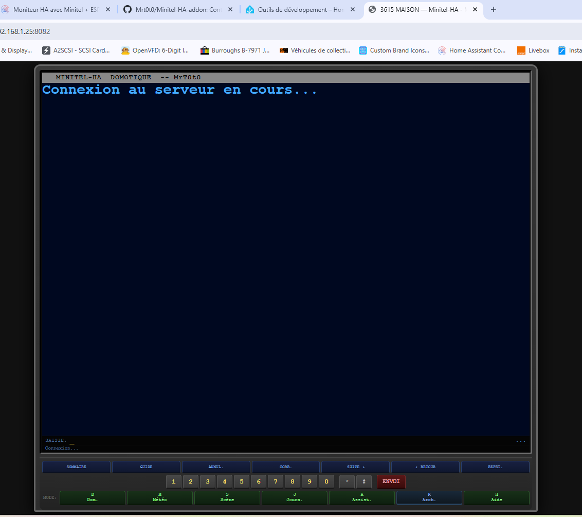

bentou@DS923:/volume1/docker/Minitel-HA$ dir
total 128
drwxrwxrwx+ 1 bentou users   362 Apr 13 13:06 .
drwxrwxrwx+ 1 root     root    286 Apr 13 10:57 ..
-rwxrwxrwx+ 1 root     root   2996 Apr 13 11:13 config.yaml
-rwxrwxrwx+ 1 root     root   4558 Apr 13 11:11 discover.py
-rwxrwxrwx+ 1 root     root    197 Apr 13 13:06 docker-compose.yml
-rwxrwxrwx+ 1 root     root    279 Apr 13 11:11 Dockerfile

mais quand il se lance, il se plante:
date	stream	content
2026/04/13 13:10:34	stderr	TypeError: 'NoneType' object is not iterable
2026/04/13 13:10:34	stderr	                                            ^^^^^^^^^^^^^^^^^^^^^^
2026/04/13 13:10:34	stderr	    'devices':    _sort_devices([d for d in cfg.get('devices', []) if d.get('visible', True)]),
2026/04/13 13:10:34	stderr	  File "/app/server.py", line 51, in <module>
2026/04/13 13:10:34	stderr	Traceback (most recent call last):
J’ai fix le discover.py autant pour moi. Tu peux retester ?
Hélas, j’ai exactement le meme message.
Supprimer l’ensemble des fichiers, repartir de 0 et git clone ou plus simple ajouter en addon “apps” sur home assistant repo (pas hacs) : GitHub - Mrt0t0/Minitel-HA-addon: Minitel-HA est une passerelle entre un **Minitel physique** (via ESP32/TelnetPro Iodeo ou MiniPavi) et **Home Assistant**. · GitHub
ca a l’air concluant !!!
installé directement via Apps
il marque [17:16:10][INFO] Navigateur http://0.0.0.0:8080 alors que j’ai configuré le 8082
et on voit que le 8082 marche.
/ $ docker ps | grep minit
10b16862ca86   85b7547b/aarch64-addon-minitel_ha:1.0.0                                              "/init /app/run.sh"      17 minutes ago   Up 17 minutes           0.0.0.0:3615->3615/tcp, [::]:3615->3615/tcp, 0.0.0.0:8082->8080/tcp, [::]:8082->8080/tcp                                           addon_85b7547b_minitel_ha
par contre, j’ai pas d’autre affichage que çà, même en tapant m ou en cliquant sur meteo.
