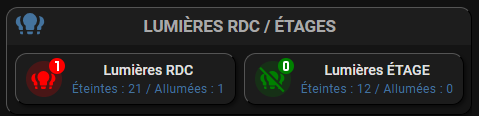

Salut, tu devrais trouver ton bonheur ici.
tu peux utiliser la carte mushroom template, et utiliser un template directement dans la carte sans passer par un template sensor.
              entity: group.grp_lumieres_rdc
              primary: Lumières RDC
              tap_action:
                action: more-info
              secondary: |
                {% set all = expand('group.grp_lumieres_rdc')| list -%}
                {% set close = all | selectattr('state','eq','off')|list|count%}
                {% set open = all | selectattr('state','eq','on')|list|count%}
                Éteintes : {{close}} / Allumées : {{open}}
              icon: |
                {% if is_state('group.grp_lumieres_rdc', 'on') %}
                  mdi:lightbulb-group
                  mdi:lightbulb-group-off
              icon_color: |
                {% if is_state('group.grp_lumieres_rdc','on') %}
                  red
                  green
              badge_icon: |-
                {% set open1 = all | selectattr('state','eq','on')|list|count%}
                {% if open1 == 0 %}
                  mdi:numeric-0
                {% elif open1 == 1 %}
                  mdi:numeric-1
                {% elif open1 == 2 %}
                  mdi:numeric-2
                {% elif open1 == 3 %}
                  mdi:numeric-3
                {% elif open1 == 4 %}
                  mdi:numeric-4
                {% elif open1 == 5 %}
                  mdi:numeric-5
                {% elif open1 == 6 %}
                  mdi:numeric-6
                {% elif open1 == 7 %}
                  mdi:numeric-7
                {% elif open1 == 8 %}
                  mdi:numeric-8
                {% elif open1 == 9 %}
                  mdi:numeric-9
                {% elif open1 == 10 %}
                  mdi:numeric-10
                {% elif open1 >= 11 %}
                  mdi:numeric-9-plus
                  none
              badge_color: |
                {% if open1 == 0 %}
                  green
                  red
              card_mod:
                style: |
                  :host {
                    --mush-badge-icon-size: 1.5em;
                    --mush-icon-symbol-size: 0.8em;
                  ha-card {
                    height: 52px !important;
                    box-shadow: 2px 2px 4px 0px rgba(0,0,0,0.5);
                    border: 1px rgba(0,0,0,1.0) outset;
