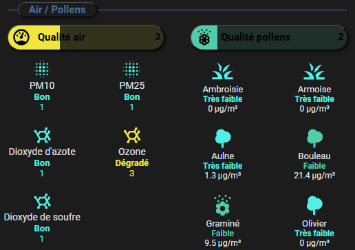

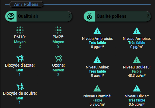

Bonjour @WarC0zes , tu saurais partager ta carte, s’il te plait ?
Merci.

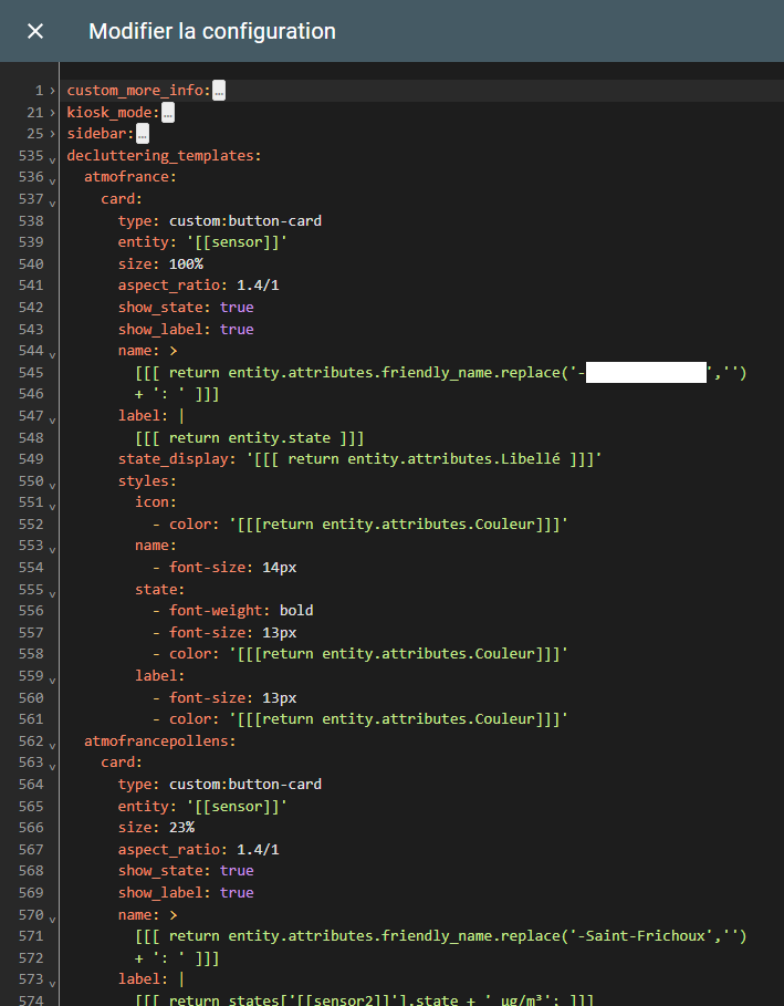

Alors, tu as les templates pour decluttering-card ( pour les installer):
decluttering_templates:
  atmofrance:
    card:
      type: custom:button-card
      entity: '[[sensor]]'
      aspect_ratio: 1.4/1
      show_state: true
      show_label: true
        [[[ return entity.attributes.friendly_name.replace('-xxxxx-xxxx','')
      label: |
        [[[ return entity.state ]]]
      state_display: '[[[ return entity.attributes.Libellé ]]]'
      styles:
        icon:
          - color: '[[[return entity.attributes.Couleur]]]'
        name:
          - font-size: 14px
        state:
          - font-weight: bold
          - font-size: 13px
        label:
          - font-size: 13px
  atmofrancepollens:
    card:
      icon: '[[icon]]'
      aspect_ratio: 1.4/1
      show_state: true
      show_label: true
        [[[ return entity.attributes.friendly_name.replace('Niveau','').replace('-xxxx-xxxxx','')
      label: |
        [[[ return states['[[sensor2]]'].state + ' µg/m³'; ]]]
      styles:
        icon:
        name:
          - font-size: 14px
        state:
          - font-weight: bold
          - font-size: 12px
        label:
          - font-size: 12px
il faut remplacer les -xxxxx-xxxx de replace('-xxxxx-xxxx','') par le nom de ta ville dans les sensors.

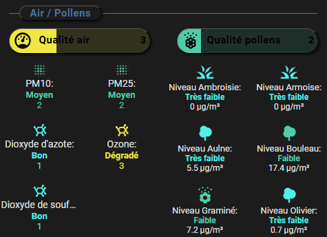

Pour la carte complète:

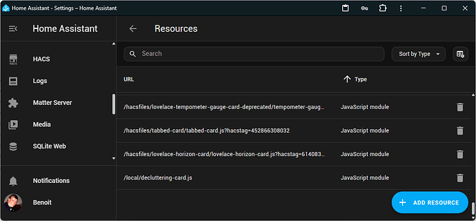

Il faut les cartes decluttering-card et button-card.

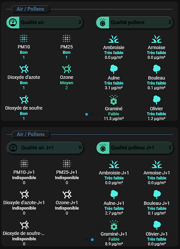

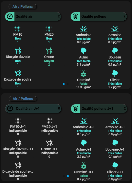

edit3:
Ajout des entités J+1 avec swipe-card
type: custom:vertical-stack-in-card
  - type: entities
      - type: custom:text-divider-row
        text: Air / Pollens
        align: left
    card_mod:
      style: |
        ha-card {
          margin-top: -10px;
          margin-bottom: -30px;
          background: none;
  - type: custom:swipe-card
    start_card: 1
    reset_after: 30
    parameters:
      pagination:
        type: bullets
      - type: horizontal-stack
          - type: vertical-stack

                      #root {
                        gap: 0px !important;
                      ha-card {
                        margin: -15px 0px -5px 5px;
                card:
                  square: false
                  type: grid
                    - type: custom:decluttering-card
                      template: atmofrancepollens
                      variables:
                        - sensor: sensor.niveau_ambroisie_xxxx
                        - sensor2: sensor.concentration_ambroisie_xxxx
                        - icon: mdi:grass
                      variables:
                        - sensor: sensor.niveau_armoise_xxxx
                        - sensor2: sensor.concentration_armoise_xxxx
                        - icon: mdi:grass
                      variables:
                        - sensor: sensor.niveau_aulne_xxxx
                        - sensor2: sensor.concentration_aulne_xxxx
                        - icon: mdi:tree
                      variables:
                        - sensor: sensor.niveau_bouleau_xxxx
                        - sensor2: sensor.concentration_bouleau_xxxx
                        - icon: mdi:tree
                      variables:
                        - sensor: sensor.niveau_gramine_xxxx
                        - sensor2: sensor.concentration_gramine_xxxx
                        - icon: mdi:flower-pollen
                      variables:
                        - sensor: sensor.niveau_olivier_xxxx
                        - sensor2: sensor.concentration_olivier_xxxx
                        - icon: mdi:tree
                  columns: 2
              - type: custom:bar-card
                  - entity: sensor.qualite_globale_xxxx_j_1
                    name: Qualité air J+1
                    icon: mdi:gauge
                    height: 35px
                    min: 0
                    max: 7
                    positions:
                      indicator: "off"
                      icon: inside
                    severity:
                      - color: "#888"
                        from: 6
                        to: 7
                      - color: "#7d2181"
                        from: 5
                        to: 6
                      - color: "#960032"
                        from: 4
                        to: 5
                      - color: "#ff5050"
                        from: 3
                        to: 4
                      - color: "#f0e641"
                        from: 2
                        to: 3
                      - color: "#50ccaa"
                        from: 1
                        to: 2
                      - color: "#50f0e6"
                        from: 0
                        to: 1
                card_mod:
                  style: |
                    bar-card-currentbar, bar-card-backgroundbar {
                      border: 1px rgba(0,0,0,1.0) outset;
                      box-shadow: 2px 2px 4px 0px rgba(0,0,0,0.5);
                    bar-card-name {
                      font-size: 15px;
                      font-weight: bold;
                      color: black;
                    ha-card {
                      margin-top: -1px;
                      background: none;
                      border: none;
                      --bar-card-border-radius: 15px;
                    bar-card-value {
                      color: black;
                      font-weight: bold;
                    ha-icon {
                      color: black;
                      --mdc-icon-size: 28px;
              - type: custom:mod-card
                card_mod:
                  style:
                    hui-grid-card $: |
                      #root {
                      ha-card {
                card:
                  square: false
                  type: grid
                      variables:
                        - sensor: sensor.pm10_xxxx_j_1
                      variables:
                        - sensor: sensor.pm25_xxxx_j_1
                      variables:
                        - sensor: sensor.dioxyde_d_azote_xxxx_j_1
                      variables:
                        - sensor: sensor.ozone_xxxx_j_1
                      variables:
                        - sensor: sensor.dioxyde_de_soufre_xxxx_j_1
                  columns: 2
                  - entity: sensor.qualite_globale_pollen_xxxx_j_1
                    name: Qualité pollens J+1
                    icon: mdi:flower-pollen-outline
                    height: 35px
                    min: 0
                    max: 7
                    positions:
                      indicator: "off"
                      icon: inside
                    severity:
                      - color: "#888"
                        from: 6
                        to: 7
                      - color: "#7d2181"
                        from: 5
                        to: 6
                      - color: "#960032"
                        from: 4
                        to: 5
                      - color: "#ff5050"
                        from: 3
                        to: 4
                      - color: "#f0e641"
                        from: 2
                        to: 3
                      - color: "#50ccaa"
                        from: 1
                        to: 2
                      - color: "#50f0e6"
                        from: 0
                        to: 1
                card_mod:
                  style: |
                    bar-card-name {
                      font-size: 15px;
                      font-weight: bold;
                      color: black;
                    ha-card {
                      margin-top: -1px;
                      background: none;
                      border: none;
                    bar-card-value {
                      color: black;
                      font-weight: bold;
                    ha-icon {
                      color: black;
                card_mod:
                  style:
                    hui-grid-card $: |
                      #root {
                      ha-card {
                card:
                  square: false
                  type: grid
                      variables:
                        - sensor: sensor.niveau_ambroisie_xxxx_j_1
                        - sensor2: sensor.concentration_ambroisie_xxxx_j_1
                        - icon: mdi:grass
                      variables:
                        - sensor: sensor.niveau_armoise_xxxx_j_1
                        - sensor2: sensor.concentration_armoise_xxxx_j_1
                        - icon: mdi:grass
                      variables:
                        - sensor: sensor.niveau_aulne_xxxx_j_1
                        - sensor2: sensor.concentration_aulne_xxxx_j_1
                        - icon: mdi:tree
                      variables:
                        - sensor: sensor.niveau_bouleau_xxxx_j_1
                        - sensor2: sensor.concentration_bouleau_xxxx_j_1
                        - icon: mdi:tree
                      variables:
                        - sensor: sensor.niveau_gramine_xxxx_j_1
                        - sensor2: sensor.concentration_gramine_xxxx_j_1
                      variables:
                        - sensor: sensor.niveau_olivier_xxxx_j_1
                        - sensor2: sensor.concentration_olivier_xxxx_j_1
                        - icon: mdi:tree
                  columns: 2
Hé Msieur @WarC0zes

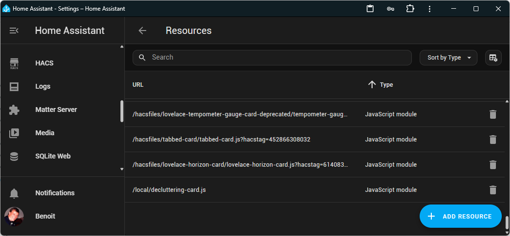

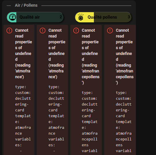

je sais bien que je suis pas doué, mais ton histoire de decluttermachin, ca coince chez moi...
j'ai copié le javascript:
[core-ssh /]$ ls -l /config/www/decluttering-card.js
-rwxr--r--    1 root     root         38511 Apr  7 16:47 /config/www/decluttering-card.js
je l'ai enregistré comme il faut (enfin, plutôt comme je le pensais)
collé ta prose dans -rw-r--r-- 1 root root 1545 Apr 7 19:40 www/custom-lovelace/decluttering_templates.yaml
et mis la carte dans un dashboard, mais ca veux pas !!!
c'est où que ca coince ???
Cannot read properties of undefined (reading 'atmofrancepollens')
variables:
  - sensor: sensor.niveau_armoise_boulogne_billancourt
  - sensor2: sensor.concentration_armoise_boulogne_billancourt
vu que les sensors et sensors2 correspondent et existent bien, il ne doit pas s'agir d'un probleme de xxx-xxx ou xxxx_xxx mal transformé...
Via HACS … c’est tellement plus simple rapide et efficace que de la faire à la main !
Comme le dit @Pulpy-Luke , il faut installer declutering card a partir de HACS .
je l’ai pas trouvé dans hacs… ???
je devais pas avoir les yeux devant les trous…
c’est installé, mais c’est pas mieux.

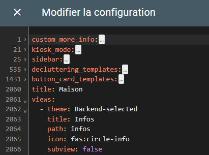

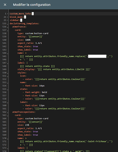

les templates decluttering se mettent dans l'éditeur de configuration
avant le views:
Merci @WarC0zes , j’ai galéré pour trouver où mettre la partie template, en fait Éditer le tableau de bord => 3 petits points en haut à droite => Éditeur de configuration et coller le code au tout début (avant la partie views) en modifiant les xxxx.xxxx.
Edit : je viens de voir ton message au dessus :wink:
