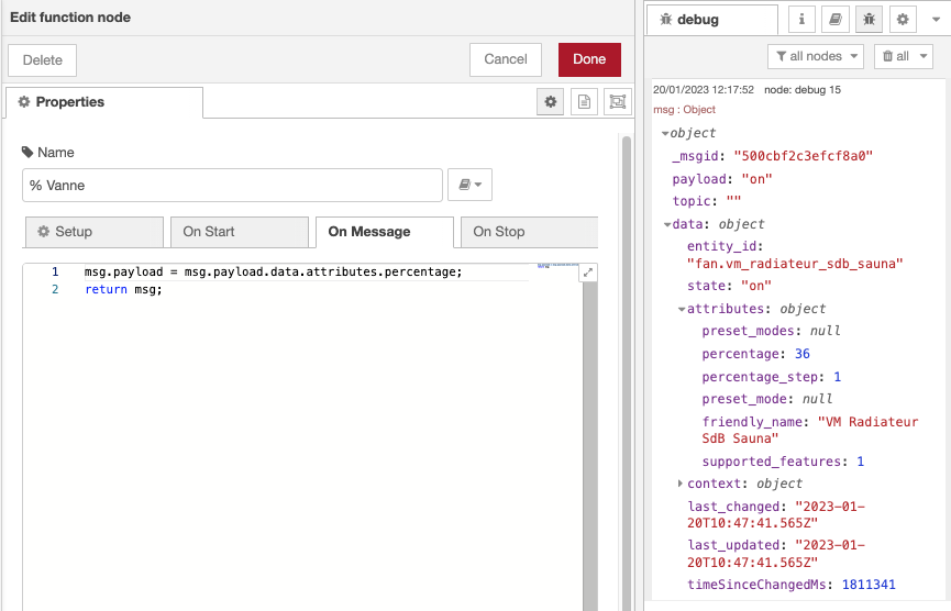

Je ne dois pas utiliser le bon chemin pour récupérer dans un node Fonction le % d’ouverture d’une vanne de radiateur (ici à 36%) mais je ne vois pas où est mon erreur…

Voici les nodes
[{"id":"ad2ea4bbc85ca2da","type":"debug","z":"27118ef16aa43549","name":"debug 12","active":false,"tosidebar":true,"console":false,"tostatus":false,"complete":"true","targetType":"full","statusVal":"","statusType":"auto","x":980,"y":280,"wires":[]},{"id":"f48117de9fe49530","type":"inject","z":"27118ef16aa43549","name":"","props":[{"p":"payload"},{"p":"topic","vt":"str"}],"repeat":"","crontab":"","once":false,"onceDelay":0.1,"topic":"","payload":"","payloadType":"date","x":100,"y":260,"wires":[["c8c9ec43f7fac170"]]},{"id":"02ce7e16f3821e53","type":"function","z":"27118ef16aa43549","name":"% Vanne","func":"msg.payload = msg.payload.data.attributes.percentage;\nreturn msg;","outputs":1,"noerr":0,"initialize":"","finalize":"","libs":[],"x":780,"y":280,"wires":[["ad2ea4bbc85ca2da"]]},{"id":"c8c9ec43f7fac170","type":"api-current-state","z":"27118ef16aa43549","name":"","server":"f1388c55.bbcd1","version":3,"outputs":1,"halt_if":"","halt_if_type":"str","halt_if_compare":"is","entity_id":"fan.vm_radiateur_sdb_sauna","state_type":"str","blockInputOverrides":false,"outputProperties":[{"property":"payload","propertyType":"msg","value":"","valueType":"entityState"},{"property":"data","propertyType":"msg","value":"","valueType":"entity"}],"for":"0","forType":"num","forUnits":"minutes","override_topic":false,"state_location":"payload","override_payload":"msg","entity_location":"data","override_data":"msg","x":410,"y":260,"wires":[["02ce7e16f3821e53","6070a013647e6c60"]]},{"id":"6070a013647e6c60","type":"debug","z":"27118ef16aa43549","name":"debug 15","active":false,"tosidebar":true,"console":false,"tostatus":false,"complete":"true","targetType":"full","statusVal":"","statusType":"auto","x":780,"y":220,"wires":[]},{"id":"f1388c55.bbcd1","type":"server","name":"Home Assistant","addon":true}]
Oui tu as une erreur, je pense que tu interprètes mal la structure de l’objet message.
c’est pas msg.payload.data.attributes.percentage mais msg.data.attributes.percentage
« Payload » est au même niveau que « Data » dans l’objet:
Bingo !!!
Du coup, la valeur passe dans le payload !
C’est tellement évident… sauf au départ jusqu’à ce que les neurones se mettent en branle. :rofl:

Là Enregistrer et restituer une valeur dans Node Red - #18 par golfvert j’indiquais que pour faire ce genre de chose, la doc et le noeud change étaient les bonnes pistes.
Pour faire cette extraction d’une valeur d’un message, il n’y a pas besoin de fonction et le debug permet de savoir quel est le « chemin » json à utiliser.
