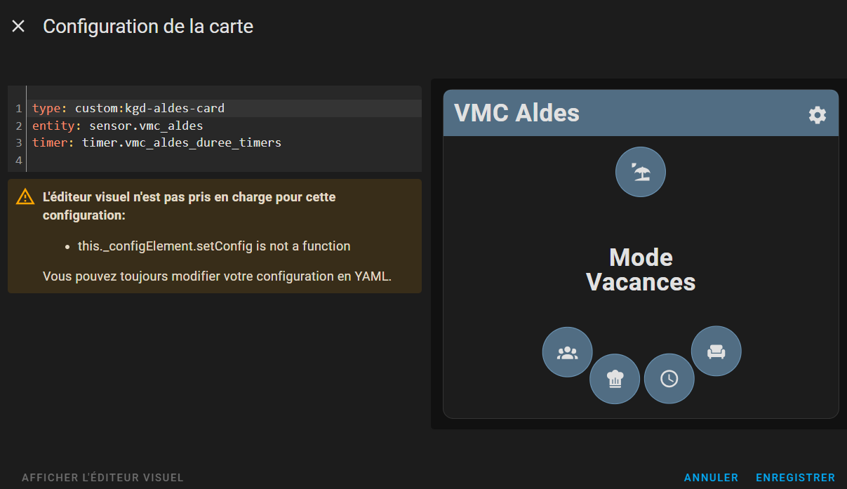

Pour commencer, mon « configuration.yaml » pour splitter les fichiers (créée un dossier packages):
## Organisation des fichiers par packages ##
homeassistant:
  packages: !include_dir_merge_named packages/
Ensuite, dans le dossier packages, j’organise mes differents yaml :
packages/aldes/aldes.yaml =>
aldes_modbus:
  modbus:
    - name: vmc_modbus
      #id: vmc_modbus
      type: serial
      baudrate: 115200
      bytesize: 8
      method: rtu
      parity: E
      # port: /dev/ttyUSB0
      port: /dev/serial/by-id/usb-FTDI_FT232R_USB_UART_A603D7VH-if00-port0
      stopbits: 1
      # delay: 5
      # timeout: 5
      # retries: 5
      # retry_on_empty: true
      sensors:
# # Identification:
  #_____________________________________________________________________________________
  #| ADDR | SIZE | NOM DATA                   | REMARQUES                         | L/E |
  #|______|______|____________________________|___________________________________|_____|
  #|    1 |    2 | Code ID Machine            | Code SAP                          |  r  |
  #|    3 |    4 | Numéro de série            |                                   |  r  |
  #|   12 |    1 | Version Logiciel           |                                   |  r  |
  #|   20 |    1 | Ordre Sauvegarde Parmètres | Mémorisation temporisée Réglages: | r-w |
  #|      |      |                            | 1s: $5678 / 5s: $1234 / 15s: $7890|     |
  # word swap
  # AABB CCDD > CCDD AABB
  # byte swap
  # AABB CCDD > BBAA DDCC
  # word byte swap
  # AABB CCDD > DDCC BBAA
        - unique_id: vmc_identification_code_id_machine
          name: "VMC Code ID Machine"
          slave: 2
          scan_interval: 3600
          data_type: int32
          address: 1
          count: 2
        - unique_id: vmc_identification_serial
          name: "VMC Numéro de série"
          slave: 2
          scan_interval: 3600
          data_type: int64
          address: 3
          count: 4
        - unique_id: vmc_identification_version_logiciel
          name: "VMC Version Logiciel"
          slave: 2
          scan_interval: 3600
          data_type: int16
          address: 12
        - unique_id: vmc_identification_ordre_sauvegarde_parametres
          name: "VMC Mémorisation Temporisée Réglages"
          slave: 2
          scan_interval: 3600
          data_type: int16
          address: 20
# # Mode de fonctionnement:
  #_________________________________________________________________________________________
  #|______|______|____________________________|_______________________________________|_____|
  #|  256 |    1 | Mode de Régulation         | 0:Auto 1:Hydro 2:VitesseConstante     | r-w |
  #|  257 |    1 | Vitesse Ventilation        | 0:Vacances 1:Normal 2:Boost 3:Invités | r-w |
  #|  258 |    1 | not used                   |                                       |     |
  #|  259 |    1 | Gestion Bypass Echangeur   | 0:Off 1:Auto 2:Optimisation Hiver     | r-w |
  #|      |      |                            | 3:Optimisation Eté 4:Ouvert           |     |
        - name: "VMC Mode de fonctionnement"
          unique_id: vmc_mode_de_fonctionnement
          # input_type: holding
          data_type: custom
          slave: 2
          address: 256
          count: 4
          scan_interval: 2
          structure: ">4h"
# # Tempo de fonctionnement:
  #|  264 |    1 | Durée Vacances             | 0:infini  nb*5min  Max:113 jours 32544| r-w |
  #|  265 |    1 | Durée pointe Cuisine       | 0:infini  nb*5min  Max:113 jours      | r-w |
  #|  266 |    1 | Durée Boost                | 0:infini  nb*5min  Max:113 jours      | r-w |
  #|  267 |    1 | Durée de vie du filtreur   | en mois   max: 255                    | r-w |
        - name: "VMC Tempo de fonctionnement"
          unique_id: vmc_tempo_de_fonctionnement
          data_type: custom
          slave: 2
          address: 264
          count: 4
          scan_interval: 5
          structure: ">4h"
# # Configuration de fonctionnement:
  #___________________________________________________________________________________________
  #|______|______|______________________________|_______________________________________|_____|
  #|  272 |    1 | Consigne Débit Extraction    |                                       | r-w |
  #|  273 |    1 | Consigne Débit Insuflation   |                                       |  r  |
  #|  274 |    1 | Consigne Pression Extraction |                                       | r-w |
  #|  275 |    1 | Consigne Pression Insuflation|                                       |  r  |
  #|  276 |    1 | Consigne Vitesse Extraction  |                                       | r-w |
  #|  277 |    1 | Consigne Vitesse Insuflation |                                       |  r  |
  #|  278 |    1 | Balance Débit                |                                       | r-w |
  #|      |      | Insuflation/Extraction       |                                       |     |
  #|  282 |    1 | Consigne Temp. Confort Eté   |                                       | r-w |
  #|  284 |    1 | Paramètre 0-10V U1           |                                       | r-w |
  #|  285 |    1 | Paramètre 0-10V U2           |                                       | r-w |
        - name: "VMC Configuration de fonctionnement"
          unique_id: vmc_configuration_de_fonctionnement
          data_type: custom
          slave: 2
          address: 272
          count: 7
          scan_interval: 10
          structure: ">7h"
        - unique_id: vmc_consigne_temp_confort_ete
          name: "VMC Consigne Temp. Confort Eté "
          slave: 2
          scan_interval: 10
          data_type: int16
          address: 282
        - name: "VMC Paramètre 0-10V"
          unique_id: vmc_0_10v
          data_type: custom
          slave: 2
          address: 284
          count: 2
          scan_interval: 3600
          structure: ">2h"
# # Principales Entrées:
  #____________________________________________________________________________________________
  #|______|______|______________________________|________________________________________|_____|
  #|  337 |    1 | Tension Alimentation         |                                        |  r  |
  #|  338 |    1 | Entrée 0-10V                 |                                        |  r  |
  #|  339 |    1 | Etats Switchs                | b0 = SW1 ... b7 = SW8                  |  r  |
  #|  344 |    1 | HIM Installateur             | IHM > b0:Clav.Eco à Membrane b1:Coeur  |  r  |
  #|  346 |    1 | % Usage Filtre               | %                                      |  r  |
  #|  347 |    1 | Temps depuis Reset           | Heures                                 |  r  |
  #|  348 |    1 | Etat ByPass                  | 0:Fermé 1:Ouvert 2:en fermeture        |  r  |
  #|      |      |                              | 3:en ouverture 4:en court-circuit      |     |
  #|      |      |                              | 5:en circuit ouvert 6:sous alimentation|     |
  #|  349 |    1 | Courant consommé par ByPass  | 0 ou >0                                |  r  |
  #|  350 |    1 | Température Air Neuf         | Sonde Température Ext. x0.01°C         |  r  |
  #|  351 |    1 | Température Air Intérieur    | Sonde Température Int. x0.01°C         |  r  |

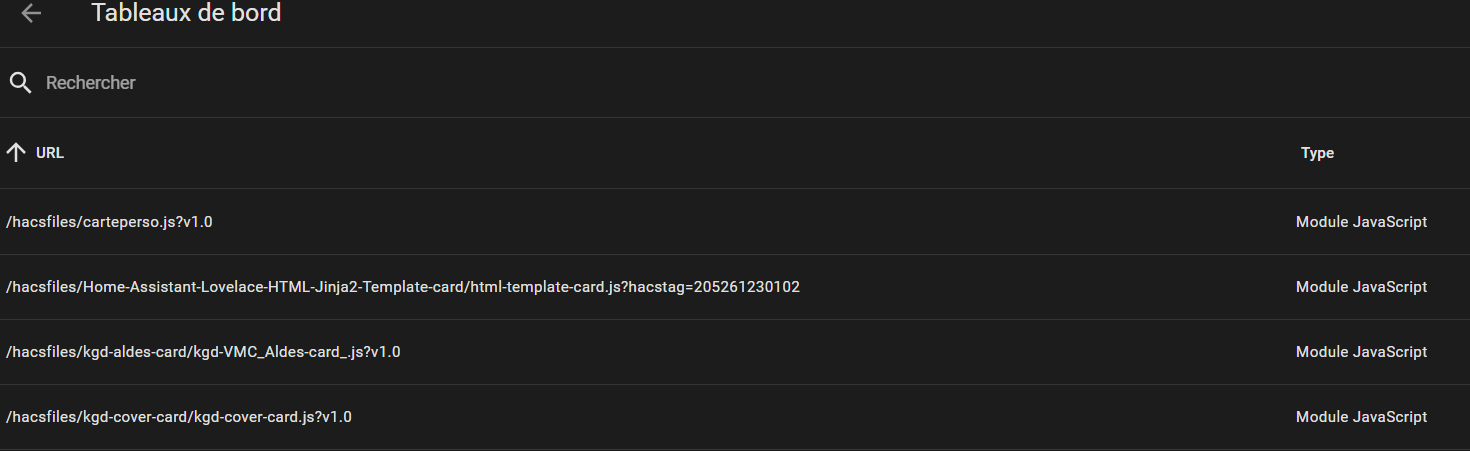

Je regroupe plusieurs infos sur une seul lecture pour éviter de surcharger les appels Modbus. Je divise les infos reçues par le suite dans le code de la carte js.
Dans le dossier www/community je crée un fichier js (kgd-VMC_Aldes-card.js) que j’intègre dans HA
code de la carte:
import { LitElement, html, css, unsafeCSS } from "https://unpkg.com/lit-element@2.5.1/lit-element.js?module";
class KGD_AldesCard extends HTMLElement {
    //Selectionnable dans lovelace
    static getConfigElement() {
        return document.createElement("KGD-Aldes-Card-Editor");
    static getStubConfig() {
        return {
            entity: "sensor.vmc_aldes",
            timer: "timer.vmc_aldes_duree_timers"

Gros travaille toujours en cours.
Je dois encore faire la consigne de température été/hivers,…
Toutes vos remarques sont les bienvenu.
Je n’ai pas réussi à trouver comment réinitialiser le filtre, du coup je le fais sur la VMC (comme j’y suis pour le changement…)
Si ce contenu peu aider :wink:
3 « J'aime »
J’oubliai, le code de la carte pour l’intégrer dans le lovelace, mais normalement elle est sélectionnable dans les cartes avec le code minimum:
type: custom:kgd-aldes-card
entity: sensor.vmc_aldes
timer: timer.vmc_aldes_duree_timer
3 « J'aime »
Bonjour @DavidC ,
Merci mille fois pour ton partage de configuration.
C’est une avancée énorme! Beau travail! :+1:
Pour info, j’ai réussi à intégrer ta carte sans soucis grâce à tes explications claires, puis j’ai bricolé une interface maison entre ma vmc DeeFlyCube300 et HA en passant par l’Ibus.
Malheureusement je n’ai pas encore trouvé la bonne configuration.
Il y a bien des échanges entre la VMC et HA mais je n’arrive pas à récupérer les bonnes données. :confounded:
Je continue à investiguer.
