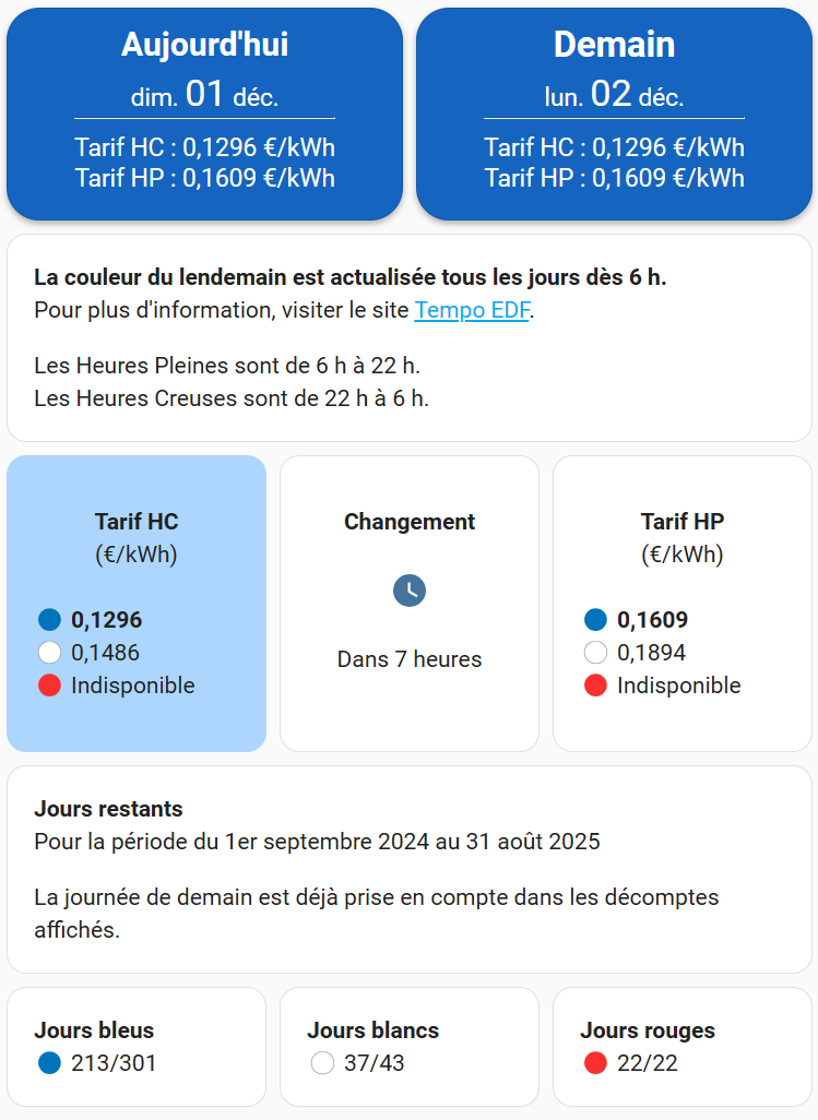

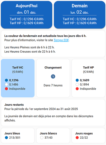

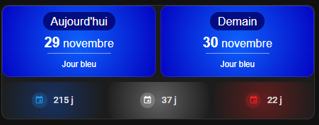

Je partage ma carte pour ceux qui le souhaite :
Capture d’écran 2024-11-29 161203
Le code:
type: custom:stack-in-card
mode: vertical
keep:
  box_shadow: true
  margin: false
  border_radius: true
  background: true
  outer_padding: false
  - type: horizontal-stack
      - type: custom:button-card
        entity: sensor.rte_tempo_couleur_actuelle
            const dateObj = new Date();
            const day = dateObj.getDate();
            const month = dateObj.toLocaleDateString('fr-FR', { month: 'long' });
            const lineColor = (entity.state === 'Blanc' || entity.state === 'inconnu') ? 'rgba(0, 0, 0, 0.5)' : 'rgba(255, 255, 255, 0.5)';
            const capsuleColor = entity.state === 'Bleu' ? 'rgba(0, 0, 102, 0.8)' : (entity.state === 'Rouge' ? 'rgba(102, 0, 0, 0.8)' : 'rgba(128, 128, 128, 0.5)');
            let displayState;
            if (entity.state === 'Bleu') displayState = 'Jour bleu';
            else if (entity.state === 'Rouge') displayState = 'Jour rouge';
            else if (entity.state === 'Blanc') displayState = 'Jour blanc';
            else displayState = 'Indéterminé';
            return `<div style="background-color: ${capsuleColor}; padding: 4px 12px; border-radius: 14px; display: inline-block; margin-bottom: 6px; color: white;">Aujourd'hui</div><br><span style="font-size: 22px; font-weight: bold;">${day}</span> ${month}<br><div style="width: 100px; height: 1px; background-color: ${lineColor}; margin: 4px auto;"></div><span style="font-size: 13px;">${displayState}</span>`;
        show_icon: false
        show_state: false
        styles:
          card:
            - background: |
                  if (entity.state === 'Bleu') return 'radial-gradient(circle, #0d61fc, #0404c2)';
                  if (entity.state === 'Blanc') return 'radial-gradient(circle, #ffffff, #cccccc)';
                  if (entity.state === 'Rouge') return 'radial-gradient(circle, #fc2121, #9c0505)';
                  return 'repeating-linear-gradient(-45deg, #dddddd, #dddddd 3px, #aaaaaa 3px, #aaaaaa 6px)';
            - display: flex
            - align-items: center
            - justify-content: center
            - text-align: center
          name:
            - color: |
                  if (entity.state === 'Rouge' || entity.state === 'Bleu') return 'white';
                  return 'black';
            - font-family: "'Helvetica Neue', Arial, sans-serif"
            - font-size: 18px
        entity: sensor.rte_tempo_prochaine_couleur
            let tomorrow = new Date();
            tomorrow.setDate(tomorrow.getDate() + 1);
            const day = tomorrow.getDate();
            const month = tomorrow.toLocaleDateString('fr-FR', { month: 'long' });
            let displayState;
            return `<div style="background-color: ${capsuleColor}; padding: 4px 12px; border-radius: 14px; display: inline-block; margin-bottom: 6px; color: white;">Demain</div><br><span style="font-size: 22px; font-weight: bold;">${day}</span> ${month}<br><div style="width: 100px; height: 1px; background-color: ${lineColor}; margin: 4px auto;"></div><span style="font-size: 13px;">${displayState}</span>`;
        show_icon: false
        show_state: false
        styles:
          card:
            - background: |
            - display: flex
          name:
            - color: |
                  return 'black';
            - font-size: 18px
      - type: custom:mushroom-entity-card
        entity: sensor.rte_tempo_cycle_jours_restants_bleu
        icon_color: blue
        icon: mdi:calendar
        layout: horizontal
        primary_info: state
        secondary_info: none
        icon_type: icon
        card_mod:
          style: |
            ha-card {
              padding: 8px 0px !important;
              display: flex;
              justify-content: center;
              align-items: center;
              background: radial-gradient(circle, rgba(13, 97, 252, 0.3), rgba(28, 28, 28, 0.3));
              border: #242424;
            mushroom-state-item {
              --icon-size: 24px !important;
        entity: sensor.rte_tempo_cycle_jours_restants_blanc
        icon_color: white
        icon: mdi:calendar
        layout: horizontal
        primary_info: state
        icon_type: icon
        card_mod:
          style: |
            ha-card {
              display: flex;
              background: radial-gradient(circle, rgba(255, 255, 255, 0.3), rgba(28, 28, 28, 0.3));
              border: #242424;
        entity: sensor.rte_tempo_cycle_jours_restants_rouge
        icon_color: "#FC2121"
        icon: mdi:calendar
        layout: horizontal
        primary_info: state
        icon_type: icon
        card_mod:
          style: |
            ha-card {
              display: flex;
              background: radial-gradient(circle, rgba(252, 33, 33, 0.3), rgba(28, 28, 28, 0.3));
              border: #242424;
            shape {
            background-color: rgba(0)!important;
3 « J'aime »
J’aime bien les dégradés, c’est joli.
Par contre on ne sait pas ce que sont les jours, à priori ceux qu’il reste, jusque quand ?
Et dans ton code comme tous les autres, entre minuit et 6h00 ta carte est buggé !
Il t’indique aujourd’hui qui est la couleur de hier et demain qui est celle d’aujourd’hui avec des mauvaises couleurs.
J’ai mis en gras les couleurs du jour.

  - type: markdown
    content: "**La couleur du lendemain est actualisée tous les jours dès 6\_h.**\nPour plus d'information, visiter le site [Tempo EDF](https://particulier.edf.fr/fr/accueil/gestion-contrat/options/tempo.html#/).\n\nLes Heures Pleines sont de 6\_h à 22\_h.\nLes Heures Creuses sont de 22\_h à 6\_h.\n"
  - type: grid
    square: false
    columns: 1
          - type: markdown
            card_mod:
              style:
                ha-markdown: |
                  ha-card
                    {% if is_state('binary_sensor.rte_tempo_heures_creuses', 'on') %}
                      border-style: solid;
                      border-radius: 12px;
                      border-color: #ADD6FF;
                      background: #ADD6FF;
            content: >-
              {# Calcul HC Bleu #}
              {% set tarifs_hc_bleu = 'Indisponible' %}
              {% set unit_hc_bleu = '' %}
              {% set tarifs_hc_val_bleu =
              states['input_number.tarif_tempo_heures_creuses_ttc_bleu'].state %}
              {% if tarifs_hc_val_bleu != '0.0' %}
              {% set tarifs_hc_bleu = tarifs_hc_val_bleu.replace('.', ',') %}
              {# {% set unit_hc_bleu = states['input_number.tarif_tempo_heures_creuses_ttc_bleu'].attributes['unit_of_measurement'] %} #}
              {# Calcul HC Blanc #}
              {% set tarifs_hc_blanc = 'Indisponible' %}
              {% set unit_hc_blanc = '' %}
              {% set tarifs_hc_val_blanc = states['input_number.tarif_tempo_heures_creuses_ttc_blanc'].state %}
              {% if tarifs_hc_val_blanc != '0.0' %}
              {% set tarifs_hc_blanc = tarifs_hc_val_blanc.replace('.', ',') %}
              {# {% set unit_hc_blanc = states['input_number.tarif_tempo_heures_creuses_ttc_blanc'].attributes['unit_of_measurement'] %} #}
              {# Calcul HC Rouge #}
              {% set tarifs_hc_rouge = 'Indisponible' %}
              {% set unit_hc_rouge = '' %}
              {% set tarifs_hc_val_rouge = states['input_number.tarif_tempo_heures_creuses_ttc_rouge'].state %}
              {% if tarifs_hc_val_rouge != '0.0' %}
              {% set tarifs_hc_rouge = tarifs_hc_val_rouge.replace('.', ',') %}
              {# {% set unit_hc_rouge = states['input_number.tarif_tempo_heures_creuses_ttc_rouge'].attributes['unit_of_measurement'] %} #}
              **<center>Tarif HC</center>**
              <center>({{ states['input_number.tarif_tempo_heures_creuses_ttc_bleu'].attributes['unit_of_measurement'] }})</center>
              <br/>
              🔵 {% if states['sensor.rte_tempo_couleur_actuelle'].state == 'Bleu' %}<b>{{ tarifs_hc_bleu }} {{ unit_hc_bleu }}</b>{% else %}{{ tarifs_hc_bleu }} {{ unit_hc_bleu }}{% endif %}<br/>
              ⚪️ {% if states['sensor.rte_tempo_couleur_actuelle'].state == 'Blanc' %}<b>{{ tarifs_hc_blanc }} {{ unit_hc_blanc }}</b>{% else %}{{ tarifs_hc_blanc }} {{ unit_hc_blanc }}{% endif %}<br/>
              🔴 {% if states['sensor.rte_tempo_couleur_actuelle'].state == 'Rouge' %}<b>{{ tarifs_hc_rouge }} {{ unit_hc_rouge }}</b>{% else %}{{ tarifs_hc_rouge }} {{ unit_hc_rouge }}{% endif %}<br/>
          - type: markdown
            content: >-
              {% set rel = ((as_timestamp(states['sensor.rte_tempo_heures_creuses_changement'].state) | float) - as_timestamp(now())) %}
              {% set duration = 'Maintenant' %}
              {% if (rel / 3600.0) >= 2.0 %}
              {% set duration = 'Dans ' + ((rel / 3600.0) | round(0) | string) + ' heures' %}
              {% elif (rel / 3600.0) >= 1.0 %}
              {% set duration = 'Dans une heure' %}
              {% elif rel / 3600.0 > 0.0 and ((rel / 60.0) | round(0)) > 1.0 %}
              {% set duration = 'Dans ' + ((rel / 60.0) | round(0) | string) + ' minutes' %}
              {% elif rel / 3600.0 > 0.0 %}
              {% set duration = 'Dans une minute' %}
              **<center>Changement</center>**
              <br/>
              <center><font color="#44739E"><ha-icon icon="mdi:clock"></ha-icon></font><br/></center>
              <br/>
              <center>{{ duration }}</center>
          - type: markdown
            card_mod:
              style:
                ha-markdown: |
                  ha-card
                    {% if is_state('binary_sensor.rte_tempo_heures_creuses', 'off') %}
                      border-color: #FFB6AD;
                      background: #FFB6AD;
            content: >-
              {# Calcul HP Bleu #}
              {% set tarifs_hp_bleu = 'Indisponible' %}
              {% set unit_hp_bleu = '' %}
              {% set tarifs_hp_val_bleu = states['input_number.tarif_tempo_heures_pleines_ttc_bleu'].state %}
              {% if tarifs_hp_val_bleu != '0.0' %}
              {% set tarifs_hp_bleu = tarifs_hp_val_bleu.replace('.', ',') %}
              {# {% set unit_hp_bleu = states['input_number.tarif_tempo_heures_pleines_ttc_bleu'].attributes['unit_of_measurement'] %} #}
              {% set tarifs_hp_blanc = 'Indisponible' %}
              {# Calcul HP Blanc #}
              {% set unit_hp_blanc = '' %}
              {% set tarifs_hp_val_blanc = states['input_number.tarif_tempo_heures_pleines_ttc_blanc'].state %}
              {% if tarifs_hp_val_blanc != '0.0' %}
              {% set tarifs_hp_blanc = tarifs_hp_val_blanc.replace('.', ',') %}
              {# {% set unit_hp_blanc = states['input_number.tarif_tempo_heures_pleines_ttc_blanc'].attributes['unit_of_measurement'] %} #}
              {% set tarifs_hp_rouge = 'Indisponible' %}
              {# Calcul HP Rouge #}
              {% set unit_hp_rouge = '' %}
              {% set tarifs_hp_val_rouge = states['input_number.tarif_tempo_heures_pleines_ttc_rouge'].state %}
              {% if tarifs_hp_val_rouge != '0.0' %}
              {% set tarifs_hp_rouge = tarifs_hp_val_rouge.replace('.', ',') %}
              {# {% set unit_hp_rouge = states['input_number.tarif_tempo_heures_pleines_ttc_rouge'].attributes['unit_of_measurement'] %} #}
              **<center>Tarif HP</center>**
              <center>({{ states['input_number.tarif_tempo_heures_pleines_ttc_bleu'].attributes['unit_of_measurement'] }})</center>
              <br/>
              🔵 {% if states['sensor.rte_tempo_couleur_actuelle'].state == 'Bleu' %}<b>{{ tarifs_hp_bleu }} {{ unit_hp_bleu }}</b>{% else %}{{ tarifs_hp_bleu }} {{ unit_hp_bleu }}{% endif %}<br/>
              ⚪️ {% if states['sensor.rte_tempo_couleur_actuelle'].state == 'Blanc' %}<b>{{ tarifs_hp_blanc }} {{ unit_hp_blanc }}</b>{% else %}{{ tarifs_hp_blanc }} {{ unit_hp_blanc }}{% endif %}<br/>
              🔴 {% if states['sensor.rte_tempo_couleur_actuelle'].state == 'Rouge' %}<b>{{ tarifs_hp_rouge }} {{ unit_hp_rouge }}</b>{% else %}{{ tarifs_hp_rouge }} {{ unit_hp_rouge }}{% endif %}<br/>
  - type: markdown
    content: |-
      {% set n = now() %}
      {% set year = n.year %}
      {% if n.month < 9 %}
      {% set year = year - 1 %}
      **Jours restants**
      Pour la période du 1er septembre {{ year }} au 31 août {{ year + 1 }}
      La journée de demain est déjà prise en compte dans les décomptes affichés.
      - type: markdown
        content: |
          **Jours bleus**
          🔵 {{states('sensor.rte_tempo_cycle_jours_restants_bleu')}}/301
      - type: markdown
        content: |
          **Jours blancs**
          ⚪️ {{states('sensor.rte_tempo_cycle_jours_restants_blanc')}}/43
      - type: markdown
        content: |
          **Jours rouges**
          🔴 {{states('sensor.rte_tempo_cycle_jours_restants_rouge')}}/22
columns: 1

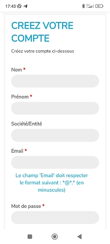

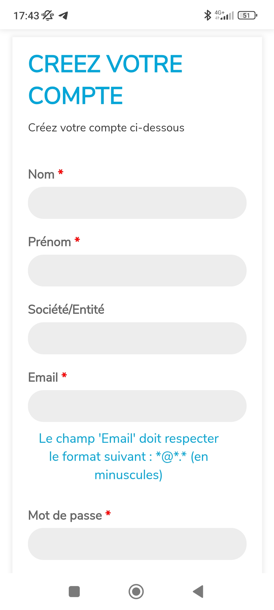

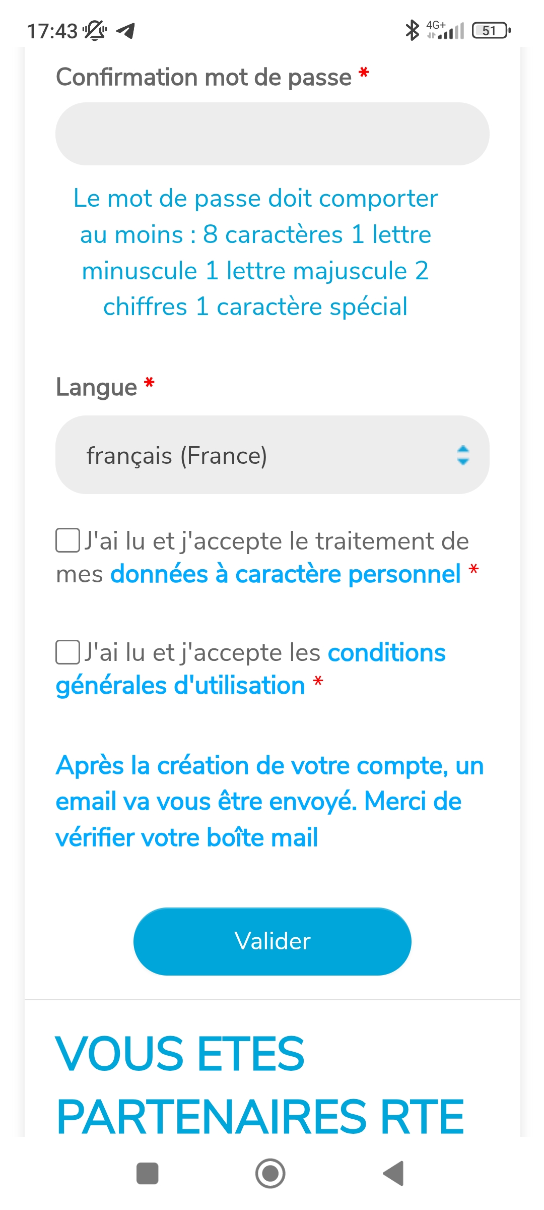

Es-ce qu’il y a un soucis avec le site RTE svp ?
  • je créé le compte comme indiqué sur le tuto en lien sur le 1er message.
  • j’essaye de me connecter avec ce compte, ça me dit que le mot de passe et/ou l’adresse mail sont incorrects. (Je ne reçois aucune confirmation d’inscription au fait, bizarrement)
  • j’essaye de récupérer mon mot de passe via « mot de passe oublié » ça me dit que le compte n’existe pas…
J’ai tenté avec une autre adresse mail, Idem.
Chez moi pas de soucis en ce moment
Pas de souci:

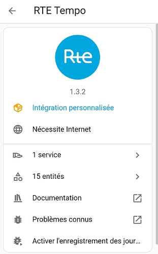

tu utilise cette version:
Je parlais surtout de la phrase d’inscription sur rte
Aucun retour d’inscription, aucun mail de confirmation, aucun moyen de récupérer le mot de passe du compte déjà créé etc
Ok, desolé. Je me suis inscrit en 2023 en suivant la procédure du github.
Je me souviens plus si il y avait une quelconque confirmation. Mais de mémoire pas de souci lors de l’inscription.
Bonjour, j’ai créé mon compte chez RTE relativement récemment (en octobre 2024), et j’ai bien reçu 2 mails : le 1er pour finaliser l’inscription et le 2nd pour me confirmer l’activation de mon compte…
Le 2nd ne vient que si on a validé par le 1er…
Tu as regardé dans tes spams ?
Il n’y a rien de nommé RTE dans les spams ni ailleurs :face_with_diagonal_mouth:
Tu as bien respecté leurs indications (pour la rédaction, notamment pour le mot de passe).
Oui, comme sur la plupart des sites…
Bon, j’ai fini par crée le compte avec une 3eme adresse mail, c’est un mystère.
Il ne trouvais pas mon adresse mail d’inscription, si je re-créais un compte il me disait qu’un compte avec ces identifiants existait déjà, quand je demandait un nouveau mot de passe sur ledit compte il me disait pas de compte avec cette adresse… truc de fou, lol.
Du coup c’est bon avec le 3eme mail, va comprendre… :joy:

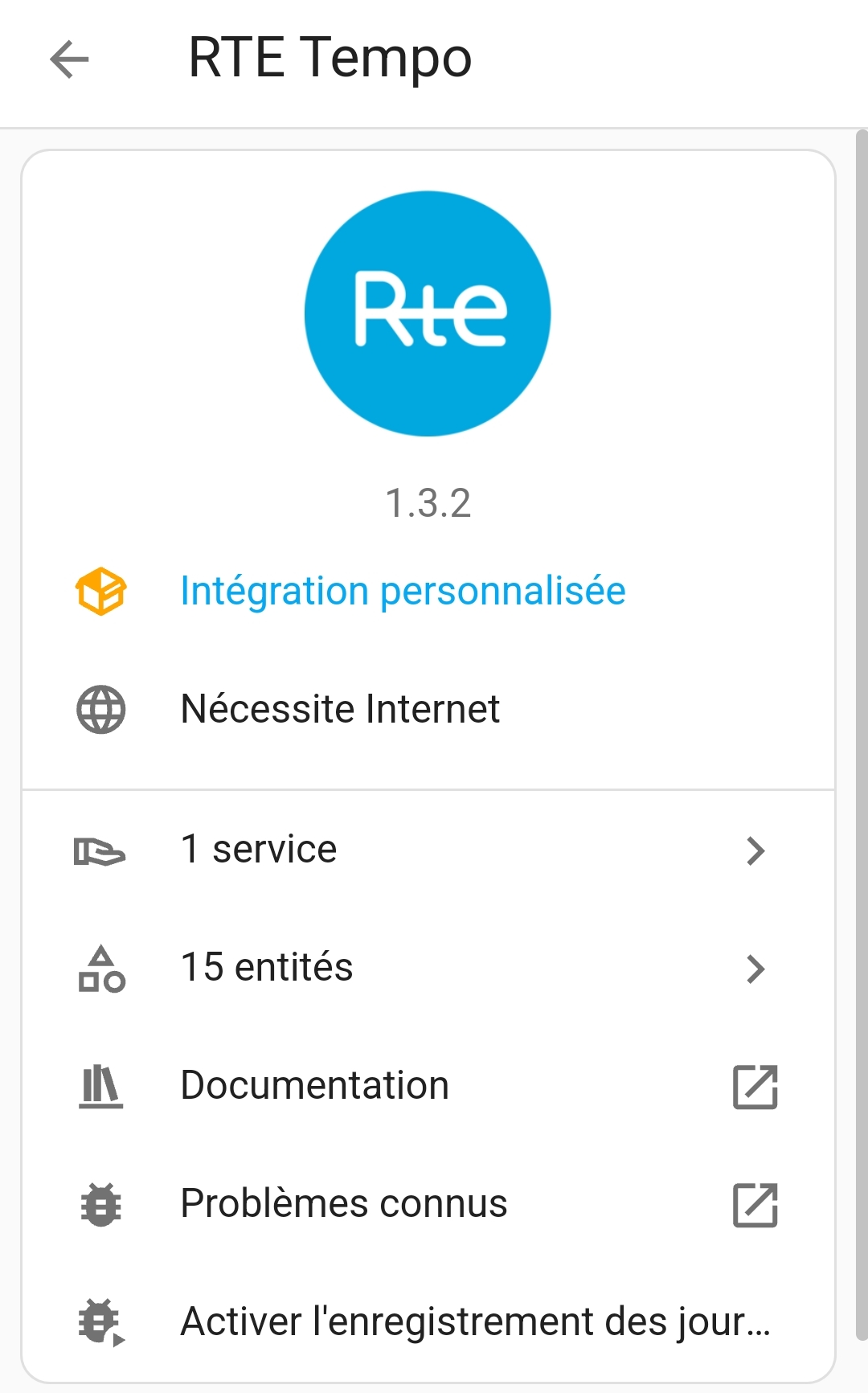

Bon, delphiki a mise à jour son intégration !!
Super boulot !
Voir le lien : Récupération des tarifs EDF Tempo via son compte EDF (Browserless Chromium) - #4 par delphiki
Du coup, je change ma carte pour prendre en compte ces changements.
Suppression de tous les input_number ainsi que de l’automatisation qui n’a jamais correctement fonctionnée.
Voici le nouveau code :
square: false
type: grid
            var firstDay = "Aujourd'hui";
            if (new Date().getHours() < 12 && states['binary_sensor.rte_tempo_heures_creuses'].state === 'on')
            { // Jusque midi pour se mettre à jour (passer en HC) !
              // Sans cette gestion, entre 0h00 et 6h00 les jours sont faux, c'est demain !
              firstDay = "Hier";
          return firstDay;
        show_label: true
        label: |
            var date = new Date();
            if (date.getHours() < 12 && states['binary_sensor.rte_tempo_heures_creuses'].state === 'on')
              // sont faux, c'est demain !
              date.setDate(date.getDate() - 1);
            var dayOfWeek = date.toLocaleString('fr-FR', { weekday: 'short' });
            var day = ('0' + date.getDate()).slice(-2);
            var month = date.toLocaleString('fr-FR', { month: 'short' });
            var color = states['sensor.rte_tempo_couleur_actuelle'].state;
            var color_text = (color === 'unavailable') ? "(Non disponible)" : "Jour " + color;
            // Tarifs
            var tarifs_hc = 'Non disponible';
            var tarifs_hc_unit = '';
            var tarifs_hp = 'Non disponible';
            var tarifs_hp_unit = '';
            if (color !== 'unavailable')
               var tarifs_hc_val = (states['sensor.tarif_' + color.toLowerCase() + '_tempo_heures_creuses_ttc'].state);
               if (tarifs_hc_val != 0.0)
                  tarifs_hc_unit = states['sensor.tarif_' + color.toLowerCase() + '_tempo_heures_creuses_ttc'].attributes['unit_of_measurement'];
                  tarifs_hc = tarifs_hc_val.replace('.', ',');
               var tarifs_hp_val = (states['sensor.tarif_' + color.toLowerCase() + '_tempo_heures_pleines_ttc'].state);
               if (tarifs_hp_val != 0.0)
                  tarifs_hp_unit = states['sensor.tarif_' + color.toLowerCase() + '_tempo_heures_pleines_ttc'].attributes['unit_of_measurement'];
                  tarifs_hp = tarifs_hp_val.replace('.', ',');
            return `${dayOfWeek} <span style="font-size: 1.5em;">${day}</span> ${month}<hr style="margin: 1px 0 8px; border-top: 1px solid rgba(0, 0, 0, 0.2);">Tarif HC : ${tarifs_hc} ${tarifs_hc_unit}<br/>Tarif HP : ${tarifs_hp} ${tarifs_hp_unit}`;
        styles:
          card:
            - height: 130px
            - background-color: |
                  var color = states['sensor.rte_tempo_couleur_actuelle'].state.toLowerCase();
                  return (color === 'rouge') ? '#c62828' :
                        (color === 'blanc') ? '#ffffff' :
                        (color === 'bleu') ? '#1565c0' :
                        'var(--card-background-color)';
            - color: |
                  return (states['sensor.rte_tempo_couleur_actuelle'].state.toLowerCase() === 'blanc') ? 'black' : 'white';
            - border-radius: 20px
            - padding: 16px
            - font-size: 1.2em
            - box-shadow: 0px 2px 4px 0px rgba(0,0,0,0.3)
          grid:
            - grid-template-areas: "\"n\" \"l\""
            - grid-template-rows: 1fr min-content
          name:
            - font-weight: bold
            - font-size: 1.2em
          label:
            - font-size: 0.9em
            - justify-self: center
            - align-self: center
            - margin-top: 10px
            var secondDay = "Demain";
              secondDay = "Aujourd'hui";
          return secondDay;
        show_label: true
        label: |
            date.setDate(date.getDate() + 1);
              // sont faux, c'est après demain !
            var color = states['sensor.rte_tempo_prochaine_couleur'].state;
            // Tarifs
        styles:
          card:
            - height: 130px
                  var color = states['sensor.rte_tempo_prochaine_couleur'].state.toLowerCase();
                        (color === 'blanc') ? '#fFfFfF' :
                        (color === 'unavailable') ? 'orange' :
            - color: |
                  return (states['sensor.rte_tempo_prochaine_couleur'].state.toLowerCase() === 'blanc') ? 'black' : 'white';
            - padding: 16px
            - font-size: 1.2em
          grid:
          name:
            - font-weight: bold
            - font-size: 1.3em
          label:
            - font-size: 0.9em
            - margin-top: 10px
  - type: markdown
  - type: grid
    square: false
    columns: 1
          - type: markdown
            card_mod:
              style:
                ha-markdown: |
                  ha-card
            content: >-
              {# Calcul HC Bleu #} {% set tarifs_hc_bleu = 'Indisponible' %} {%
              set unit_hc_bleu = '' %} {% set tarifs_hc_val_bleu =
              states['sensor.tarif_bleu_tempo_heures_creuses_ttc'].state
              %} {% if tarifs_hc_val_bleu != '0.0' %} {% set tarifs_hc_bleu =
              tarifs_hc_val_bleu.replace('.', ',') %} {# {% set unit_hc_bleu =
              states['sensor.tarif_bleu_tempo_heures_creuses_ttc'].attributes['unit_of_measurement']
              %} #} {% endif %} {# Calcul HC Blanc #} {% set tarifs_hc_blanc =
              'Indisponible' %} {% set unit_hc_blanc = '' %} {% set
              states['sensor.tarif_blanc_tempo_heures_creuses_ttc'].state
              %} {% if tarifs_hc_val_blanc != '0.0' %} {% set tarifs_hc_blanc =
              tarifs_hc_val_blanc.replace('.', ',') %} {# {% set unit_hc_blanc =
              states['sensor.tarif_blanc_tempo_heures_creuses_ttc'].attributes['unit_of_measurement']
              %} #} {% endif %} {# Calcul HC Rouge #} {% set tarifs_hc_rouge =
              'Indisponible' %} {% set unit_hc_rouge = '' %} {% set
              states['sensor.tarif_rouge_tempo_heures_creuses_ttc'].state
              %} {% if tarifs_hc_val_rouge != '0.0' %} {% set tarifs_hc_rouge =
              tarifs_hc_val_rouge.replace('.', ',') %} {# {% set unit_hc_rouge =
              states['sensor.tarif_rouge_tempo_heures_creuses_ttc'].attributes['unit_of_measurement']
              %} #} {% endif %}
              **<center>Tarif HC</center>** <center>({{
              }})</center> <br/> 🔵 {% if
              tarifs_hc_bleu }} {{ unit_hc_bleu }}{% endif %}<br/> ⚪️ {% if
              tarifs_hc_blanc }} {{ unit_hc_blanc }}{% endif %}<br/> 🔴 {% if
          - type: markdown
            content: >-
              {% set rel =
              | float) - as_timestamp(now())) %} {% set duration = 'Maintenant'
              %} {% if (rel / 3600.0) >= 2.0 %} {% set duration = 'Dans ' +
              ((rel / 3600.0) | round(0) | string) + ' heures' %} {% elif (rel /
              3600.0) >= 1.0 %} {% set duration = 'Dans une heure' %} {% elif
              rel / 3600.0 > 0.0 and ((rel / 60.0) | round(0)) > 1.0 %} {% set
              minutes' %} {% elif rel / 3600.0 > 0.0 %} {% set duration = 'Dans
              une minute' %} {% endif %}
              **<center>Changement</center>** <br/> <center><font
              icon="mdi:clock"></ha-icon></font><br/></center> <br/> <center>{{
          - type: markdown
            card_mod:
              style:
                ha-markdown: |
                  ha-card
            content: >-
              {# Calcul HP Bleu #} {% set tarifs_hp_bleu = 'Indisponible' %} {%
              set unit_hp_bleu = '' %} {% set tarifs_hp_val_bleu =
              states['sensor.tarif_bleu_tempo_heures_pleines_ttc'].state
              %} {% if tarifs_hp_val_bleu != '0.0' %} {% set tarifs_hp_bleu =
              tarifs_hp_val_bleu.replace('.', ',') %} {# {% set unit_hp_bleu =
              states['sensor.tarif_bleu_tempo_heures_pleines_ttc'].attributes['unit_of_measurement']
              %} #} {% endif %} {% set tarifs_hp_blanc = 'Indisponible' %} {#
              Calcul HP Blanc #} {% set unit_hp_blanc = '' %} {% set
              states['sensor.tarif_blanc_tempo_heures_pleines_ttc'].state
              %} {% if tarifs_hp_val_blanc != '0.0' %} {% set tarifs_hp_blanc =
              tarifs_hp_val_blanc.replace('.', ',') %} {# {% set unit_hp_blanc =
              states['sensor.tarif_blanc_tempo_heures_pleines_ttc'].attributes['unit_of_measurement']
              %} #} {% endif %} {% set tarifs_hp_rouge = 'Indisponible' %} {#
              Calcul HP Rouge #} {% set unit_hp_rouge = '' %} {% set
              states['sensor.tarif_rouge_tempo_heures_pleines_ttc'].state
              %} {% if tarifs_hp_val_rouge != '0.0' %} {% set tarifs_hp_rouge =
              tarifs_hp_val_rouge.replace('.', ',') %} {# {% set unit_hp_rouge =
              states['sensor.tarif_rouge_tempo_heures_pleines_ttc'].attributes['unit_of_measurement']
              %} #} {% endif %}
              **<center>Tarif HP</center>** <center>({{
              tarifs_hp_bleu }} {{ unit_hp_bleu }}{% endif %}<br/> ⚪️ {% if
              tarifs_hp_blanc }} {{ unit_hp_blanc }}{% endif %}<br/> 🔴 {% if
  - type: markdown
    content: |-
      {% set n = now() %}
      **Jours restants**
      - type: markdown
        content: |
          **Jours bleus**
      - type: markdown
        content: |
          **Jours blancs**
      - type: markdown
        content: |
          **Jours rouges**
columns: 1
La même carte qui remplace EUR par € si l’unité est EUR :
square: false
type: grid
              firstDay = "Hier";
          return firstDay;
        show_label: true
        label: |
            // Tarifs
                  tarifs_hc_unit = states['sensor.tarif_' + color.toLowerCase() + '_tempo_heures_creuses_ttc'].attributes['unit_of_measurement'].replace('EUR', '€');
                  tarifs_hp_unit = states['sensor.tarif_' + color.toLowerCase() + '_tempo_heures_pleines_ttc'].attributes['unit_of_measurement'].replace('EUR', '€');
        styles:
          card:
            - height: 130px
            - color: |
            - padding: 16px
            - font-size: 1.2em
          grid:
          name:
            - font-weight: bold
            - font-size: 1.2em
          label:
            - font-size: 0.9em
            - margin-top: 10px
          return secondDay;
        show_label: true
        label: |
            // Tarifs
        styles:
          card:
            - height: 130px
            - color: |
            - padding: 16px
            - font-size: 1.2em
          grid:
          name:
            - font-weight: bold
            - font-size: 1.3em
          label:
            - font-size: 0.9em
            - margin-top: 10px
  - type: markdown
  - type: grid
    square: false
    columns: 1
          - type: markdown
            card_mod:
              style:
                ha-markdown: |
                  ha-card
            content: >-
              states['sensor.tarif_bleu_tempo_heures_creuses_ttc'].attributes['unit_of_measurement'].replace('EUR', '€')
              states['sensor.tarif_blanc_tempo_heures_creuses_ttc'].attributes['unit_of_measurement'].replace('EUR', '€')
              states['sensor.tarif_rouge_tempo_heures_creuses_ttc'].attributes['unit_of_measurement'].replace('EUR', '€')
              %} #} {% endif %}
          - type: markdown
            content: >-
              {% set rel =
          - type: markdown
            card_mod:
              style:
                ha-markdown: |
                  ha-card
            content: >-
              states['sensor.tarif_bleu_tempo_heures_pleines_ttc'].attributes['unit_of_measurement'].replace('EUR', '€')
              states['sensor.tarif_blanc_tempo_heures_pleines_ttc'].attributes['unit_of_measurement'].replace('EUR', '€')
              states['sensor.tarif_rouge_tempo_heures_pleines_ttc'].attributes['unit_of_measurement'].replace('EUR', '€')
              %} #} {% endif %}
  - type: markdown
    content: |-
      {% set n = now() %}
      **Jours restants**
      - type: markdown
        content: |
          **Jours bleus**
      - type: markdown
        content: |
          **Jours blancs**
      - type: markdown
        content: |
          **Jours rouges**
columns: 1
Bonjour, exactement le même problème que toi,
j’ai essayé avec une adresse e-mail hier, et une autre aujourd’hui, rien !
pas de confirmation, et exactement les même problèmes que toi.
