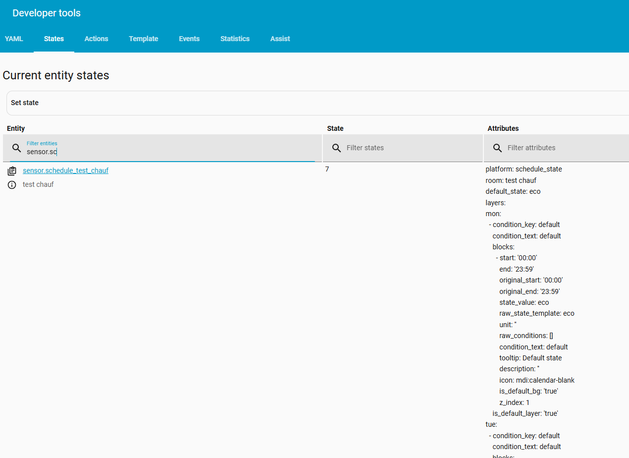

Fais voir ton entité sensor.test_chauf depuis les outils dev
oui bien dans configuration.yaml

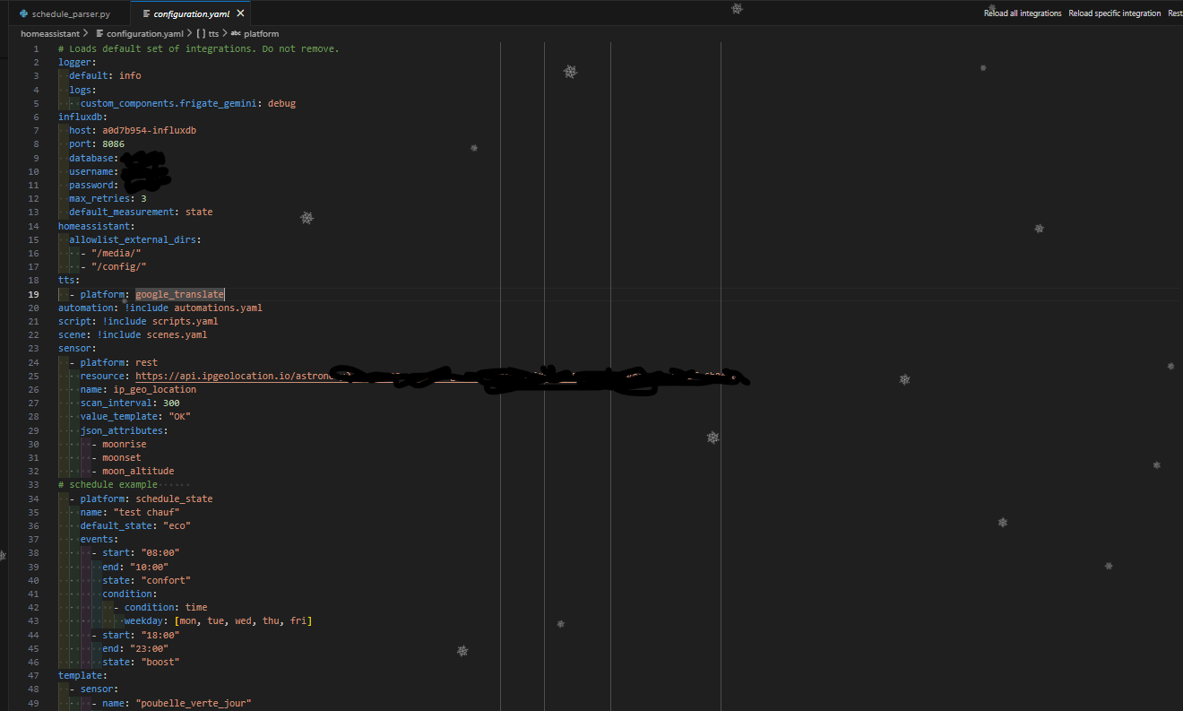

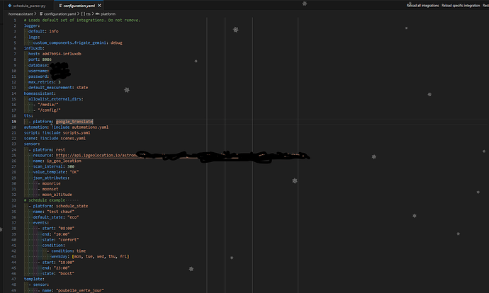

2025-12-12 17:02:14.810986 ERROR schedule_parser: Configuration file not found: /homeasistant/configuration.yaml
Tu es certain ? Tu fais des includes ?
Tu as une copie d’écran du fichier et son contenu ?
Vu, il manque des lettres homeasSistant, bon ceci dit, ça sera pas suffisant

Bien vu l’erreur viens de la doc
J’ai poussé une nouvelle version du python qui doit marcher dans ton cas (avec des insultes dans les logs)
2025-12-12 17:58:03.507928 WARNING schedule_parser: Error loading global YAML (likely due to !include/secrets): automations.yaml is not a valid yaml file. Attempting extraction of sensor section...
2025-12-12 17:58:03.512899 ERROR schedule_parser: Sensor block #6 unreadable, skipped: while parsing a block mapping
  in "<unicode string>", line 1, column 1:
    sensor:
expected <block end>, but found '<block mapping start>'
  in "<unicode string>", line 4, column 5:
        sensor:
2025-12-12 17:58:03.516001 ERROR schedule_parser: Sensor block #10 unreadable, skipped: while parsing a block mapping
    sensor:
        sensor:
2025-12-12 17:58:03.542411 INFO schedule_parser: Sensor 'sensor.schedule_test_chauf': 7 events - Unit: ''
2025-12-12 17:58:03.543507 INFO schedule_parser: Parsing completed: 1/1 sensors processed successfully
2025-12-12 17:58:53.500237 INFO schedule_parser: Starting parsing of /homeassistant/configuration.yaml...
2025-12-12 17:58:53.516226 WARNING schedule_parser: Error loading global YAML (likely due to !include/secrets): automations.yaml is not a valid yaml file. Attempting extraction of sensor section...
2025-12-12 17:58:53.522195 ERROR schedule_parser: Sensor block #6 unreadable, skipped: while parsing a block mapping
    sensor:
        sensor:
2025-12-12 17:58:53.526211 ERROR schedule_parser: Sensor block #10 unreadable, skipped: while parsing a block mapping
    sensor:
        sensor:
2025-12-12 17:58:53.549302 INFO schedule_parser: Sensor 'sensor.schedule_test_chauf': 7 events - Unit: ''
2025-12-12 17:58:53.550601 INFO schedule_parser: Parsing completed: 1/1 sensors processed successfully
et doc corrigée aussi
Parsing plus propre également, version dispo schedule-state-card/apps/schedule_parser/schedule_parser.py at main · Pulpyyyy/schedule-state-card · GitHub
