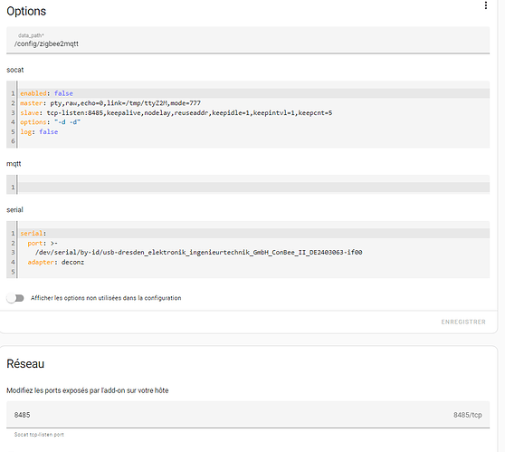

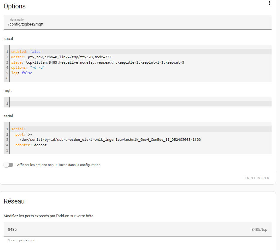

l’id de ma clé
Si quelqu’un peut m’aider svp ?
Tu as un serial en trop…
Et ensuite corrigé l’indentation.

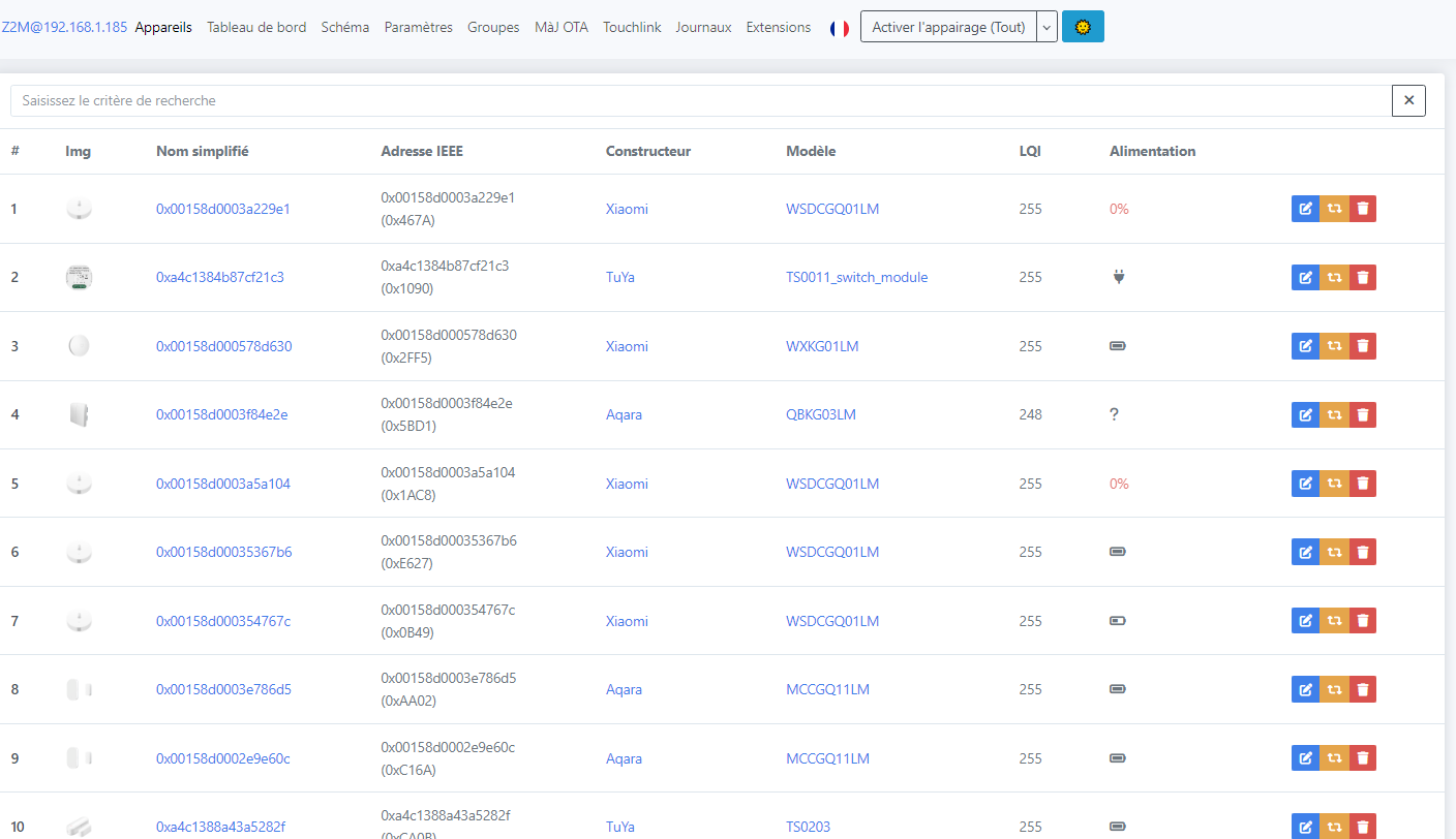

voila c’est mieux
il a même recuperer mes devices de jeedom
Apparemment pas besoin de recopier mon fichier configuration.yaml

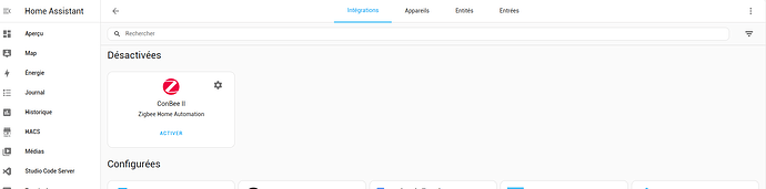

J’ai suivi le tutoriel et tenté par moi meme de faire marché tout ca, mais je ne comprend pas comment faire appareil des appareil dans MQTT ?
J’essaye de cliquer sur activer mais j’ai ce message d’erreur :

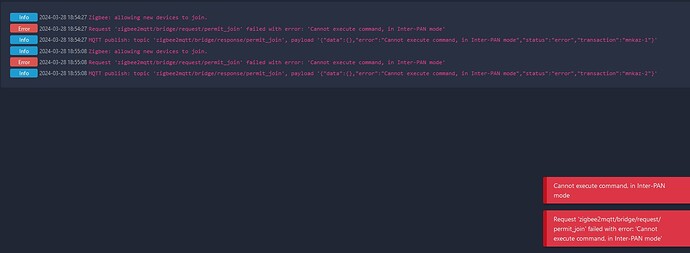

et dans les logs j’ai ceci :
Zigbee2MQTT:info 2024-03-28 18:46:03: MQTT publish: topic 'zigbee2mqtt/bridge/state', payload '{"state":"online"}'
Zigbee2MQTT:info 2024-03-28 18:46:03: Zigbee2MQTT started!
Zigbee2MQTT:info 2024-03-28 18:47:29: Start Touchlink scan
Zigbee2MQTT:error 2024-03-28 18:47:43: Request 'zigbee2mqtt/bridge/request/touchlink/scan' failed with error: 'SRSP - AF - interPanCtl after 6000ms'
Zigbee2MQTT:info 2024-03-28 18:47:43: MQTT publish: topic 'zigbee2mqtt/bridge/response/touchlink/scan', payload '{"data":{},"error":"SRSP - AF - interPanCtl after 6000ms","status":"error","transaction":"v35vj-1"}'
Zigbee2MQTT:info 2024-03-28 18:50:00: Zigbee: disabling joining new devices.
Zigbee2MQTT:error 2024-03-28 18:50:00: Request 'zigbee2mqtt/bridge/request/permit_join' failed with error: 'Cannot execute command, in Inter-PAN mode'
Zigbee2MQTT:info 2024-03-28 18:50:00: MQTT publish: topic 'zigbee2mqtt/bridge/response/permit_join', payload '{"data":{},"error":"Cannot execute command, in Inter-PAN mode","status":"error","transaction":"2b1cu-1"}'
Zigbee2MQTT:info 2024-03-28 18:50:01: Zigbee: disabling joining new devices.
Zigbee2MQTT:error 2024-03-28 18:50:01: Request 'zigbee2mqtt/bridge/request/permit_join' failed with error: 'Cannot execute command, in Inter-PAN mode'
Zigbee2MQTT:info 2024-03-28 18:50:01: MQTT publish: topic 'zigbee2mqtt/bridge/response/permit_join', payload '{"data":{},"error":"Cannot execute command, in Inter-PAN mode","status":"error","transaction":"2b1cu-2"}'
Zigbee2MQTT:info 2024-03-28 18:50:30: Successfully changed options
Zigbee2MQTT:info 2024-03-28 18:50:30: MQTT publish: topic 'zigbee2mqtt/bridge/response/options', payload '{"data":{"restart_required":false},"status":"ok","transaction":"2b1cu-3"}'
Zigbee2MQTT:info 2024-03-28 18:50:43: Successfully changed options
Zigbee2MQTT:info 2024-03-28 18:50:43: MQTT publish: topic 'zigbee2mqtt/bridge/response/options', payload '{"data":{"restart_required":false},"status":"ok","transaction":"2b1cu-4"}'
Zigbee2MQTT:info 2024-03-28 18:51:29: Zigbee: allowing new devices to join via Coordinator.
Zigbee2MQTT:error 2024-03-28 18:51:29: Request 'zigbee2mqtt/bridge/request/permit_join' failed with error: 'Cannot execute command, in Inter-PAN mode'
Zigbee2MQTT:info 2024-03-28 18:51:29: MQTT publish: topic 'zigbee2mqtt/bridge/response/permit_join', payload '{"data":{},"error":"Cannot execute command, in Inter-PAN mode","status":"error","transaction":"2b1cu-5"}'
Zigbee2MQTT:info 2024-03-28 18:51:41: Zigbee: allowing new devices to join.
Zigbee2MQTT:error 2024-03-28 18:51:41: Request 'zigbee2mqtt/bridge/request/permit_join' failed with error: 'Cannot execute command, in Inter-PAN mode'
Zigbee2MQTT:info 2024-03-28 18:51:41: MQTT publish: topic 'zigbee2mqtt/bridge/response/permit_join', payload '{"data":{},"error":"Cannot execute command, in Inter-PAN mode","status":"error","transaction":"2b1cu-6"}'
Zigbee2MQTT:info 2024-03-28 18:54:27: Zigbee: allowing new devices to join.
Zigbee2MQTT:error 2024-03-28 18:54:27: Request 'zigbee2mqtt/bridge/request/permit_join' failed with error: 'Cannot execute command, in Inter-PAN mode'
Zigbee2MQTT:info 2024-03-28 18:54:27: MQTT publish: topic 'zigbee2mqtt/bridge/response/permit_join', payload '{"data":{},"error":"Cannot execute command, in Inter-PAN mode","status":"error","transaction":"mnkaz-1"}'
Zigbee2MQTT:info 2024-03-28 18:55:08: Zigbee: allowing new devices to join.
Zigbee2MQTT:error 2024-03-28 18:55:08: Request 'zigbee2mqtt/bridge/request/permit_join' failed with error: 'Cannot execute command, in Inter-PAN mode'
Zigbee2MQTT:info 2024-03-28 18:55:08: MQTT publish: topic 'zigbee2mqtt/bridge/response/permit_join', payload '{"data":{},"error":"Cannot execute command, in Inter-PAN mode","status":"error","transaction":"mnkaz-2"}'
Si quelqu’un a une idée ? merci

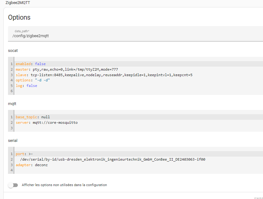

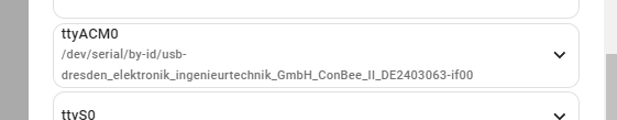

je n’arrive pas à connecter Zigbee2MQTT.
J’ai une erreur : 502: Bad Gateway
J’ai un problème avec MQTT : si je passe par MQTT explorer, j’arrive à ouvrir la connexion avec l’ip de min raspberry (10.0.0.15).
Si je tente core-mosquitto , la connexion ne se fait pas.
Voici le log de Zigbee2MQTT :

Ici le log de MQTT :
[08:43:49] INFO: Setting up user mqtt
[08:43:50] INFO: Certificates found: SSL is available
cont-init: info: /etc/cont-init.d/mosquitto.sh exited 0
cont-init: info: running /etc/cont-init.d/nginx.sh
cont-init: info: /etc/cont-init.d/nginx.sh exited 0
services-up: info: copying legacy longrun mosquitto (no readiness notification)
services-up: info: copying legacy longrun nginx (no readiness notification)
[08:43:52] INFO: Starting NGINX for authentication handling...
[08:43:52] INFO: Starting mosquitto MQTT broker...
2024-05-23 08:43:52: Warning: Mosquitto should not be run as root/administrator.
2024-05-23 08:43:52: mosquitto version 2.0.18 starting
2024-05-23 08:43:52: Config loaded from /etc/mosquitto/mosquitto.conf.
2024-05-23 08:43:52: Loading plugin: /usr/share/mosquitto/go-auth.so
2024-05-23 08:43:52: ├── Username/password checking enabled.
2024-05-23 08:43:52: ├── TLS-PSK checking enabled.
2024-05-23 08:43:52: └── Extended authentication not enabled.
2024-05-23 08:43:52: Opening ipv4 listen socket on port 1883.
2024-05-23 08:43:52: Opening ipv6 listen socket on port 1883.
2024-05-23 08:43:52: Opening websockets listen socket on port 1884.
2024-05-23 08:43:52: Opening ipv4 listen socket on port 8883.
2024-05-23 08:43:52: Opening ipv6 listen socket on port 8883.
2024-05-23 08:43:52: Opening websockets listen socket on port 8884.
2024-05-23 08:43:52: mosquitto version 2.0.18 running
2024-05-23 08:43:52: New connection from 127.0.0.1:38946 on port 1883.
2024-05-23 08:43:52: Client <unknown> disconnected due to protocol error.
[08:43:53] INFO: Successfully send discovery information to Home Assistant.
[08:43:54] INFO: Successfully send service information to the Supervisor.
2024-05-23 08:43:56: New connection from 10.0.0.15:33709 on port 1883.
2024-05-23 08:43:56: New client connected from 10.0.0.15:33709 as 5zmbbqAmOmoLezYremV3xS (p2, c1, k60, u'mqtt').
time="2024-05-23T08:44:02+02:00" level=error msg="POST error: Post \"http://127.0.0.1:80/superuser\": EOF"
2024-05-23 08:44:08: New connection from 172.30.32.2:57042 on port 1883.
2024-05-23 08:44:08: Client <unknown> closed its connection.
2024-05-23 08:44:17: New connection from 10.0.0.46:53072 on port 1883.
2024-05-23 08:44:17: New client connected from 10.0.0.46:53072 as mqtt-explorer-41ee81b4 (p2, c1, k60, u'mqtt').
2024-05-23 08:44:21: Client mqtt-explorer-41ee81b4 disconnected.
2024-05-23 08:46:08: New connection from 172.30.32.2:58908 on port 1883.
2024-05-23 08:46:08: Client <unknown> closed its connection.
2024-05-23 08:48:08: New connection from 172.30.32.2:37240 on port 1883.
2024-05-23 08:48:08: Client <unknown> closed its connection.

ici ma configuration mqtt :
logins:
- username: mqtt
password: mqtt
require_certificate: false
certfile: fullchain.pem
keyfile: privkey.pem
customize:
active: false
folder: mosquitto
Ma configuration zigbee2mqtt :
data_path: /config/zigbee2mqtt
socat:
enabled: false
master: pty,raw,echo=0,link=/tmp/ttyZ2M,mode=777
slave: tcp-listen:8485,keepalive,nodelay,reuseaddr,keepidle=1,keepintvl=1,keepcnt=5
options: "-d -d"
log: false
mqtt:
base_topic: zigbee2mqtt
server: mqtt://10.0.0.15
user: mqtt
password: mqtt
serial:
port: >-
/dev/serial/by-id/usb-dresden_elektronik_ingenieurtechnik_GmbH_ConBee_II_DE2497659-if00
adapter: deconz
NB : j’ai un module complémentaire deConz qui tourne également
Merci ![]()
tu peut pas utiliser la même clé zigbee avec deconz et Z2M en même temps.
z2m: Error: Error while opening serialport 'Error: Error: Resource busy, cannot open /dev/serial/by-id/usb-dresden_elektronik_ingenieurtechnik_GmbH_ConBee_II_DE2497659-if00'
Soit tu supprime deconz et passe sur Z2M. Soit il te faut une autre clé zigbee que tu installera pour Z2M, et ta conbeeII pour deconz.
Ca marche
Merci beaucoup ![]()
Bonjour à tous. Merci infiniment @ClassicRed. Je n’y serai pas arrivé sans ton aide.
Je cherchais désespérément pourquoi zigbee2mqtt ne démarrait pas.
J’ai désactivé ZHA, comme tu le préconises au début. Et bingo ! Redémarrage des services et tout fonctionne. Un grand merci à toi.
Attention, toutefois, il faut bien préciser que le paramètre server dans le broker Mosquitto est localhost. Et dans zigbee2mqtt, il faut mettre core-mosquitto

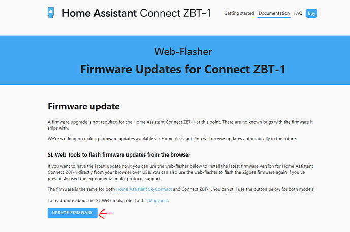

Bonjour.
Tu peux ajouter la clé skyconnect v1 (ou ZBT-1).
Changer le firmware de la clé depuis un PC:
installation du pilote windows ou mac : CP210x USB to UART Bridge VCP Drivers - Silicon Labs (silabs.com)
lancer depuis Chrome ou Edge (firefox ne peut pas) : Home Assistant Connect ZBT-1 (home-assistant.io)
selectionner Update Firmware
Sélectionner : « Change Firmware » puis « ZIGBEE Ezsp »
