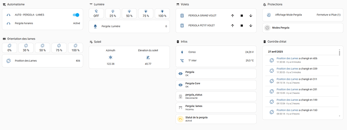

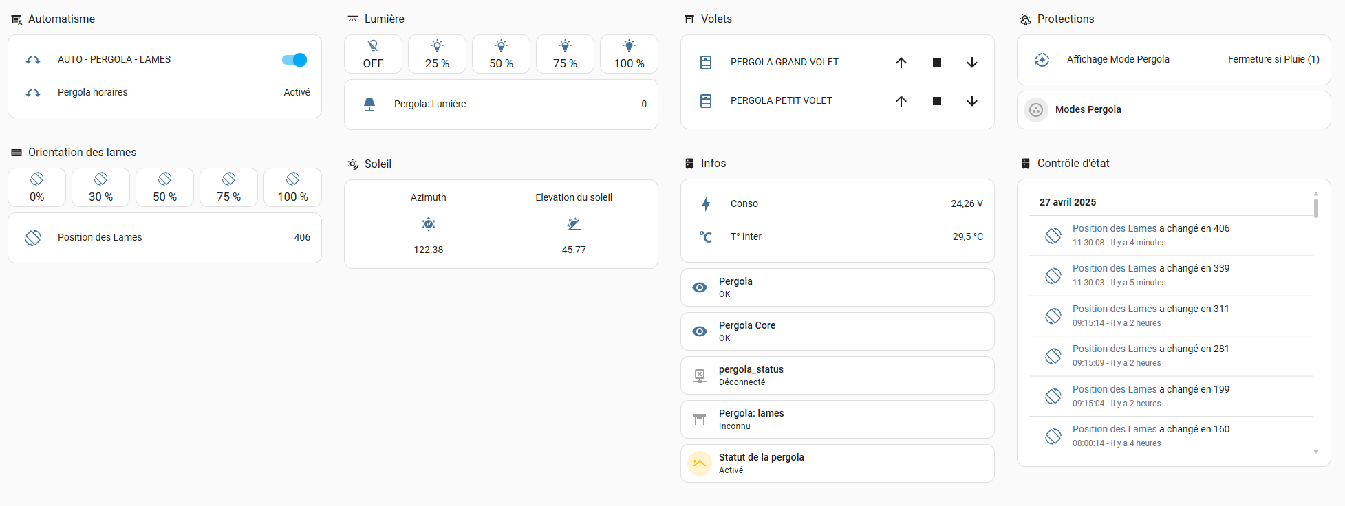

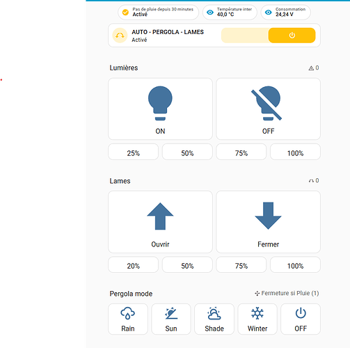

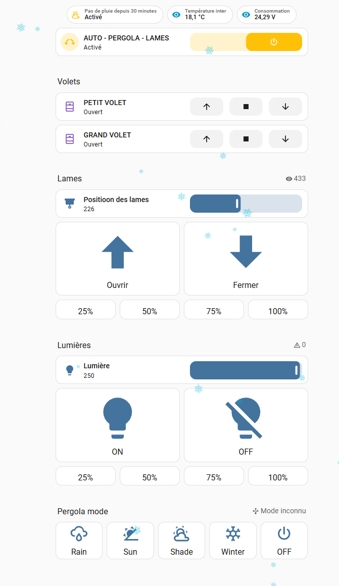

A vous de l’améliorer, moi par exemple il est comme ceci
La partie concernant les switch:
J’ai simplié au maximum pour éviter les problèmes. Toute la partie commande se trouve maintenant Lovelace directement dans la carte avec des `tap_action’
type: grid
  - type: tile
    entity: automation.auto_pergola_lames
    features_position: inline
    vertical: false
    grid_options:
      columns: full
    features:
      - type: toggle
  - features:
      - type: cover-open-close
    type: tile
    entity: cover.pergola_petit_volet
    vertical: false
  - features:
    type: tile
    entity: cover.pergola_grand_volet
    vertical: false
  - type: heading
    heading: Lumières
    heading_style: title
    badges:
      - type: entity
        show_state: true
        show_icon: true
        entity: sensor.light_sensor_pergola_white
        icon: mdi:flash-triangle-outline
  - features:
      - style: slider
        type: numeric-input
    type: tile
    entity: input_number.pergola_light_brightness
    vertical: false
  - type: vertical-stack
      - type: horizontal-stack
          - show_name: true
            show_icon: true
            type: button
            icon: mdi:lightbulb
            tap_action:
              action: call-service
              service: rest_command.pergola_set_brightnesslevel
              service_data:
                brightness: 130
          - type: button
            icon: mdi:lightbulb-off
            tap_action:
              service_data:
                brightness: 0
          - type: button
            tap_action:
              service_data:
                brightness: 75
          - type: button
            tap_action:
              service_data:
                brightness: 130
          - type: button
            tap_action:
              service_data:
                brightness: 190
          - type: button
            tap_action:
              service_data:
                brightness: 255
  - type: heading
    heading: Lames
    badges:
      - type: entity
        entity: sensor.sensor_pergola_position_des_lames_mot0
  - features:
      - style: slider
        type: numeric-input
    type: tile
    entity: input_number.pergola_blades_angle
    name: Positioon des lames
    vertical: false
          - show_name: true
            show_icon: true
            type: button
            icon: mdi:arrow-up-bold
            tap_action:
              service: rest_command.pergola_set_motorlevel
              service_data:
                position: 500
          - type: button
            icon: mdi:arrow-down-bold
            tap_action:
              service_data:
                position: 0
          - show_name: true
            show_icon: true
            type: button
            tap_action:
              service_data:
                position: 190
          - type: button
            tap_action:
              service_data:
                position: 300
          - type: button
            tap_action:
              service_data:
                position: 400
          - type: button
            tap_action:
              service_data:
                position: 500
  - type: heading
    heading: Pergola mode
    badges:
      - type: entity
        show_state: true
        show_icon: true
        entity: sensor.pergola_mode_display
        icon: mdi:arrow-decision
      - show_name: true
        show_icon: true
        type: button

Et enfin on vas créer la carte:
  - type: entities
      - entity: input_number.pergola_light_brightness
  - type: entities
      - entity: input_number.pergola_blades_angle
Et enfin pour les lames, on ajoute ceci dans le yaml:
  pergola_blades_angle:
    min: 0
    max: 255  # ou 255 selon ton API
    step: 1
    mode: slider
    icon: mdi:blinds
et sa carte
  - type: entities
  - type: entities

Si tout se passe comme prévu, voici ce que l’on obtient.
voici une nouvelle évolution de mon tableau de bord qui concerne la pergola
Beau boulot ! :+1: :+1: :+1:
Le slider de la rotation des lames ne fonctionne pas
Est ce une erreur de mon côté, ou sur le script ?
Egalement, la lumiere ne s’éteind pas completement, et les lames ne se ferment pas completement
Il prend pas la fonction off et c’est vrai que je ne l’utilise pas. Faut que je regarde comment le corriger.
