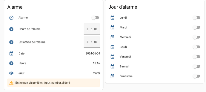

Le mien ressemble à ceci

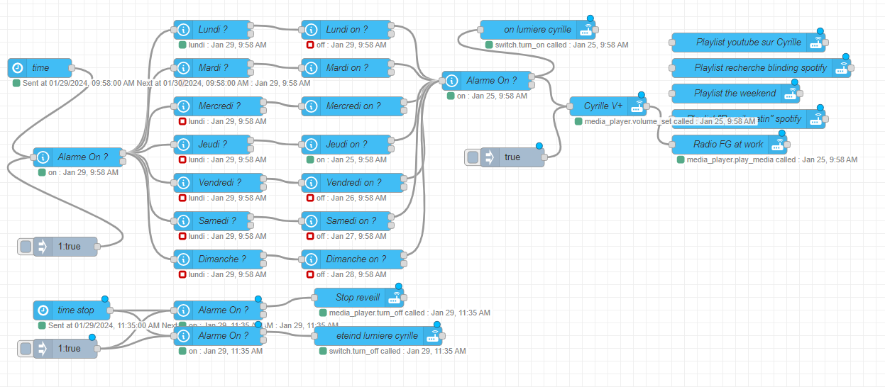

Super boulot! Je cherche désespérément à faire un radio réveil sur HA qui me permet d’avoir la radio sur un groupe d’enceinte Google.
Je suis ultra intéressé par ce que tu as fait. Si possible d’avoir des explications je suis preneur.
Merci d’avance.
Fab
[{"id":"cdd51759fb44a193","type":"tab","label":"Flux 1","disabled":false,"info":"","env":[]},{"id":"6eb17b5eb3ec12ef","type":"api-current-state","z":"cdd51759fb44a193","name":"Mercredi ?","server":"6f1918eeef2fa9ec","version":3,"outputs":2,"halt_if":"mercredi","halt_if_type":"str","halt_if_compare":"is","entity_id":"sensor.jour","state_type":"str","blockInputOverrides":false,"outputProperties":[{"property":"payload","propertyType":"msg","value":"","valueType":"entityState"},{"property":"data","propertyType":"msg","value":"","valueType":"entity"}],"for":"0","forType":"num","forUnits":"minutes","override_topic":false,"state_location":"payload","override_payload":"msg","entity_location":"data","override_data":"msg","x":390,"y":220,"wires":[["be6179c30ab312ba"],[]]},{"id":"d453179b135bd40c","type":"api-current-state","z":"cdd51759fb44a193","name":"Mardi ?","server":"6f1918eeef2fa9ec","version":3,"outputs":2,"halt_if":"mardi","halt_if_type":"str","halt_if_compare":"is","entity_id":"sensor.jour","state_type":"str","blockInputOverrides":false,"outputProperties":[{"property":"payload","propertyType":"msg","value":"","valueType":"entityState"},{"property":"data","propertyType":"msg","value":"","valueType":"entity"}],"for":"0","forType":"num","forUnits":"minutes","override_topic":false,"state_location":"payload","override_payload":"msg","entity_location":"data","override_data":"msg","x":380,"y":160,"wires":[["ca4db7a6c3946de9"],[]]},{"id":"91a22cbaab948514","type":"api-current-state","z":"cdd51759fb44a193","name":"Lundi ?","server":"6f1918eeef2fa9ec","version":3,"outputs":2,"halt_if":"lundi","halt_if_type":"str","halt_if_compare":"is","entity_id":"sensor.jour","state_type":"str","blockInputOverrides":false,"outputProperties":[{"property":"payload","propertyType":"msg","value":"","valueType":"entityState"},{"property":"data","propertyType":"msg","value":"","valueType":"entity"}],"for":"0","forType":"num","forUnits":"minutes","override_topic":false,"state_location":"payload","override_payload":"msg","entity_location":"data","override_data":"msg","x":380,"y":100,"wires":[["4c44ccb608c90f32"],[]]},{"id":"8d7cc562f574632e","type":"api-current-state","z":"cdd51759fb44a193","name":"Jeudi ?","server":"6f1918eeef2fa9ec","version":3,"outputs":2,"halt_if":"jeudi","halt_if_type":"str","halt_if_compare":"is","entity_id":"sensor.jour","state_type":"str","blockInputOverrides":false,"outputProperties":[{"property":"payload","propertyType":"msg","value":"","valueType":"entityState"},{"property":"data","propertyType":"msg","value":"","valueType":"entity"}],"for":"0","forType":"num","forUnits":"minutes","override_topic":false,"state_location":"payload","override_payload":"msg","entity_location":"data","override_data":"msg","x":380,"y":280,"wires":[["b595e111ada19c9c"],[]]},{"id":"2d5885f7981f4d84","type":"api-current-state","z":"cdd51759fb44a193","name":"Vendredi ?","server":"6f1918eeef2fa9ec","version":3,"outputs":2,"halt_if":"vendredi","halt_if_type":"str","halt_if_compare":"is","entity_id":"sensor.jour","state_type":"str","blockInputOverrides":false,"outputProperties":[{"property":"payload","propertyType":"msg","value":"","valueType":"entityState"},{"property":"data","propertyType":"msg","value":"","valueType":"entity"}],"for":"0","forType":"num","forUnits":"minutes","override_topic":false,"state_location":"payload","override_payload":"msg","entity_location":"data","override_data":"msg","x":390,"y":340,"wires":[["af1d30290f4bd52e"],[]]},{"id":"c0316e659417e523","type":"api-current-state","z":"cdd51759fb44a193","name":"Samedi ?","server":"6f1918eeef2fa9ec","version":3,"outputs":2,"halt_if":"samedi","halt_if_type":"str","halt_if_compare":"is","entity_id":"sensor.jour","state_type":"str","blockInputOverrides":false,"outputProperties":[{"property":"payload","propertyType":"msg","value":"","valueType":"entityState"},{"property":"data","propertyType":"msg","value":"","valueType":"entity"}],"for":"0","forType":"num","forUnits":"minutes","override_topic":false,"state_location":"payload","override_payload":"msg","entity_location":"data","override_data":"msg","x":380,"y":400,"wires":[["6f9511174d92eb9e"],[]]},{"id":"62f6a28c860fc5ec","type":"api-current-state","z":"cdd51759fb44a193","name":"Dimanche ?","server":"6f1918eeef2fa9ec","version":3,"outputs":2,"halt_if":"dimanche","halt_if_type":"str","halt_if_compare":"is","entity_id":"sensor.jour","state_type":"str","blockInputOverrides":false,"outputProperties":[{"property":"payload","propertyType":"msg","value":"","valueType":"entityState"},{"property":"data","propertyType":"msg","value":"","valueType":"entity"}],"for":"0","forType":"num","forUnits":"minutes","override_topic":false,"state_location":"payload","override_payload":"msg","entity_location":"data","override_data":"msg","x":390,"y":460,"wires":[["c4f85c8a95b8270d"],[]]},{"id":"71c8d1b9e1ad0e09","type":"api-current-state","z":"cdd51759fb44a193","name":"Alarme On ?","server":"6f1918eeef2fa9ec","version":3,"outputs":2,"halt_if":"on","halt_if_type":"str","halt_if_compare":"is","entity_id":"input_boolean.alarme","state_type":"str","blockInputOverrides":false,"outputProperties":[{"property":"payload","propertyType":"msg","value":"","valueType":"entityState"},{"property":"data","propertyType":"msg","value":"","valueType":"entity"}],"for":"0","forType":"num","forUnits":"minutes","override_topic":false,"state_location":"payload","override_payload":"msg","entity_location":"data","override_data":"msg","x":170,"y":300,"wires":[["91a22cbaab948514","d453179b135bd40c","6eb17b5eb3ec12ef","8d7cc562f574632e","2d5885f7981f4d84","c0316e659417e523","62f6a28c860fc5ec"],[]]},{"id":"4c44ccb608c90f32","type":"api-current-state","z":"cdd51759fb44a193","name":"Lundi on ?","server":"6f1918eeef2fa9ec","version":3,"outputs":2,"halt_if":"on","halt_if_type":"str","halt_if_compare":"is","entity_id":"input_boolean.wakeweekday_lun_1","state_type":"str","blockInputOverrides":false,"outputProperties":[{"property":"payload","propertyType":"msg","value":"","valueType":"entityState"},{"property":"data","propertyType":"msg","value":"","valueType":"entity"}],"for":"0","forType":"num","forUnits":"minutes","override_topic":false,"state_location":"payload","override_payload":"msg","entity_location":"data","override_data":"msg","x":590,"y":100,"wires":[["e5e578f0b0188164"],[]]},{"id":"ca4db7a6c3946de9","type":"api-current-state","z":"cdd51759fb44a193","name":"Mardi on ?","server":"6f1918eeef2fa9ec","version":3,"outputs":2,"halt_if":"on","halt_if_type":"str","halt_if_compare":"is","entity_id":"input_boolean.wakeweekday_mar_1","state_type":"str","blockInputOverrides":false,"outputProperties":[{"property":"payload","propertyType":"msg","value":"","valueType":"entityState"},{"property":"data","propertyType":"msg","value":"","valueType":"entity"}],"for":"0","forType":"num","forUnits":"minutes","override_topic":false,"state_location":"payload","override_payload":"msg","entity_location":"data","override_data":"msg","x":590,"y":160,"wires":[["e5e578f0b0188164"],[]]},{"id":"be6179c30ab312ba","type":"api-current-state","z":"cdd51759fb44a193","name":"Mercredi on ?","server":"6f1918eeef2fa9ec","version":3,"outputs":2,"halt_if":"on","halt_if_type":"str","halt_if_compare":"is","entity_id":"input_boolean.wakeweekday_mer_1","state_type":"str","blockInputOverrides":false,"outputProperties":[{"property":"payload","propertyType":"msg","value":"","valueType":"entityState"},{"property":"data","propertyType":"msg","value":"","valueType":"entity"}],"for":"0","forType":"num","forUnits":"minutes","override_topic":false,"state_location":"payload","override_payload":"msg","entity_location":"data","override_data":"msg","x":600,"y":220,"wires":[["e5e578f0b0188164"],[]]},{"id":"b595e111ada19c9c","type":"api-current-state","z":"cdd51759fb44a193","name":"Jeudi on ?","server":"6f1918eeef2fa9ec","version":3,"outputs":2,"halt_if":"on","halt_if_type":"str","halt_if_compare":"is","entity_id":"input_boolean.wakeweekday_jeu_1","state_type":"str","blockInputOverrides":false,"outputProperties":[{"property":"payload","propertyType":"msg","value":"","valueType":"entityState"},{"property":"data","propertyType":"msg","value":"","valueType":"entity"}],"for":"0","forType":"num","forUnits":"minutes","override_topic":false,"state_location":"payload","override_payload":"msg","entity_location":"data","override_data":"msg","x":590,"y":280,"wires":[["e5e578f0b0188164"],[]]},{"id":"af1d30290f4bd52e","type":"api-current-state","z":"cdd51759fb44a193","name":"Vendredi on ?","server":"6f1918eeef2fa9ec","version":3,"outputs":2,"halt_if":"on","halt_if_type":"str","halt_if_compare":"is","entity_id":"input_boolean.wakeweekday_ven_1","state_type":"str","blockInputOverrides":false,"outputProperties":[{"property":"payload","propertyType":"msg","value":"","valueType":"entityState"},{"property":"data","propertyType":"msg","value":"","valueType":"entity"}],"for":"0","forType":"num","forUnits":"minutes","override_topic":false,"state_location":"payload","override_payload":"msg","entity_location":"data","override_data":"msg","x":600,"y":340,"wires":[["e5e578f0b0188164"],[]]},{"id":"6f9511174d92eb9e","type":"api-current-state","z":"cdd51759fb44a193","name":"Samedi on ?","server":"6f1918eeef2fa9ec","version":3,"outputs":2,"halt_if":"on","halt_if_type":"str","halt_if_compare":"is","entity_id":"input_boolean.wakeweekday_sam_1","state_type":"str","blockInputOverrides":false,"outputProperties":[{"property":"payload","propertyType":"msg","value":"","valueType":"entityState"},{"property":"data","propertyType":"msg","value":"","valueType":"entity"}],"for":"0","forType":"num","forUnits":"minutes","override_topic":false,"state_location":"payload","override_payload":"msg","entity_location":"data","override_data":"msg","x":590,"y":400,"wires":[["e5e578f0b0188164"],[]]},{"id":"c4f85c8a95b8270d","type":"api-current-state","z":"cdd51759fb44a193","name":"Dimanche on ?","server":"6f1918eeef2fa9ec","version":3,"outputs":2,"halt_if":"on","halt_if_type":"str","halt_if_compare":"is","entity_id":"input_boolean.wakeweekday_dim_1","state_type":"str","blockInputOverrides":false,"outputProperties":[{"property":"payload","propertyType":"msg","value":"","valueType":"entityState"},{"property":"data","propertyType":"msg","value":"","valueType":"entity"}],"for":"0","forType":"num","forUnits":"minutes","override_topic":false,"state_location":"payload","override_payload":"msg","entity_location":"data","override_data":"msg","x":600,"y":460,"wires":[["e5e578f0b0188164"],[]]},{"id":"095f960b696087dc","type":"inject","z":"cdd51759fb44a193","name":"","props":[{"p":"payload","v":"true","vt":"bool"},{"p":"topic","v":"1","vt":"string"}],"repeat":"","crontab":"","once":false,"onceDelay":0.1,"topic":"1","payload":"true","payloadType":"bool","x":150,"y":440,"wires":[["71c8d1b9e1ad0e09"]]},{"id":"020e5c99b1be8f0a","type":"ha-time","z":"cdd51759fb44a193","name":"time","server":"6f1918eeef2fa9ec","version":3,"exposeAsEntityConfig":"","entityId":"input_datetime.stop_time","property":"","offset":"0","offsetType":"num","offsetUnits":"minutes","randomOffset":false,"repeatDaily":true,"outputProperties":[{"property":"payload","propertyType":"msg","value":"","valueType":"entityState"},{"property":"data","propertyType":"msg","value":"","valueType":"entity"},{"property":"topic","propertyType":"msg","value":"","valueType":"triggerId"}],"sunday":true,"monday":true,"tuesday":true,"wednesday":true,"thursday":true,"friday":true,"saturday":true,"x":150,"y":540,"wires":[["ab167e295d31a44d"]]},{"id":"13fb3c5001cefe11","type":"api-call-service","z":"cdd51759fb44a193","name":"eteind lumiere cyrille","server":"6f1918eeef2fa9ec","version":5,"debugenabled":false,"domain":"switch","service":"turn_off","areaId":[],"deviceId":["4efc4c2120c976c44ab176ecd9070fc0"],"entityId":[],"data":"","dataType":"jsonata","mergeContext":"","mustacheAltTags":false,"outputProperties":[],"queue":"none","x":640,"y":580,"wires":[[]]},{"id":"0ff3a7c58e7f8379","type":"api-call-service","z":"cdd51759fb44a193","name":"Stop reveill","server":"6f1918eeef2fa9ec","version":5,"debugenabled":false,"domain":"media_player","service":"turn_off","areaId":[],"deviceId":["7184a5bbbb750984bfa83aa3ef144f72","be12e970a5703eb0a0fb50e95d95a184"],"entityId":[],"data":"","dataType":"json","mergeContext":"","mustacheAltTags":false,"outputProperties":[{"property":"playlist_id","propertyType":"msg","value":"PL-a8YGDlatFqXjNR4FXCNNsS8mOrNLXzt","valueType":"str"}],"queue":"none","x":610,"y":520,"wires":[[]]},{"id":"e5e578f0b0188164","type":"api-current-state","z":"cdd51759fb44a193","name":"Alarme On ?","server":"6f1918eeef2fa9ec","version":3,"outputs":2,"halt_if":"on","halt_if_type":"str","halt_if_compare":"is","entity_id":"input_boolean.alarme","state_type":"str","blockInputOverrides":false,"outputProperties":[{"property":"payload","propertyType":"msg","value":"","valueType":"entityState"},{"property":"data","propertyType":"msg","value":"","valueType":"entity"}],"for":"0","forType":"num","forUnits":"minutes","override_topic":false,"state_location":"payload","override_payload":"msg","entity_location":"data","override_data":"msg","x":810,"y":180,"wires":[["46599265c0d406c3"],[]]},{"id":"2b5887788835dedc","type":"inject","z":"cdd51759fb44a193","name":"","props":[{"p":"payload"},{"p":"topic","vt":"str"}],"repeat":"","crontab":"","once":false,"onceDelay":0.1,"topic":"","payload":"true","payloadType":"bool","x":850,"y":300,"wires":[["46599265c0d406c3"]]},{"id":"244768d540507052","type":"ha-time","z":"cdd51759fb44a193","name":"time","server":"6f1918eeef2fa9ec","version":3,"exposeAsEntityConfig":"","entityId":"input_datetime.alarme_time","property":"","offset":"0","offsetType":"num","offsetUnits":"minutes","randomOffset":false,"repeatDaily":true,"outputProperties":[{"property":"payload","propertyType":"msg","value":"","valueType":"entityState"},{"property":"data","propertyType":"msg","value":"","valueType":"entity"},{"property":"topic","propertyType":"msg","value":"","valueType":"triggerId"}],"sunday":true,"monday":true,"tuesday":true,"wednesday":true,"thursday":true,"friday":true,"saturday":true,"x":110,"y":160,"wires":[["71c8d1b9e1ad0e09"]]},{"id":"46599265c0d406c3","type":"api-call-service","z":"cdd51759fb44a193","name":"Cyrille V+","server":"6f1918eeef2fa9ec","version":5,"debugenabled":false,"domain":"media_player","service":"volume_set","areaId":[],"deviceId":[],"entityId":["media_player.nestaudio0171"],"data":"{\"volume_level\":\"0.5\"}","dataType":"json","mergeContext":"","mustacheAltTags":false,"outputProperties":[],"queue":"none","x":980,"y":240,"wires":[["7ff43994771ce3fa"]]},{"id":"ab167e295d31a44d","type":"api-current-state","z":"cdd51759fb44a193","name":"Alarme On ?","server":"6f1918eeef2fa9ec","version":3,"outputs":2,"halt_if":"on","halt_if_type":"str","halt_if_compare":"is","entity_id":"input_boolean.alarme","state_type":"str","blockInputOverrides":false,"outputProperties":[{"property":"payload","propertyType":"msg","value":"","valueType":"entityState"},{"property":"data","propertyType":"msg","value":"","valueType":"entity"}],"for":"0","forType":"num","forUnits":"minutes","override_topic":false,"state_location":"payload","override_payload":"msg","entity_location":"data","override_data":"msg","x":390,"y":540,"wires":[["0ff3a7c58e7f8379","13fb3c5001cefe11"],[]]},{"id":"7ff43994771ce3fa","type":"api-call-service","z":"cdd51759fb44a193","name":"Radio FG at work","server":"6f1918eeef2fa9ec","version":5,"debugenabled":false,"domain":"media_player","service":"play_media","areaId":[],"deviceId":[],"entityId":["media_player.nestaudio0171"],"data":"{\"media_content_id\":\"http://radiofg.impek.com/fge\",\"media_content_type\":\"music\"}","dataType":"json","mergeContext":"","mustacheAltTags":false,"outputProperties":[],"queue":"none","x":1190,"y":280,"wires":[[]]},{"id":"e7db67b0e31bc416","type":"inject","z":"cdd51759fb44a193","name":"","props":[{"p":"payload","v":"true","vt":"bool"},{"p":"topic","v":"1","vt":"string"}],"repeat":"","crontab":"","once":false,"onceDelay":0.1,"topic":"1","payload":"true","payloadType":"bool","x":150,"y":600,"wires":[["ab167e295d31a44d"]]},{"id":"6f1918eeef2fa9ec","type":"server","name":"Home Assistant","version":5,"addon":true,"rejectUnauthorizedCerts":true,"ha_boolean":"y|yes|true|on|home|open","connectionDelay":true,"cacheJson":true,"heartbeat":false,"heartbeatInterval":"30","areaSelector":"friendlyName","deviceSelector":"friendlyName","entitySelector":"friendlyName","statusSeparator":": ","statusYear":"hidden","statusMonth":"short","statusDay":"numeric","statusHourCycle":"default","statusTimeFormat":"h:m","enableGlobalContextStore":true}]
Voici le nod-red

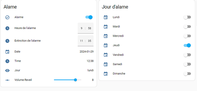

Les Cartes
type: entities
- entity: input_boolean.alarme
- entity: input_datetime.alarme_time
- entity: input_datetime.stop_time
- entity: sensor.date
- entity: sensor.time
- entity: sensor.jour
- entity: input_number.slider1
title: Alame
show_header_toggle: false
state_color: false
type: entities
- entity: input_boolean.wakeweekday_lun_1
- entity: input_boolean.wakeweekday_mar_1
- entity: input_boolean.wakeweekday_mer_1
- entity: input_boolean.wakeweekday_jeu_1
- entity: input_boolean.wakeweekday_ven_1
- entity: input_boolean.wakeweekday_sam_1
- entity: input_boolean.wakeweekday_dim_1
title: Jour d'alame
state_color: false

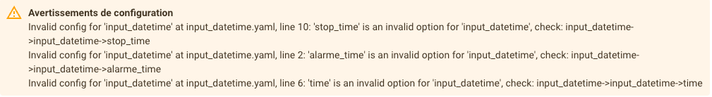

Super. Merci pour ton retour. Désolé pour toutes ces questions mais je débute vraiment. Faut que je prenne des cours en yaml
C’est bon j’ai créé les deux fichiers et collé le code dedans. Par contre j’obtient ces erreurs :
Avertissements de configuration
Invalid config for ‹ input_datetime › at input_datetime.yaml, line 10: ‹ stop_time › is an invalid option for ‹ input_datetime ›, check: input_datetime->input_datetime->stop_time Invalid config for ‹ input_datetime › at input_datetime.yaml, line 2: ‹ alarme_time › is an invalid option for ‹ input_datetime ›, check: input_datetime->input_datetime->alarme_time Invalid config for ‹ input_datetime › at input_datetime.yaml, line 6: ‹ time › is an invalid option for ‹ input_datetime ›, check: input_datetime->input_datetime->time
