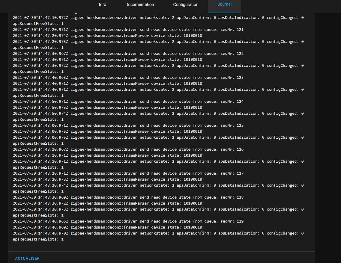

Le constat est assez simple, pas de trace (tu n’es toujours pas en debug au passage et on ne voit pas de séquence d’appairage) c’est
soit que les piles sont hs

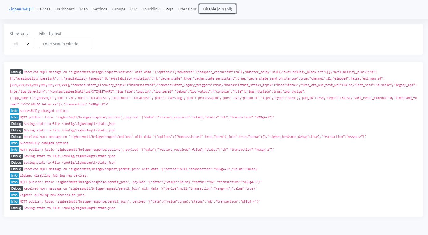

Bref … Si tu veux pouvoir profiter de l’aide :

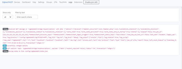

passer les logs zigbee2mqtt en debug
fournir des traces
Tant que ça crache rien dans les logs… ça reviens à tenter de faire un scores aux flechettes avec les yeux bandés…
ça doit ressembler à ça

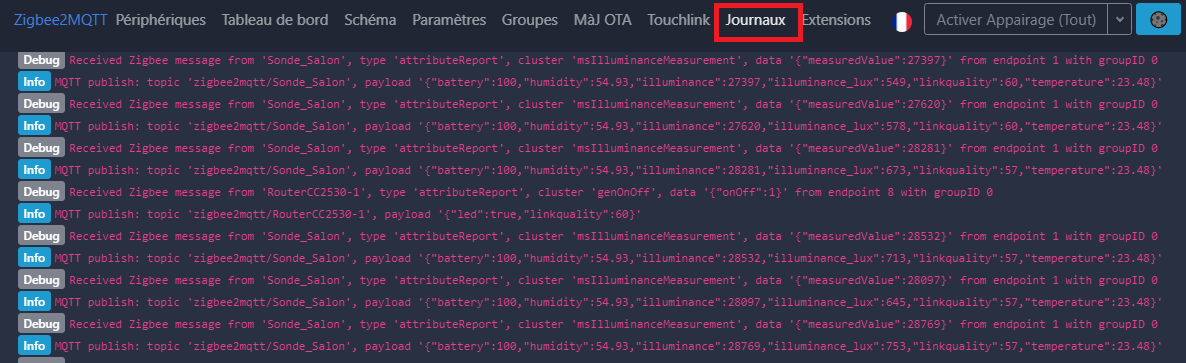

debug 2019-11-15T17:32:26: Device ‘0x000b57fffec49812’ announced itself
info 2019-11-15T17:32:26: MQTT publish: topic ‘homeassistant/sensor/0x000b57fffec49812/action/config’, payload ‘{“icon”:“mdi:gesture-double-tap”,“value_template”:"{{ value_json.action }}",“state_topic”:“zigbee2mqtt/0x000b57fffec49812”,“json_attributes_topic”:“zigbee2mqtt/0x000b57fffec49812”,“name”:“0x000b57fffec49812_action”,“unique_id”:“0x000b57fffec49812_action_zigbee2mqtt”,“device”:{“identifiers”:[“zigbee2mqtt_0x000b57fffec49812”],“name”:“0x000b57fffec49812”,“sw_version”:“Zigbee2mqtt 1.7.0”,“model”:“TRADFRI remote control (E1524/E1810)”,“manufacturer”:“IKEA”},“availability_topic”:“zigbee2mqtt/bridge/state”}’
info 2019-11-15T17:32:26: MQTT publish: topic ‘homeassistant/sensor/0x000b57fffec49812/battery/config’, payload ‘{“unit_of_measurement”:"%",“device_class”:“battery”,“value_template”:"{{ value_json.battery }}",“state_topic”:“zigbee2mqtt/0x000b57fffec49812”,“json_attributes_topic”:“zigbee2mqtt/0x000b57fffec49812”,“name”:“0x000b57fffec49812_battery”,“unique_id”:“0x000b57fffec49812_battery_zigbee2mqtt”,“device”:{“identifiers”:[“zigbee2mqtt_0x000b57fffec49812”],“name”:“0x000b57fffec49812”,“sw_version”:“Zigbee2mqtt 1.7.0”,“model”:“TRADFRI remote control (E1524/E1810)”,“manufacturer”:“IKEA”},“availability_topic”:“zigbee2mqtt/bridge/state”}’
info 2019-11-15T17:32:26: MQTT publish: topic ‘homeassistant/sensor/0x000b57fffec49812/linkquality/config’, payload ‘{“unit_of_measurement”:"-",“value_template”:"{{ value_json.linkquality }}",“state_topic”:“zigbee2mqtt/0x000b57fffec49812”,“json_attributes_topic”:“zigbee2mqtt/0x000b57fffec49812”,“name”:“0x000b57fffec49812_linkquality”,“unique_id”:“0x000b57fffec49812_linkquality_zigbee2mqtt”,“device”:{“identifiers”:[“zigbee2mqtt_0x000b57fffec49812”],“name”:“0x000b57fffec49812”,“sw_version”:“Zigbee2mqtt 1.7.0”,“model”:“TRADFRI remote control (E1524/E1810)”,“manufacturer”:“IKEA”},“availability_topic”:“zigbee2mqtt/bridge/state”}’

To enable debug logging for Zigbee-herdman start Zigbee2MQTT with: DEBUG=zigbee-herdsman* npm start. Zigbee-herdsman is the Zigbee library where Zigbee2MQTT is based up-on.
Important: this is not logged to the log files and is only available on the STDOUT.
