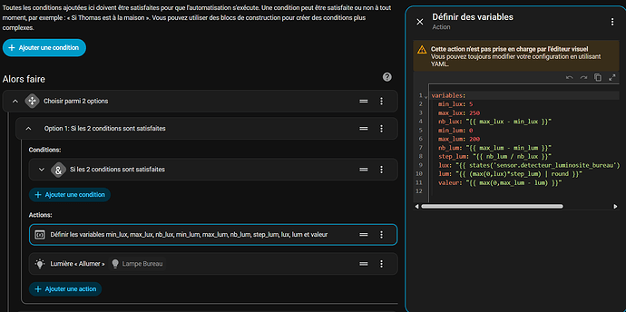

Si ça peut servir, je m’en sers pour régler la puissance de la lampe de mon bureau suivant la luminosité :
alias: Eclairage Bureau
description: ""
triggers:
  - trigger: state
    entity_id:
      - binary_sensor.detecteur_mouvement_bureau
    from: "off"
    to: "on"
  - trigger: state
    entity_id:
    from: "on"
    to: "off"
  - trigger: state
    entity_id:
      - sensor.detecteur_luminosite_bureau
conditions: []
actions:
  - choose:
      - conditions:
          - condition: and
            conditions:
              - condition: state
                entity_id: binary_sensor.detecteur_mouvement_bureau
                state: "on"
              - condition: trigger
                id:
                  - presence_on
                  - luminosite
        sequence:
          - variables:
              min_lux: 5
              max_lux: 250
              nb_lux: "{{ max_lux - min_lux }}"
              min_lum: 0
              max_lum: 200
              nb_lum: "{{ max_lum - min_lum }}"
              step_lum: "{{ nb_lum / nb_lux }}"
              lux: >-
                {{ states('sensor.detecteur_luminosite_bureau') | int - min_lux
              lum: "{{ (max(0,lux)*step_lum) | round }}"
              valeur: "{{ max(0,max_lum - lum) }}"
          - action: light.turn_on
            metadata: {}
              brightness: "{{ valeur }}"
              transition: 3
              entity_id: light.lampe_bureau
      - conditions:
            id:
              - presence_off
        sequence:
          - action: light.turn_off
            metadata: {}
            data: {}
mode: queued
max: 10
