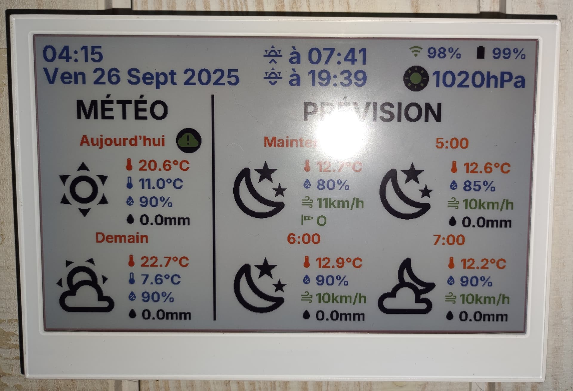

// ---------- PAGE 1 ----------
else{
// Batterie dans le coin supérieur droit
it.printf(700, 7, id(font_bat_icon), BLACK, "%s", id(battery_glyph).c_str());
it.printf(730, 5, id(small_font), BLUE, "%.0f%%", id(battery_level).state);
// heure date
const char* jours[] = {"Dim", "Lun", "Mar", "Mer", "Jeu", "Ven", "Sam"};
const char* mois[] = {"Janv", "Févr", "Mars", "Avr", "Mai", "Juin", "Juill", "Août", "Sept", "Oct", "Nov", "Déc"};
auto t = id(ha_time).now();
if (t.is_valid()) {
// Heure
it.strftime(10, 5, id(mid_font), BLUE, "%H:%M", t);
// Affiche la date en français "Jeu 04 sept 2025"
it.printf(10, 40, id(mid_font), BLUE, "%s %d %s %d",
jours[t.day_of_week -1],
t.day_of_month,
mois[t.month - 1],
t.year);
// Soleil lever/coucher
it.printf(379, 8, id(icon_sun), BLUE, TextAlign::TOP_CENTER, "\U000F059C");
it.printf(404, 5, id(mid_font), BLUE, TextAlign::TOP_LEFT, "à %s", id(sun_sunrise).state.c_str());
it.printf(379, 43, id(icon_sun), BLUE, TextAlign::TOP_CENTER, "\U000F059B");
it.printf(404, 40, id(mid_font), BLUE, TextAlign::TOP_LEFT, "à %s", id(sun_sunset).state.c_str());
//ligne verticale
it.filled_rectangle(280, 90, 4, 375, BLACK);
// --- colonne gauche : Météo -----------------------------
// Titre météo
it.printf(135, 90, id(title_font), BLACK, TextAlign::TOP_CENTER, "MÉTÉO");
// Titre aujourd'hui
it.printf(135, 150, id(small_font), RED, TextAlign::TOP_CENTER, "Aujourd'hui");
// icône aujourd'hui
it.printf(70, 190, id(icon_today), BLACK, TextAlign::TOP_CENTER, "%s", weather_icon_map[id(today_weather).state.c_str()].c_str());
// températurea
it.printf(145, 192, id(font_weather_icon), RED, TextAlign::TOP_CENTER, "\U000F10C2");
it.printf(160, 190, id(small_font), RED, TextAlign::TOP_LEFT, "%.1f°C", id(today_temperaturea).state);
// templowa
it.printf(145, 222, id(font_weather_icon), BLUE, TextAlign::TOP_CENTER, "\U000F10C3");
it.printf(160, 220, id(small_font), BLUE, TextAlign::TOP_LEFT, "%.1f°C", id(today_templowa).state);
// humiditéa
it.printf(145, 252, id(font_weather_icon), BLUE, TextAlign::TOP_CENTER, "\U000F058E");
it.printf(160, 250, id(small_font), BLUE, TextAlign::TOP_LEFT, "%.0f%%", id(today_humiditea).state);
// précipitationa
it.printf(145, 282, id(font_weather_icon), BLACK, TextAlign::TOP_CENTER, "\U000F058C");
it.printf(160, 280, id(small_font), BLACK, TextAlign::TOP_LEFT, "%.1fmm", id(today_precipitationa).state);
// Titre demain
it.printf(130, 310, id(small_font), RED, TextAlign::TOP_CENTER, "Demain");
// icône demain
it.printf(70, 350, id(icon_today), BLACK, TextAlign::TOP_CENTER, "%s", weather_icon_map[id(tomorrow_weather).state.c_str()].c_str());
// températured
it.printf(145, 352, id(font_weather_icon), RED, TextAlign::TOP_CENTER, "\U000F10C2");
it.printf(160, 350, id(small_font), RED, TextAlign::TOP_LEFT, "%.1f°C", id(tomorrow_temperatured).state);
// templowd
it.printf(145, 382, id(font_weather_icon), BLUE, TextAlign::TOP_CENTER, "\U000F10C3");
it.printf(160, 380, id(small_font), BLUE, TextAlign::TOP_LEFT, "%.1f°C", id(tomorrow_templowd).state);
// humiditéd
it.printf(145, 412, id(font_weather_icon), BLUE, TextAlign::TOP_CENTER, "\U000F058E");
it.printf(160, 410, id(small_font), BLUE, TextAlign::TOP_LEFT, "%.0f%%", id(tomorrow_humidited).state);
// précipitationd
it.printf(145, 442, id(font_weather_icon), BLACK, TextAlign::TOP_CENTER, "\U000F058C");
it.printf(160, 440, id(small_font), BLACK, TextAlign::TOP_LEFT, "%.1fmm", id(tomorrow_precipitationd).state);
// --- colonne droite : Prévision -----------------------------
// Titre prévision
it.printf(540, 90, id(title_font), BLACK, TextAlign::TOP_CENTER, "PRÉVISION");
// Titre maintenant
it.printf(430, 150, id(small_font), RED, TextAlign::TOP_CENTER, "Maintenant");
// icône maintenant
it.printf(360, 190, id(icon_today), BLACK, TextAlign::TOP_CENTER, "%s", weather_icon_map[id(now_weather).state.c_str()].c_str());
// now_weather_temperature
it.printf(435, 192, id(font_weather_icon), RED, TextAlign::TOP_CENTER, "\U000F10C2");
it.printf(450, 190, id(small_font), RED, TextAlign::TOP_LEFT, "%.1f°C", id(now_weather_temperature).state);
// now_weather_humidity
it.printf(435, 222, id(font_weather_icon), BLUE, TextAlign::TOP_CENTER, "\U000F058E");
it.printf(450, 220, id(small_font), BLUE, TextAlign::TOP_LEFT, "%.0f%%", id(now_weather_humidity).state);
// now_weather_wind_speed
it.printf(435, 252, id(font_weather_icon), GREEN, TextAlign::TOP_CENTER, "\U000F059D");
it.printf(450, 250, id(small_font), GREEN, TextAlign::TOP_LEFT, "%.0fkm/h", id(now_weather_wind_speed).state);
// now_weather_wind_bearing
it.printf(435, 282, id(font_weather_icon), GREEN, TextAlign::TOP_CENTER, "\U000F15FA");
it.printf(450, 280, id(small_font), GREEN, TextAlign::TOP_LEFT, "%s", id(now_weather_wind_bearing).state.c_str());
// Titre heure +1
it.printf(670, 150, id(small_font), RED, TextAlign::TOP_CENTER, "%.0f:00", id(h1_weather_heure).state);
// icône heure +1
it.printf(600, 190, id(icon_today), BLACK, TextAlign::TOP_CENTER, "%s", weather_icon_map[id(h1_weather_condition).state.c_str()].c_str());
// h1_weather_temperature
it.printf(675, 192, id(font_weather_icon), RED, TextAlign::TOP_CENTER, "\U000F10C2");
it.printf(690, 190, id(small_font), RED, TextAlign::TOP_LEFT, "%.1f°C", id(h1_weather_temperature).state);
// h1_weather_humidite
it.printf(675, 222, id(font_weather_icon), BLUE, TextAlign::TOP_CENTER, "\U000F058E");
it.printf(690, 220, id(small_font), BLUE, TextAlign::TOP_LEFT, "%.0f%%", id(h1_weather_humidite).state);
// h1_weather_wind
it.printf(675, 252, id(font_weather_icon), GREEN, TextAlign::TOP_CENTER, "\U000F059D");
it.printf(690, 250, id(small_font), GREEN, TextAlign::TOP_LEFT, "%.0fkm/h", id(h1_weather_wind).state);
// h1_weather_precipitation
it.printf(675, 282, id(font_weather_icon), BLACK, TextAlign::TOP_CENTER, "\U000F058C");
it.printf(690, 280, id(small_font), BLACK, TextAlign::TOP_LEFT, "%.1fmm", id(h1_weather_precipitation).state);
// Titre heure +2
it.printf(430, 310, id(small_font), RED, TextAlign::TOP_CENTER, "%.0f:00", id(h2_weather_heure).state);
// icône heure +2
it.printf(360, 350, id(icon_today), BLACK, TextAlign::TOP_CENTER, "%s", weather_icon_map[id(h2_weather_condition).state.c_str()].c_str());
// h2_weather_temperature
it.printf(435, 352, id(font_weather_icon), RED, TextAlign::TOP_CENTER, "\U000F10C2");
it.printf(450, 350, id(small_font), RED, TextAlign::TOP_LEFT, "%.1f°C", id(h2_weather_temperature).state);
// h2_weather_humidite
it.printf(435, 382, id(font_weather_icon), BLUE, TextAlign::TOP_CENTER, "\U000F058E");
it.printf(450, 380, id(small_font), BLUE, TextAlign::TOP_LEFT, "%.0f%%", id(h2_weather_humidite).state);
// h2_weather_wind
it.printf(435, 412, id(font_weather_icon), GREEN, TextAlign::TOP_CENTER, "\U000F059D");
it.printf(450, 410, id(small_font), GREEN, TextAlign::TOP_LEFT, "%.0fkm/h", id(h2_weather_wind).state);
