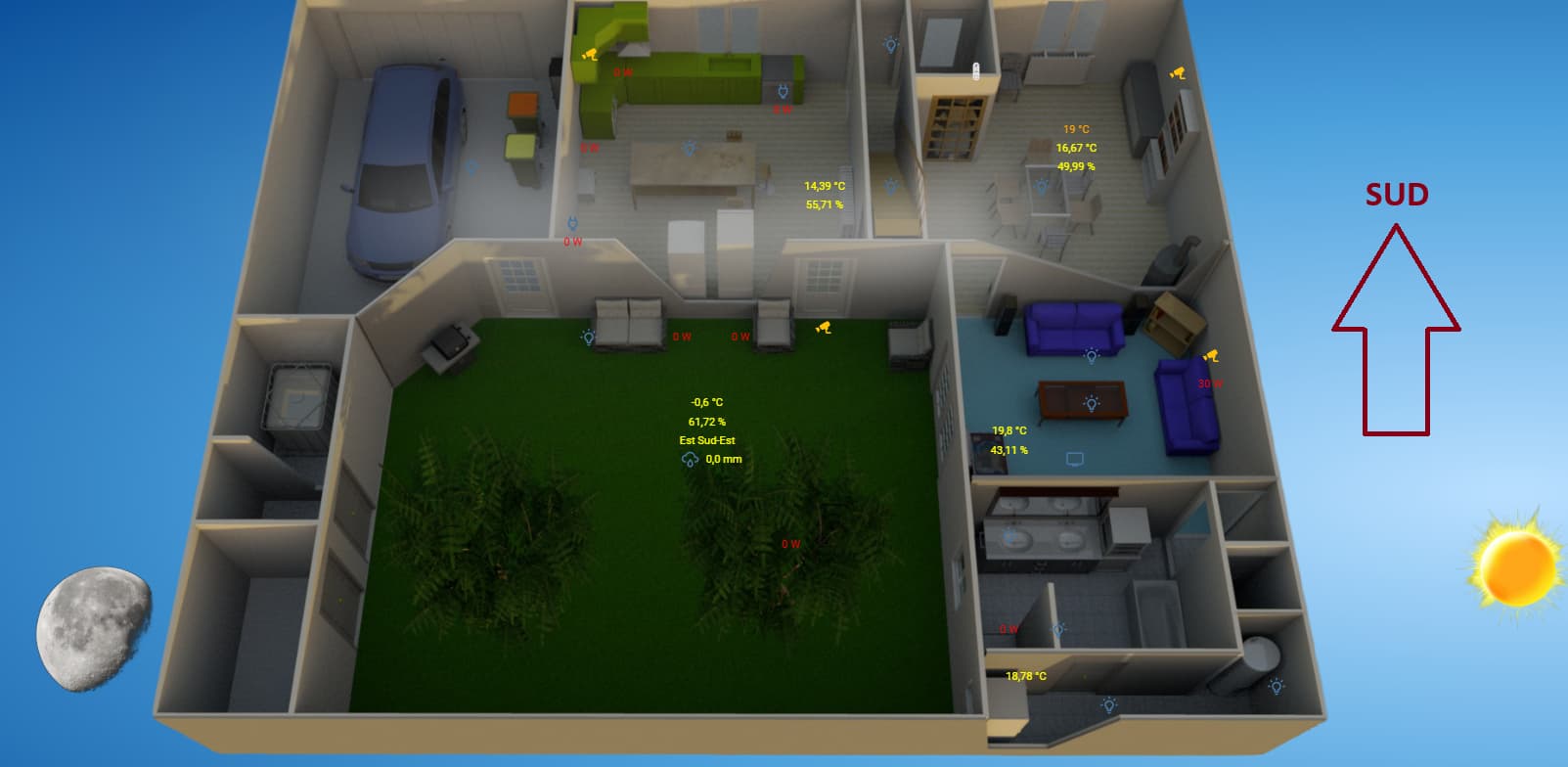

Rebonjour,
Est ce que les state-icon fonctionnent ?
Avant j’avais une icone en forme de main me permettant d’agir sur des entités, plus maintenant.
  - type: state-icon
    entity: input_boolean.virtuel_eclairage_garage
    style:
      top: 30%
      left: 83%
      width: 100%
    tap_action:
      action: toggle
type: picture-elements
view_layout:
  grid-area: main
card_mod:
  style: |-
    {%- from 'meteo.jinja' import sky -%}
    {{' '.join( sky().split())|replace('"',"")}}
image: /local/floorplan-2/fond transparent.png
elements:
  - type: custom:html-template-card
    title: ""
    ignore_line_breaks: true
    picture_elements_mode: true
    content: |-
      {%- from 'meteo.jinja' import generate_content -%}
        {{ generate_content('background','html')|replace('"','') }}
    card_mod:
      style: |-
          {{ generate_content('background','css')|replace('"','') }}
    style:
      top: 50%
      left: 50%
      width: 100%
      height: 100%
  - type: image
    image: /local/floorplan-2/fond-3.png
    entity: weather.forecast_maison
    style:
      top: 46%
      left: 50%
      width: 97%
  - type: image
    style:
      top: 46%
      left: 50%
      width: 97%
    state_image:
      "on": /local/floorplan-2/input_boolean.virtuel_eclairage_garage.png
      "off": /local/floorplan-2/fond transparent.png
  - type: image
    entity: input_boolean.virtuel_eclairage_escalier_rdc
    style:
      top: 46%
      left: 50%
      width: 97%
    state_image:
      "on": /local/floorplan-2/input_boolean.virtuel_eclairage_escalier_rdc.png
  - type: image
    entity: switch.bp_relais_eclairage_salon
    style:
      top: 46%
      left: 50%
      width: 97%
    state_image:
      "on": /local/floorplan-2/switch.bp_relais_eclairage_salon.png
  - type: image
    entity: switch.bp_relais_eclairage_sam
    style:
      top: 46%
      left: 50%
      width: 97%
    state_image:
      "on": /local/floorplan-2/switch.bp_relais_eclairage_sam.png
  - type: image
    entity: switch.bp_relais_eclairage_couloir_escalier
    style:
      top: 46%
      left: 50%
      width: 97%
    state_image:
      "on": /local/floorplan-2/switch.bp_relais_eclairage_couloir_escalier.png
  - type: image
    entity: input_boolean.virtuel_eclairage_cuisine
    style:
      top: 46%
      left: 50%
      width: 97%
    state_image:
      "on": /local/floorplan-2/input_boolean.virtuel_eclairage_cuisine.png
  - type: image
    entity: switch.prise_4_tv_co_zb
    style:
      top: 46%
      left: 50%
      width: 97%
    state_image:
      "on": /local/floorplan-2/switch.prise_4_tv_co_zb.png
    tap_action:
      action: toggle
  - type: image
    entity: light.lumiere_couloir_wc
    style:
      top: 46%
      left: 50%
      width: 97%
    state_image:
      "on": /local/floorplan-2/switch.bp_3_boutons_salle_de_bain_left.png
  - type: image
    entity: switch.bp_3_boutons_salle_de_bain_center
    style:
      top: 46%
      left: 50%
      width: 97%
    state_image:
      "on": /local/floorplan-2/switch.bp_3_boutons_salle_de_bain_center.png
  - type: image
    entity: switch.bp_3_boutons_salle_de_bain_right
    style:
      top: 46%
      left: 50%
      width: 97%
    state_image:
      "on": /local/floorplan-2/switch.bp_3_boutons_salle_de_bain_right.png
  - type: image
    entity: switch.relais_eclairage_exterieur_tableau
    style:
      top: 46%
      left: 50%
      width: 97%
    state_image:
      "on": /local/floorplan-2/switch.relais_eclairage_exterieur_tableau.png
  - type: image
    entity: light.bp_relais_eclairage_buanderie
    style:
      top: 46%
      left: 50%
      width: 97%
    state_image:
      "on": /local/floorplan-2/input_boolean.virtuel_eclairage_buanderie.png
  - type: image
    entity: input_boolean.virtuel_eclairage_wc
    style:
      top: 46%
      left: 50%
      width: 97%
    state_image:
      "on": /local/floorplan-2/input_boolean.virtuel_eclairage_wc.png
  - type: image
    entity: light.prise_20_salon_spot
    style:
      top: 46%
      left: 50%
      width: 97%
    state_image:
      "on": /local/floorplan-2/input_boolean.virtuel_eclairage_salon_spot.png
  - type: image
    entity: input_boolean.virtuel_eclairage_salon_flipper
    style:
      top: 46%
      left: 50%
      width: 97%
    state_image:
      "on": /local/floorplan-2/input_boolean.virtuel_eclairage_salon_flipper.png
  - type: state-icon
    style:
      top: 30%
      left: 83%
      width: 100%
    tap_action:
      action: toggle
  - type: state-icon
    style:
      top: 32%
      left: 109%
      width: 100%
    tap_action:
      action: toggle
  - type: state-icon
    style:
      top: 55%
      left: 121%
      width: 100%
    tap_action:
      action: toggle
  - type: state-icon
    style:
      top: 30%
      left: 118%
      width: 100%
    tap_action:
      action: toggle
  - type: state-icon
    style:
      top: 14%
      left: 108%
      width: 100%
    tap_action:
      action: toggle
  - type: state-icon
    style:
      top: 26%
      left: 96%
      width: 100%
    tap_action:
      action: toggle
  - type: state-icon
    style:
      top: 62%
      left: 119%
      width: 100%
    tap_action:
      action: toggle
  - type: state-icon
    style:
      top: 69%
      left: 131%
      width: 100%
    tap_action:
      action: toggle
    double_tap_action:
      action: more-info
  - type: state-icon
    style:
      top: 71%
      left: 118%
      width: 100%
    tap_action:
      action: toggle
  - type: state-icon
    style:
      top: 79%
      left: 121%
      width: 100%
    tap_action:
      action: toggle
  - type: state-icon
    style:
      top: 40%
      left: 90%
      width: 100%
    tap_action:
      action: toggle
  - type: state-icon
    style:
      top: 91%
      left: 125%
      width: 100%
    tap_action:
      action: toggle
  - type: state-icon
    style:
      top: 77%
      left: 131%
      width: 100%
    tap_action:
      action: toggle
  - type: state-icon
    style:
      top: 42%
      left: 120%
      width: 100%
    tap_action:
      action: toggle
  - type: state-icon
    style:
      top: 61%
      left: 115%
      width: 100%
    tap_action:
      action: toggle
  - type: state-label
    entity: sensor.bresser_station_meteo_bresser_temperature_ressentie
    style:
      left: 48%
      top: 47%
      color: yellow
  - type: state-label
    entity: sensor.tdegc_h_jardin_humidity
    style:
      left: 48%
      top: 49%
      color: yellow
  - type: state-label
    entity: sensor.prise_13_frigo_zb_power
    style:
      left: 50%
      top: 40%
      color: red
  - type: state-label
    entity: sensor.prise_5_congelateur_zb_power
    style:
      left: 46.5%
      top: 40%
      color: red
  - type: state-label
    entity: sensor.prise_6_lave_vaisselle_zb_power
    style:
      left: 52.5%
      top: 16%
      color: red
  - type: state-label
    entity: sensor.tdegc_h_cuisine_temperature
    style:
      left: 55%
      top: 24%
      color: yellow
  - type: state-label
    style:
      left: 55%
      top: 26%
      color: yellow
    entity: sensor.tdegc_h_cuisine_humidity
  - type: state-label
    entity: sensor.bresser_vent_direction_fr
    style:
      left: 48%
      top: 51%
      color: yellow
  - type: state-label
    entity: sensor.bresser_station_meteo_bresser_precipitations_journalieres
    style:
      left: 49%
      top: 53%
      color: yellow
  - type: state-icon
    tap_action:
      action: more-info
    style:
      left: 47%
      top: 53%
      color: yellow
  - type: state-label
    entity: sensor.prise_7_micro_onde_zb_power
    style:
      left: 40%
      top: 30%
      color: red
  - type: state-label
    entity: sensor.prise_1_hotte_aspirante_zb_power
    style:
      left: 43%
      top: 12%
      color: red
  - type: state-label
    entity: sensor.tdegc_h_salle_a_manger_temperature
    style:
      left: 70%
      top: 20%
      color: yellow
  - type: state-label
    entity: sensor.tdegc_h_salle_a_manger_humidity
    style:
      left: 70%
      top: 22%
      color: yellow
  - type: state-label
    style:
      left: 66%
      top: 50%
      color: yellow
    entity: sensor.tdegc_h_salon_temperature
  - type: state-label
    entity: sensor.tdegc_h_salon_humidity
    style:
      left: 66%
      top: 52%
      color: yellow
  - type: state-label
    entity: sensor.netatmo_temperature_consigne
    style:
      left: 70%
      top: 18%
      color: orange
  - type: state-label
    entity: sensor.prise_10_box_co_power
    style:
      left: 78%
      top: 45%
      color: red
  - type: state-label
    entity: sensor.prise_4_tv_co_zb_power
    style:
      left: 72%
      top: 62%
      color: red
  - type: state-label
    entity: sensor.tore_chauffe_eau_power_a
    style:
      left: 83%
      top: 89%
      color: red
  - type: state-label
    entity: sensor.tore_four_power_a
    style:
      left: 41%
      top: 20%
      color: red
  - type: state-label
    entity: sensor.prise_11_seche_serviette_zb_power
    style:
      left: 66%
      top: 71%
      color: red
  - type: state-label
    entity: sensor.tdegc_h_salle_de_bain_temperature
    style:
      left: 67%
      top: 76%
      color: yellow
  - type: state-label
    entity: sensor.planning_du_jour
    style:
      left: 83%
      top: 91%
      color: orange
  - type: state-icon
    entity: camera.cuisine
    icon: mdi:cctv
    style:
      left: 41%
      top: 10%
  - type: state-icon
    entity: camera.jardin
    camera_view: live
    fit_mode: fill
    aspect_ratio: 200%
    icon: mdi:cctv
    style:
      left: 61%

Tous les elements d’une picture-elements fonctionnent.
Par contre, attention à son niveau de placement : les éléments qui sont cliquables doivent être mis au premier plan… Sinon ils sont cachés par les autres.
Donc typiquement APRES le foreground
Bien vu, je ne connaissais pas le concept foreground & Co.
Merci :wink:

Je me permet de répondre, ce que tu cherches doit se trouver là dans le rotation.jinja
cdt
impecccable, tout est déjà prévu :wink:
Oui, c’est prévu, sur la première ligne de rotation.yaml :
{%- set house_angle_deg = 25 -%}
Bon, ben @freetronic est déjà sur la brêche ^^

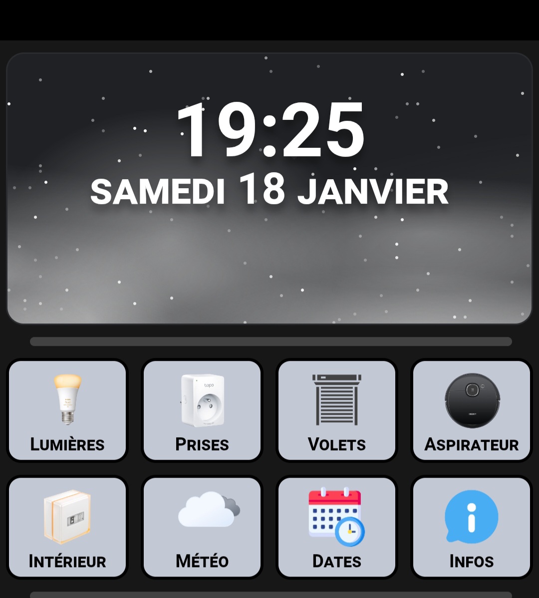

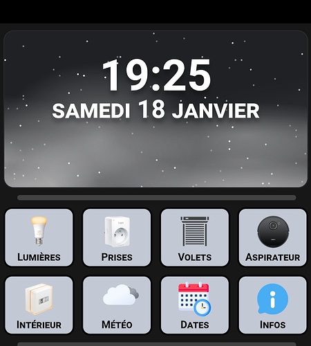

Ajout de l’heure avec ici meteo en brouillard
Exemple hier soir : Watch unnamed | Streamable
L’éditeur, c’est ultra limité. ça ca pour avoir une vague idée, mais c’est un tel empilement de fenêtres que c’est pas là dessus qu’il faut se baser pour le rendu définitif.
