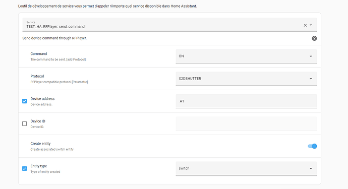

Alors il y a du beaucoup mieux. J’arrive a commander mes volets via le service mais dès que je mets créer les entité j’ai ce message :
J’ai ça dans les logs :
2023-09-24 10:35:12.083 DEBUG (MainThread) [custom_components.rfplayer] Rfplayer send command for {'command': 'ON', 'automatic_add': True, 'entity_type': 'switch', 'protocol': 'X2DSHUTTER', 'device_address': 'A1'}
2023-09-24 10:35:12.083 DEBUG (MainThread) [custom_components.rfplayer.rflib.rfpprotocol] writing data: b'ZIA++ON A1 X2DSHUTTER \n\r'
2023-09-24 10:35:12.084 DEBUG (MainThread) [custom_components.rfplayer] Add device for {'command': 'ON', 'automatic_add': True, 'entity_type': 'switch', 'protocol': 'X2DSHUTTER', 'device_address': 'A1'}
2023-09-24 10:35:12.086 ERROR (MainThread) [homeassistant.helpers.script.websocket_api_script] websocket_api script: Error executing script. Unexpected error for call_service at pos 1: 'dict' object is not callable
  File "/usr/src/homeassistant/homeassistant/helpers/script.py", line 468, in _async_step
    await getattr(self, handler)()
  File "/usr/src/homeassistant/homeassistant/helpers/script.py", line 704, in _async_call_service_step
    response_data = await self._async_run_long_action(
  File "/usr/src/homeassistant/homeassistant/helpers/script.py", line 666, in _async_run_long_action
    return long_task.result()
  File "/usr/src/homeassistant/homeassistant/core.py", line 1969, in async_call
    response_data = await coro
  File "/usr/src/homeassistant/homeassistant/core.py", line 2006, in _execute_service
    return await target(service_call)
  File "/config/custom_components/rfplayer/__init__.py", line 136, in async_send_command
    await hass.data[DOMAIN][DATA_DEVICE_REGISTER][EVENT_KEY_COMMAND](device)
TypeError: 'dict' object is not callable

Et si tu choisis Cover pour Entity type, cela serait surement mieux ?
J’ai essayé aussi et idem
Il ne faut pas oublier de redémarré HA, le mieux redémarré complétement le RPI4 …
Yep après redémarrage c’est ok.
