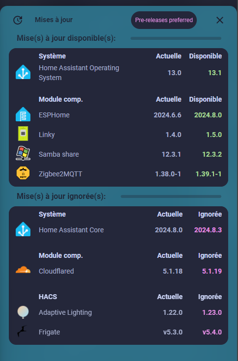

Maj de HACS version 1.34, vers la version 2.0. procédure d'installation?
Finalement j’ai quand même fait la carte des updates disponibles, ça donne ça dans un pop-up bubble-card:
sensor

pop-up
  ### ================================================================== UPDATES
  - type: vertical-stack
      - type: custom:bubble-card
        card_type: pop-up
        hash: "#update"
        name: Mises à jour
        icon: mdi:update
        close_on_click: false
        sub_button:
          - entity: switch.hacs_pre_release
            show_name: false
            icon: ''
            show_state: true
            show_last_changed: false
            show_attribute: false
            tap_action:
              action: toggle
            show_icon: false
            show_background: true
      # ------------------------------------------ cards
      - type: conditional
        conditions:
          - condition: state
            entity: binary_sensor.tplt_available_updates
            state: 'on'
        card:
              card_type: separator
              name: "Mise(s) à jour disponible(s):"
              <<: &separator
                styles: |-
                  ha-card { color: var(--primary-background-color); }
                  .bubble-line {
                    background: var(--primary-background-color);
                    opacity: 0.2;
            - !include ../cards/card_update_available.yaml
      - type: conditional
        conditions:
          - condition: state
            entity: binary_sensor.tplt_skipped_updates
            state: 'on'
        card:
              name: "Mise(s) à jour ignorée(s):"
              <<: *separator
            - !include ../cards/card_update_skipped.yaml
              modify: '''<img src="'' + x + ''"style="height:30px;width:30px">'''
          - <<: &col2
              data: friendly_name
              align: left
              modify: |-
                x = x.replace('Update', '');
                x;
          - <<: &col3
              data: installed_version
              align: right
          - <<: &col4
              data: skipped_version
              align: right
        css: &css
          thead th: 'color: var(--text);'
          tbody tr: 'background-color: transparent !important;'
          tbody tr td:nth-child(1): 'width: 32px;'
          tbody tr td:nth-child(3): 'width: 64px; font-weight: bold;'
          tbody tr td:nth-child(4): 'width: 64px; color: var(--nova-color); font-weight: bold;'
  # ===================================================================== ADD-ON UPDATES
  - type: conditional
    conditions:
      - condition: state
        entity: sensor.tplt_skipped_updates_addon
        state_not: '0'
    card:
      type: custom:auto-entities
      filter:
        include: *include
        exclude:
          - entity_id: update.*
            attributes:
              skipped_version: null
            attributes:
              device_class: firmware
            attributes:
              supported_features: 23
          - entity_id: update.home_assistant_core_update
          - entity_id: update.home_assistant_operating_system_update
          - entity_id: update.home_assistant_supervisor_update
      card:
        <<: *card
        columns:
          - <<: *col1
          - <<: *col2
          - <<: *col3
          - <<: *col4
        css: *css
  # ======================================================================= HACS UPDATES
  - type: conditional
    conditions:
      - condition: state
        entity: sensor.tplt_skipped_updates_hacs
        state_not: '0'
    card:
      filter:
        include: *include
        exclude:
            attributes:
            attributes:
            attributes:
              supported_features: 25
      card:
        <<: *card
        columns:
          - <<: *col1
          - <<: *col2
            modify: |-
              x = x.replace('update', '');
              x;
          - <<: *col3
          - <<: *col4
        css: *css
