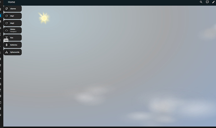

Refonte du menu, j'en ai eu vite assez de devoir passer par 3 page pour aller sur la 3e page
B1
Tout est désormais fonctionnel avec en bonus la météo
B2
début des tests d'amélioration graphique des menus
1
Si vous voulez des infos, n'hésitez pas à demander.
cdt

          styles: |
            .bubble-button-card-container {
              box-shadow: none;
              border-radius: 15px !important;  # Ajustez la valeur ici
          icon: mdi:update
          auto_close: "5000"
          name: Mises à jour partie2
        - type: custom:auto-entities
            type: entities
            show_header_toggle: false
          filter:
            include:
              - domain: update
                template: >
                  {% set installed = state_attr(entity.entity_id,
                  'installed_version') %} {% set latest =
                  state_attr(entity.entity_id, 'latest_version') %} {{ installed
                  != latest }}
          show_empty: false
          card_param: entities
            - entity: update.zerotier_one_update
              type: custom:template-entity-row
              state: >
                {{ state_attr('update.zerotier_one_update', 'installed_version')
                }} ➜ {{ state_attr('update.zerotier_one_update',
                'latest_version') }}
                    {% if state_attr('update.zerotier_one_update', 'installed_version') != state_attr('update.zerotier_one_update', 'latest_version') %}
                      color: red !important;
                      color: inherit;
  - type: custom:mod-card
      left: 17.5%
      top: 45%
      height: 98%
      z-index: 5
        - type: custom:bubble-card
          card_type: pop-up
          hash: "#meteo"
          card_layout: normal
          width_desktop: 400px
          styles: |
              box-shadow: none;
          icon: mdi:weather-cloudy
          auto_close: "20000"
        - type: custom:stack-in-card
          mode: vertical
            - type: weather-forecast
              show_current: true
              show_forecast: true
              entity: weather.forecast_maison
              forecast_type: hourly
            - type: custom:swipe-card
              parameters:
                allowTouchMove: false
                effect: coverflow
                centeredSlides: true
                slidesPerView: auto
                spaceBetween: 8
                pagination:
                  type: progressbar
                navigation: null
                keyboard:
                  enabled: true
                  onlyInViewport: true
              navigation: null
                - type: iframe
                  url: >-
                    https://embed.windy.com/embed2.html?lat=50,2&lon=1&detailLat=50,2&detailLon=1&zoom=5&level=surface&overlay=rain&product=ecmwf&menu=&message=&marker=&calendar=24&pressure=&type=map&location=coordinates&detail=&metricWind=km%2Fh&metricTemp=%C2%B0C&radarRange=-1
                  aspect_ratio: 99%
                        filter: invert(0%);
                - type: iframe
                  url: >-
                    https://embed.windy.com/embed2.html?lat=50,2&lon=1&detailLat=50,2&detailLon=1&zoom=5&level=surface&overlay=temp&product=ecmwf&menu=&message=&marker=&calendar=24&pressure=&type=map&location=coordinates&detail=&metricWind=km%2Fh&metricTemp=%C2%B0C&radarRange=-1
                  aspect_ratio: 99%
                        filter: invert(0%);
                - type: iframe
                  url: >-
                    https://embed.windy.com/embed2.html?lat=50,2&lon=1&detailLat=50,2&detailLon=1&zoom=5&level=surface&overlay=wind&product=ecmwf&menu=&message=&marker=&calendar=24&pressure=&type=map&location=coordinates&detail=&metricWind=km%2Fh&metricTemp=%C2%B0C&radarRange=-1
                  aspect_ratio: 99%
                        filter: invert(0%);
              show_current: false
              show_forecast: true
              forecast_type: daily
      left: 17.5%
      top: 23.5%
      height: 55%
      z-index: 5
          card_type: pop-up
          hash: "#restrictions_eau"
          card_layout: normal
          styles: |
              box-shadow: none;
          icon: mdi:fountain
          auto_close: "5000"
            type: entities
          show_empty: false
            - entity: sensor.arrosage_des_pelouses_restrictions_berlaimont
            - entity: sensor.arrosage_des_jardins_potagers_restrictions_berlaimont
            - entity: sensor.lavage_des_vehicules_restrictions_berlaimont
            - entity: sensor.lavage_des_toitures_facades_restrictions_berlaimont
            - entity: >-
                sensor.vidange_et_remplissage_des_piscines_restrictions_berlaimont
            - entity: >-
                sensor.remplissage_vidange_des_plans_d_eau_restrictions_berlaimont
            - entity: sensor.restriction_specifique_restrictions_berlaimont
      left: 17.5%
      top: 31%
      height: 70%
      z-index: 5
          card_type: pop-up
          hash: "#batteries"
          card_layout: normal
          styles: |
              box-shadow: none;
          icon: mdi:battery
          auto_close: "10000"
        - type: custom:battery-state-card
          sort: state
            - sensor.temp_labo_battery
      left: 17.5%
      top: 18.5%
      height: 45%
      z-index: 5
          card_type: pop-up
          hash: "#ephemeride"
          card_layout: normal
          styles: |
              box-shadow: none;
          icon: mdi:church
          auto_close: "5000"
            type: entities
            - entity: sensor.jour_anniversaire
            - entity: sensor.demain_anniversaire
            - entity: sensor.saint_du_jour
            - entity: sensor.saint_de_demain
            - entity: sensor.jour_ferie
      left: 4.25%
      top: 4%
      width: 8.5%
      height: 5%
    card_type: button
    button_type: name
    icon: mdi:security
    button_action:
        navigation_path: "#alarme"
    styles: |
        box-shadow: none;
    scrolling_effect: false
      left: 4.25%
      top: 10%
      width: 8.5%
      height: 5%
    card_type: button
    button_type: name
    icon: mdi:update
    button_action:
        navigation_path: "#update1"
    styles: |
        box-shadow: none;
      left: 4.25%
      top: 16%
      width: 8.5%
      height: 5%
    card_type: button
    button_type: name
    icon: mdi:update
    button_action:
        navigation_path: "#update2"
    styles: |
        box-shadow: none;
      left: 4.25%
      top: 22%
      width: 8.5%
      height: 5%
    card_type: button
    button_type: state
    styles: |
        box-shadow: none;
    force_icon: true
    show_last_changed: false
    show_attribute: false
    button_action:
        navigation_path: "#meteo"
      left: 4.25%
      top: 28%
      width: 8.5%
      height: 5%
    card_type: button
    button_type: name
    icon: mdi:fountain
    button_action:
        navigation_path: "#restrictions_eau"
    styles: |
        box-shadow: none;
      left: 4.25%
      top: 34%
      width: 8.5%
      height: 5%
    card_type: button
    button_type: name
    icon: mdi:battery
    button_action:
        navigation_path: "#batteries"
    styles: |
        box-shadow: none;
      left: 4.25%
      top: 40%
      width: 8.5%
      height: 5%
    card_type: button
    button_type: name
    icon: mdi:church
    button_action:
        navigation_path: "#ephemeride"
    styles: |
        box-shadow: none;
voilà :slight_smile:
cdt
Merci, je vais potasser ça cette nuit :wink:
c’est pas très compliqué au final :wink:
