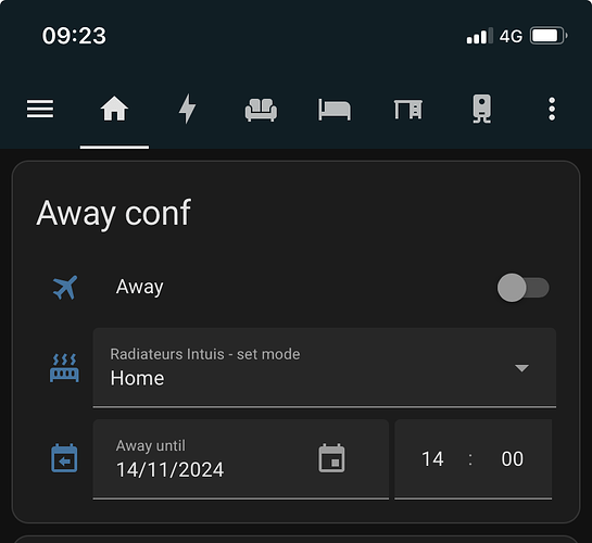

Le voici:
[{"id":"087481a66b64a77c","type":"group","z":"a2f12235762ec828","name":"Passer une commande manuelle","style":{"label":true},"nodes":["e16b1440f9976fc9","40443890d8c3a7df","5a3259d752e1efa7","2ae8f33d83a59f91","f1b88b07dab52fdf","e0f695c83e952ca1","f81677b3ca6fc19f","e4342b0432a85d74","96c2c3ef618edd31","1267ba1a01763541","be6618e22ddd3bef","4a1da8ae2657e4f7","481383c692b73536"],"x":174,"y":-1,"w":2012,"h":202},{"id":"e16b1440f9976fc9","type":"debug","z":"a2f12235762ec828","g":"087481a66b64a77c","name":"contrôle retour","active":false,"tosidebar":true,"console":false,"tostatus":false,"complete":"payload","targetType":"msg","statusVal":"","statusType":"auto","x":2060,"y":100,"wires":[]},{"id":"40443890d8c3a7df","type":"debug","z":"a2f12235762ec828","g":"087481a66b64a77c","name":"contrôle requête","active":false,"tosidebar":true,"console":false,"tostatus":false,"complete":"payload","targetType":"msg","statusVal":"","statusType":"auto","x":1860,"y":40,"wires":[]},{"id":"5a3259d752e1efa7","type":"http request","z":"a2f12235762ec828","g":"087481a66b64a77c","name":"Intuis setstate","method":"POST","ret":"obj","paytoqs":"ignore","url":"https://app.muller-intuitiv.net/api/setthermmode","tls":"","persist":false,"proxy":"","insecureHTTPParser":false,"authType":"","senderr":false,"headers":[{"keyType":"Authorization","keyValue":"","valueType":"msg","valueValue":"token"},{"keyType":"Content-Type","keyValue":"","valueType":"other","valueValue":"application/json"}],"x":1860,"y":100,"wires":[["e16b1440f9976fc9"]]},{"id":"2ae8f33d83a59f91","type":"change","z":"a2f12235762ec828","g":"087481a66b64a77c","name":"Set home mode","rules":[{"t":"set","p":"payload","pt":"msg","to":"{\t  \"app_identifier\": \"app_muller\",\t  \"home_id\": $globalContext(\"home_id\"),\t  \"mode\": $globalContext(\"mode_setpoint\"),\t  \"endtime\": $globalContext(\"due_date_setpoint\")\t}","tot":"jsonata"}],"action":"","property":"","from":"","to":"","reg":false,"x":1660,"y":100,"wires":[["40443890d8c3a7df","5a3259d752e1efa7"]]},{"id":"f1b88b07dab52fdf","type":"change","z":"a2f12235762ec828","g":"087481a66b64a77c","name":"","rules":[{"t":"set","p":"token","pt":"msg","to":"\"Bearer \" & $globalContext(\"AccessToken\")\t","tot":"jsonata"}],"action":"","property":"","from":"","to":"","reg":false,"x":1450,"y":100,"wires":[["2ae8f33d83a59f91"]]},{"id":"e0f695c83e952ca1","type":"server-state-changed","z":"a2f12235762ec828","g":"087481a66b64a77c","name":"Home mode selected","server":"3b9eb627.f4aeda","version":6,"outputs":1,"exposeAsEntityConfig":"","entities":{"entity":["input_select.radiateurs_intuis_set_mode"],"substring":[],"regex":[]},"outputInitially":false,"stateType":"str","ifState":"","ifStateType":"str","ifStateOperator":"is","outputOnlyOnStateChange":true,"for":"0","forType":"num","forUnits":"minutes","ignorePrevStateNull":false,"ignorePrevStateUnknown":false,"ignorePrevStateUnavailable":false,"ignoreCurrentStateUnknown":false,"ignoreCurrentStateUnavailable":false,"outputProperties":[{"property":"payload","propertyType":"msg","value":"","valueType":"entityState"},{"property":"data","propertyType":"msg","value":"","valueType":"eventData"},{"property":"topic","propertyType":"msg","value":"","valueType":"triggerId"}],"x":300,"y":100,"wires":[["481383c692b73536"]]},{"id":"f81677b3ca6fc19f","type":"change","z":"a2f12235762ec828","g":"087481a66b64a77c","name":"","rules":[{"t":"set","p":"due_date_setpoint","pt":"global","to":"payload","tot":"msg"}],"action":"","property":"","from":"","to":"","reg":false,"x":1010,"y":160,"wires":[["96c2c3ef618edd31"]]},{"id":"e4342b0432a85d74","type":"change","z":"a2f12235762ec828","g":"087481a66b64a77c","name":"","rules":[{"t":"set","p":"mode_setpoint","pt":"global","to":"payload","tot":"msg"}],"action":"","property":"","from":"","to":"","reg":false,"x":1020,"y":100,"wires":[["96c2c3ef618edd31"]]},{"id":"96c2c3ef618edd31","type":"delay","z":"a2f12235762ec828","g":"087481a66b64a77c","name":"","pauseType":"delay","timeout":"100","timeoutUnits":"milliseconds","rate":"1","nbRateUnits":"1","rateUnits":"second","randomFirst":"1","randomLast":"5","randomUnits":"seconds","drop":true,"allowrate":false,"outputs":1,"x":1250,"y":100,"wires":[["f1b88b07dab52fdf"]]},{"id":"1267ba1a01763541","type":"server-state-changed","z":"a2f12235762ec828","g":"087481a66b64a77c","name":"Due date selected","server":"3b9eb627.f4aeda","version":6,"outputs":1,"exposeAsEntityConfig":"","entities":{"entity":["input_datetime.away_until_date"],"substring":[],"regex":[]},"outputInitially":false,"stateType":"str","ifState":"","ifStateType":"str","ifStateOperator":"is","outputOnlyOnStateChange":true,"for":"0","forType":"num","forUnits":"minutes","ignorePrevStateNull":false,"ignorePrevStateUnknown":false,"ignorePrevStateUnavailable":false,"ignoreCurrentStateUnknown":false,"ignoreCurrentStateUnavailable":false,"outputProperties":[{"property":"payload","propertyType":"msg","value":"","valueType":"entityState"}],"x":290,"y":160,"wires":[["4a1da8ae2657e4f7"]]},{"id":"be6618e22ddd3bef","type":"change","z":"a2f12235762ec828","g":"087481a66b64a77c","name":"","rules":[{"t":"set","p":"payload","pt":"msg","to":"$round($number($toMillis(payload))/1000,0)","tot":"jsonata"}],"action":"","property":"","from":"","to":"","reg":false,"x":750,"y":160,"wires":[["f81677b3ca6fc19f"]]},{"id":"4a1da8ae2657e4f7","type":"moment","z":"a2f12235762ec828","g":"087481a66b64a77c","name":"","topic":"","input":"payload","inputType":"msg","inTz":"Europe/Paris","adjAmount":0,"adjType":"days","adjDir":"add","format":"","locale":"C","output":"payload","outputType":"msg","outTz":"Europe/Paris","x":520,"y":160,"wires":[["be6618e22ddd3bef"]]},{"id":"481383c692b73536","type":"function","z":"a2f12235762ec828","g":"087481a66b64a77c","name":"Transco home mode","func":"if(msg.payload == \"Home\")\n{\n    msg.payload = \"schedule\";\n}\nelse if (msg.payload == \"Away\")\n{\n    msg.payload = \"away\";\n}\nelse if ( msg.payload == \"Hors Gel\")\n{\n    msg.payload = \"hg\";\n}\nreturn msg;","outputs":1,"timeout":0,"noerr":0,"initialize":"","finalize":"","libs":[],"x":760,"y":100,"wires":[["e4342b0432a85d74"]]},{"id":"3b9eb627.f4aeda","type":"server","name":"Home Assistant","addon":true}]
Pour le faire fonctionner, il faut créer deux entrées dans HA comme l’explique @BeaverBeliever
  • 1 liste déroulante avec les choix suivants: « Away », « Home », « Hors gel ». ( respecter la casse car il y a une transco faite dans nodered pour transformer ce string, eg. Home → schedule…, Away → away, Hors gel → hg)
  • 1 entrée date
Il faudra changer le nom des entités dans les 2 noeuds input et le homeid.
J’ai aussi créé un déclencheur Away ( booléen ) et deux automatismes par dessus qui sélectionne la valeur de la liste déroulante à Away ou Home lorsqu’il est activé ou désactivé.
Voici ce que ça donne dans mon Dashboard:
Les automatisations:
