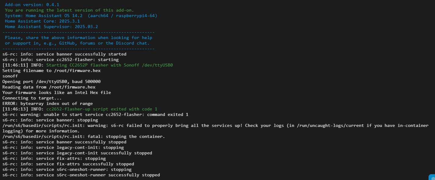

Je ne parviens pas à faire la mise à jour de ma clef et je ne sais pas trop comment faire pour y parvenir puisque j’aimerais pouvoir configurer correctement zigbee2MQTT.
Voici les logs
Au format text (pour le copier coller)
Add-on version: 0.4.1
You are running the latest version of this add-on.
System: Home Assistant OS 14.2 (aarch64 / raspberrypi4-64)
Home Assistant Core: 2025.3.1
Home Assistant Supervisor: 2025.03.2
Please, share the above information when looking for help
or support in, e.g., GitHub, forums or the Discord chat.
s6-rc: info: service banner successfully started
s6-rc: info: service cc2652-flasher: starting
[11:46:11] INFO: Starting CC2652P flasher with Sonoff /dev/ttyUSB0
Setting filename to /root/firmware.hex
sonoff
Opening port /dev/ttyUSB0, baud 500000
Reading data from /root/firmware.hex
Your firmware looks like an Intel Hex file
Connecting to target...
ERROR: bytearray index out of range
[11:46:13] INFO: cc2652-flasher-up script exited with code 1
s6-rc: warning: unable to start service cc2652-flasher: command exited 1
s6-rc: info: service banner: stopping
/run/s6/basedir/scripts/rc.init: warning: s6-rc failed to properly bring all the services up! Check your logs (in /run/uncaught-logs/current if you have in-container logging) for more information.
/run/s6/basedir/scripts/rc.init: fatal: stopping the container.
s6-rc: info: service banner successfully stopped
Il y a une chose qui me fait questionner la chose
Connecting to target…
Avez vous des idées ?
